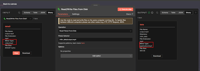

Hello,
After updating n8n version (1.122.4), the Read/Write Files from Disk node returns a different MIME type than in the previous versions.
In the previous version, an MP4 file written using the same node would later be read with the MIME type: video/mp4
After upgrading, reading the exact same MP4 file now returns: application/mp4
To Reproduce
  1. Create a workflow that writes a .mp4 file using the Read/Write Files from Disk node.
  2. Read the same .mp4 file using the same node.
  3. Inspect the binary metadata returned.
Workflow to Reproduce:
Expected behavior
The node should preserve or correctly detect the MIME type and continue to return: video/mp4 instead of: application/mp4
Github Issue
This is still exists with n8n v 1.122.4
