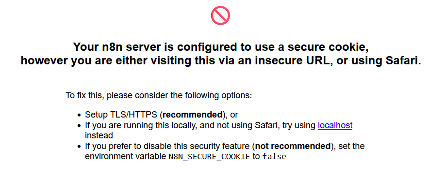

how are you accessing it? you use localhost right? and not use safari
what you are seeing here is because of the cookie policy, which you can turn it off by setting this env variables to false
N8N_SECURE_COOKIE=false
thanks @fahmiiireza i googled it lol, so il make a cronjob to start n8n automatically when linux starts and as the exports isnt persistent il do this in script
