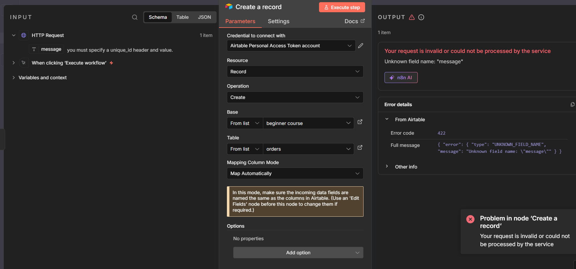

Level one. 2. Inserting data into Airtable. Problem
I tried to complete Nathan’s workflow. When I was done, I clicked on Execute step and received an error message.
What did I do wrong?
Problem in node ‘Create a record‘
Your request is invalid or could not be processed by the service
From Airtable
Error code
422
Full message
{ "error": { "type": "UNKNOWN_FIELD_NAME", "message": "Unknown field name: \"message\"" } }

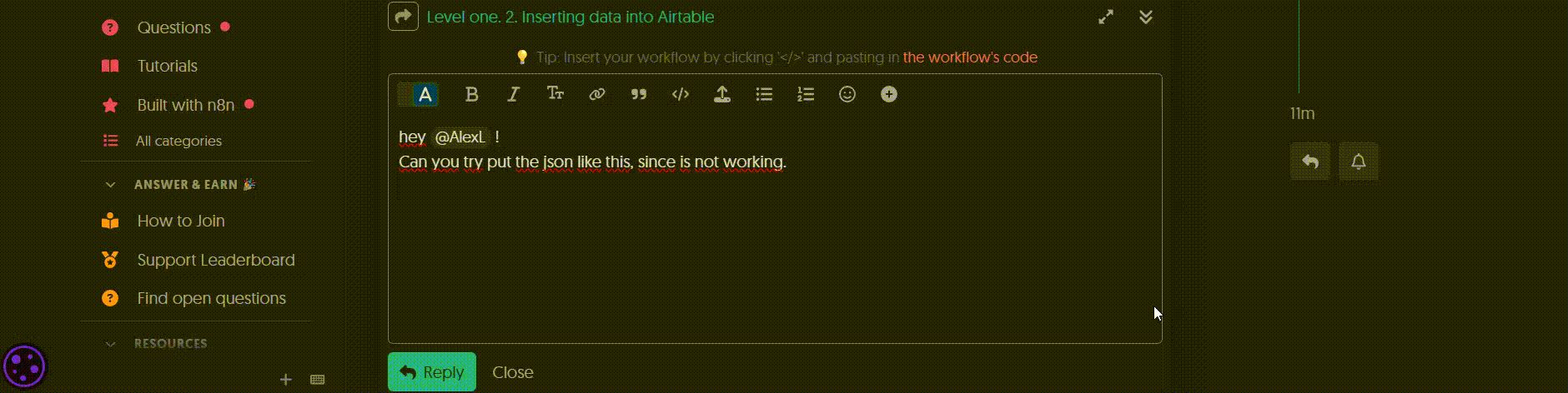

hey @AlexL !
Can you try put the json like this, since is not working.
0nepqcmi
here your json
but keeping the M markdown format an not A.
Or maybe images direclty with the error in workflow.

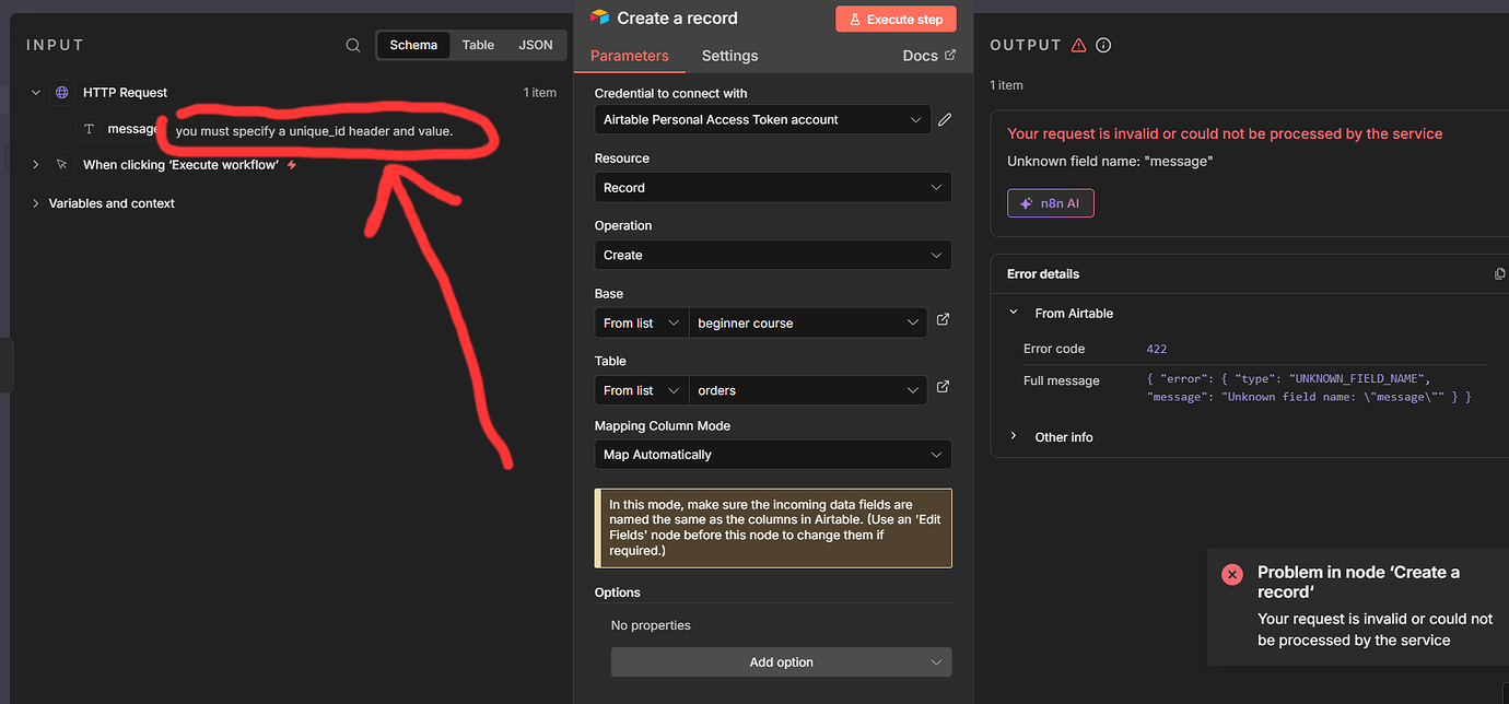

Your problem is in the HTTP node, please put image with the HTTP node (and try with Executions tab , so we can see the data).
ohh I see. I specified a unique_id and it works. thank you very much for the help!
