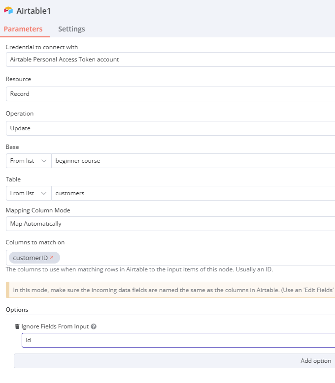

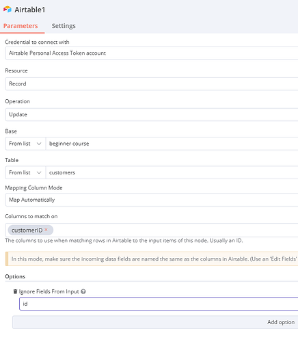

The error says, essentially, that the target table doesn’t have a field named id.
Try adding it to the ignore fields list.
If this resolves your issue, please mark this post as a :white_check_mark: Solution.
Great! Thank you for guiding me with this revelation about putting the ‘id’ into the ignore fields list. I re-examined the “output data form” option of my previous Merge node and set it to “input 1”. This made the merge node onlyadditionally output two system fields “id” and “createTime”. Therefore, I only need to ignore “id” and “createTime” in the airTable2 node to make the node execute correctly.
