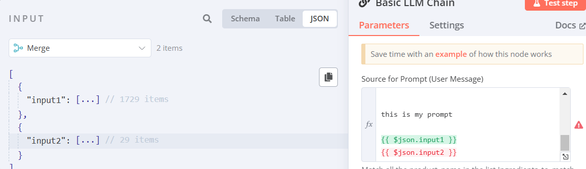

I’d like to combine 2 json snippets into 1 prompt, for which I’m pulling 2 separate lists of data from a db.
To combine both into one json, I’m using Merge+Append.
The issue is the input that I link as Input 2 is always empty when I Test the Merge node. On the Output section, if I use Json view I can see both lists appended, but if I switch to table view, the second column is always [undefined].
If I switch the order of the Inputs, it always happens to be the second.
Isn’t Merge supposed to wait for both Inputs? I CAN see both inputs on the left.

Merge - Append emits a list of objects that contains the items from input A, followed by more items from input B. That would not appear as a “second column” (or second attribute) of a single output object.
You might want Merge with “combine” instead.
Ok, then if I look to the LLM where the Merge is inputting, I still see that ‘input2’ object (second in the json created by the Merge) is invalid.
What I don’t understand is why I can see it if I expand on the left side, but the value dragged into the prompt is invalid. If I Test, it fails
I think you are missing how the data is structured at the top level. The array of things you see, is the whole-view of the list of (2) items. Each of those items runs the next node 1 time, so you are running the LLM step twice. If you want to map those together in a single object, Merge won’t do it. It wouldn’t be the most flexible approach, but you could use a Set - Edit Fields node, configured (toggle in Settings) to Run Once - giving you only one output object, and reference each of the incoming objects by its index. Then forward that single item on to the LLM.

Thanks, that worked
