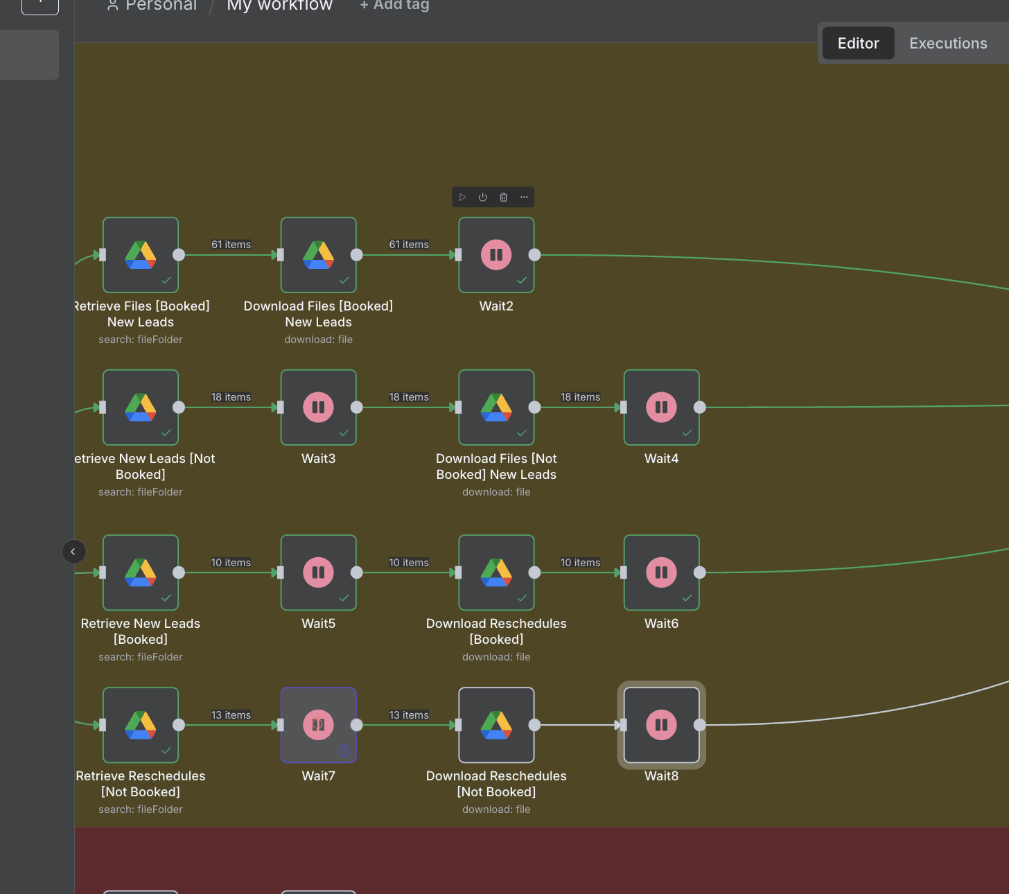

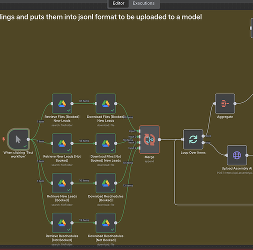

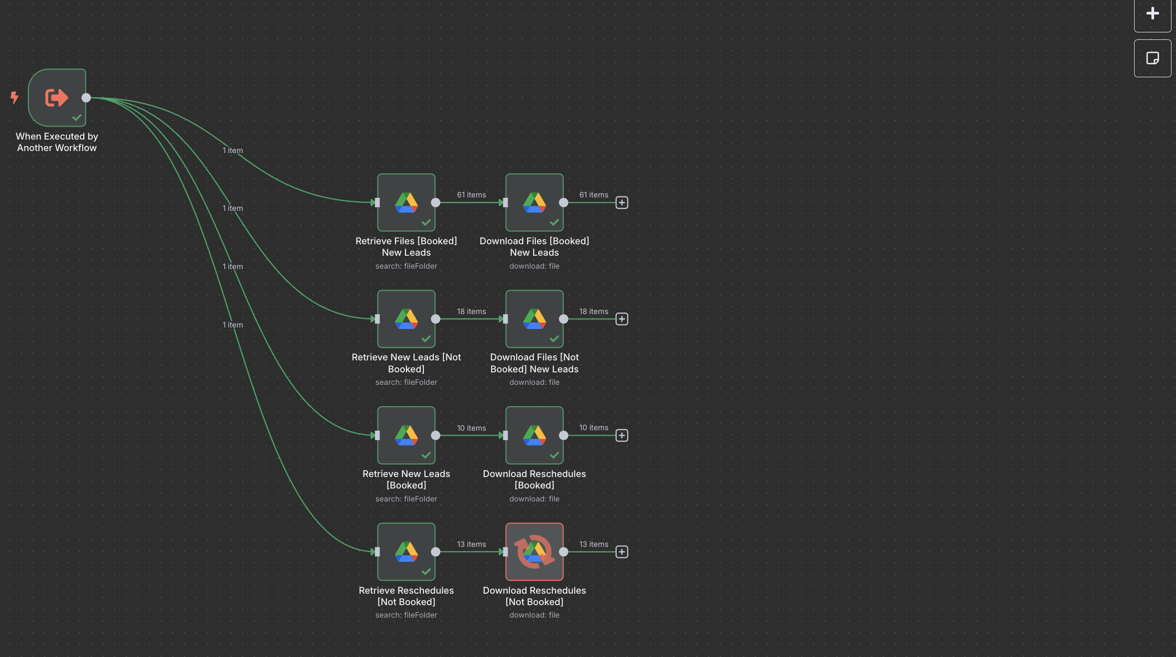

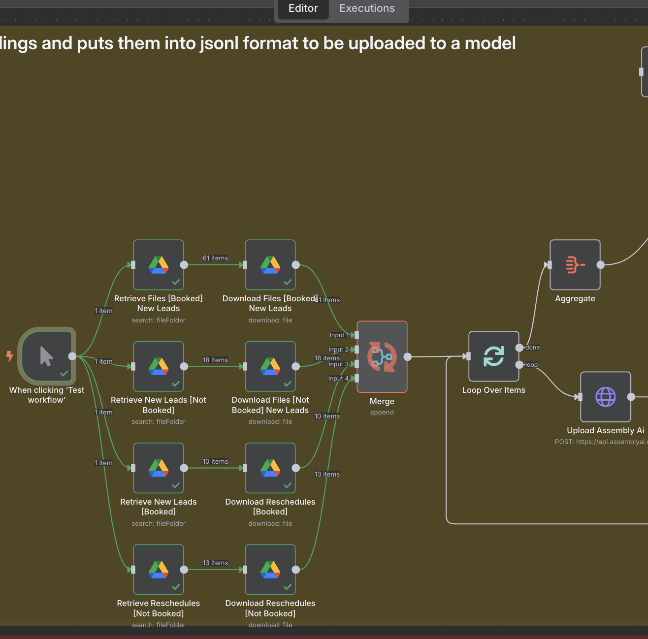

So I am trying to download files and upload them to assembly ai. However, I am running into issues right now. My merge node is just stuck it is constantly loading and never triggering the next node in my flow. Please check the screenshot. I wasn’t able to find a clear definite issue on why this is happening. Any tips or suggestions on how to fix this would be awesome!

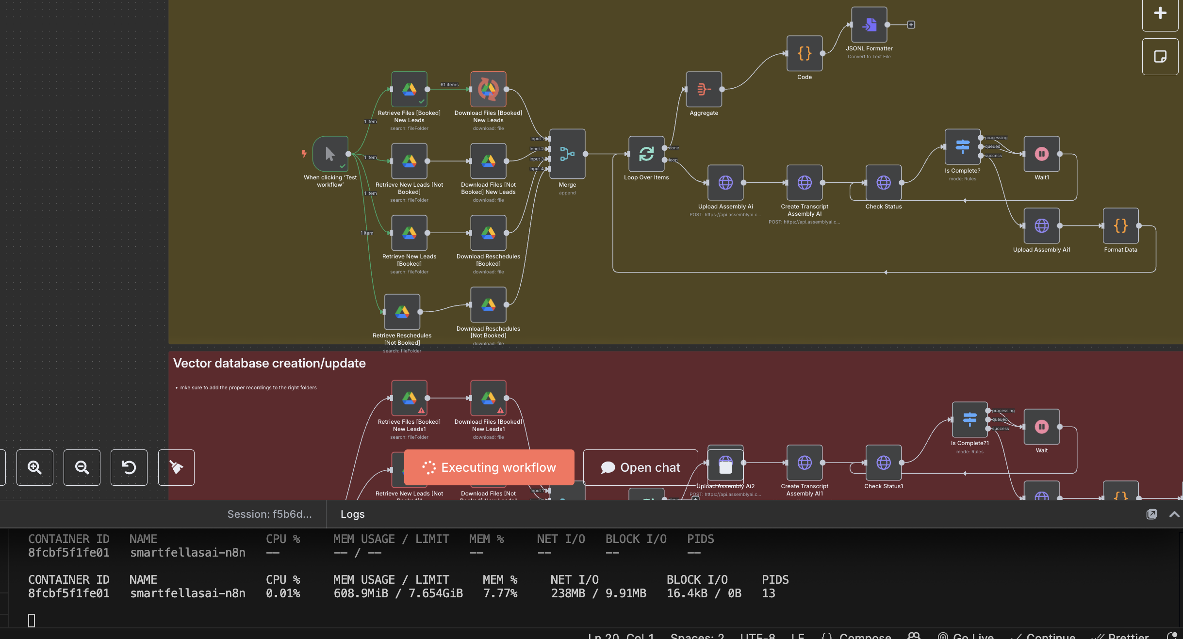

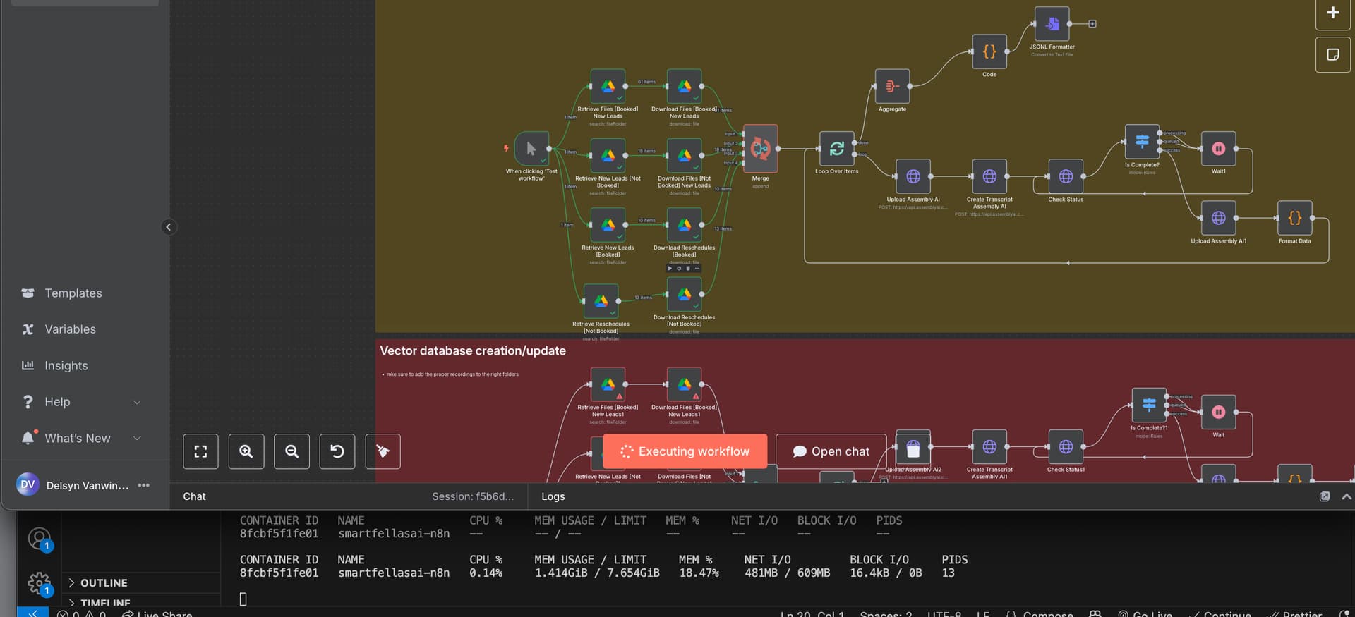

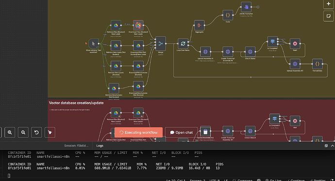

Are you using Docker or npm? Check the cpu/memory/disk usage, may be some of them are overloading
I am using Docker. I checked the cpu/memory/disk usage and it seems good to me. I’ll redo it and attach the screenshots. The first screenshot is it doing 61 files and the second will be when it’s stuck on the merge. It seems to be good to me, whats your thoughts? Thank you all for your help.

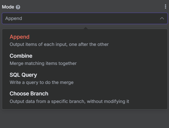

Stupid solution:
Try to use one-by-one merge mode, start with use combine first:D
Try replacing that part with a sub-workflow with them
Hm, that still didn’t work. it basically does the same thing. Whenever I connect two nodes instead of all 4 it works, (same thing in main workflow as well).

So it’s stopping at the fourth node. I guess I could do 2 subworkflows and add them together. I am still curious why it does this though? my disk I/O was relatively the same.
