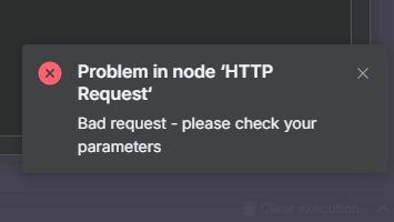

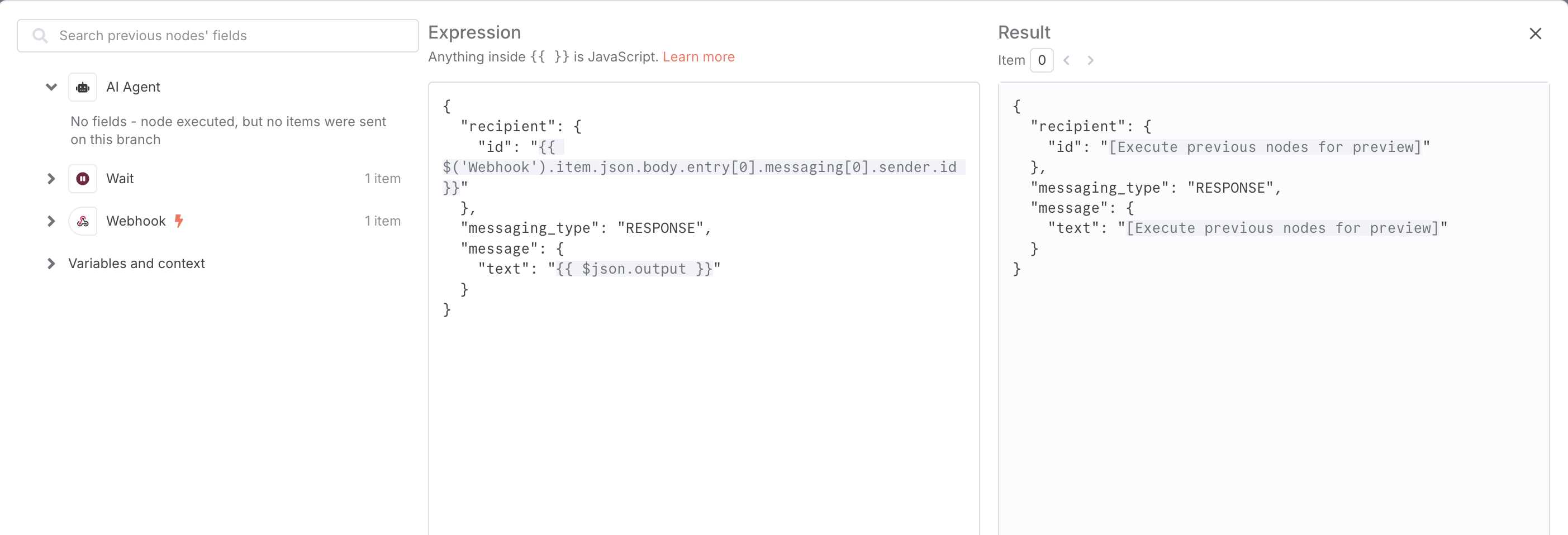

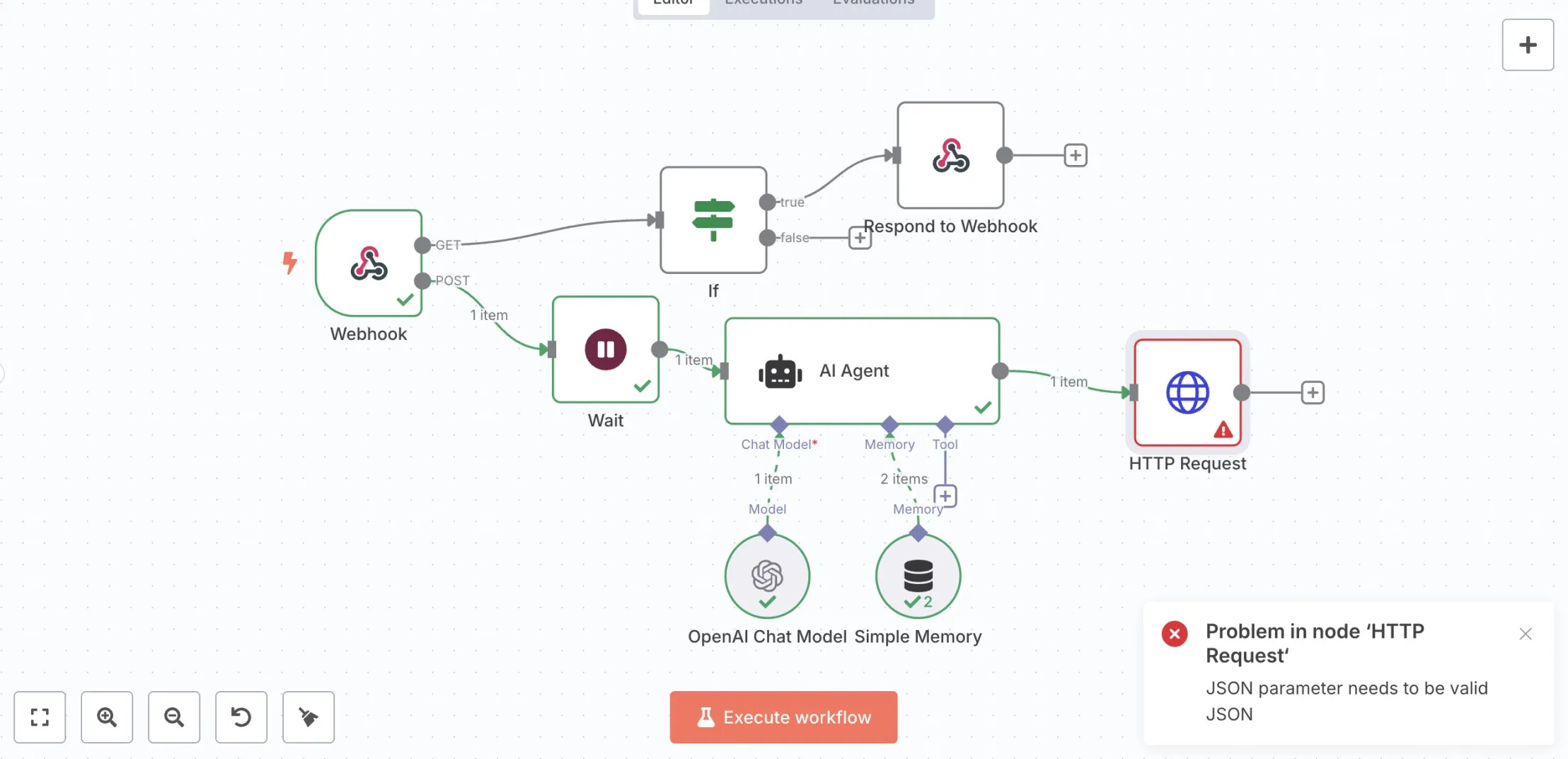

I’ve been dealing with this problem for awhile, I’m currently trying to create a messenger chatbot and it works! it responds and everything but the thing is it only responds to hello consistently. Whenever I say hello then ask a follow-up question, this error keeps popping up but, it’s not always that case as when I ask it sometimes a question on the niche, it responds. still when I ask another question after that, it gives me this error once more. thoughts on how I can possibly fix this?

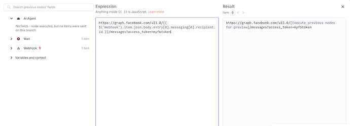

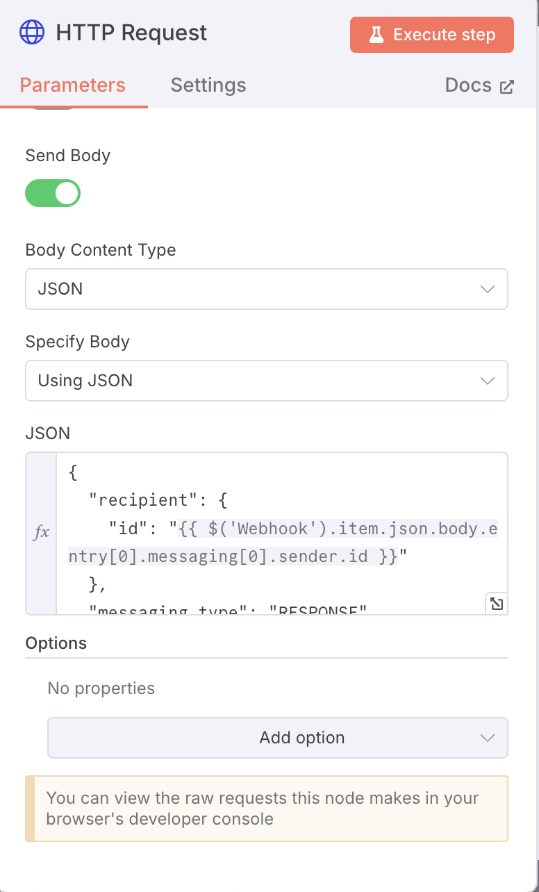

How is your HTTP Request node configured?

Can I see the HTTP Request node configuration, not one of the fields?
Or maybe you would like to attach the workflow itself, that would help.
example
Try this for your JSON in HTTP Request node:
  "recipient": {
    "id": "{{ $('Webhook').item.json.body.entry[0].messaging[0].sender.id }}"
  "messaging_type": "RESPONSE",
  "message": {
    "text": {{ $json.output.toJsonString() }}
The changes:
  • .toJsonString() for the text to overcome new lines in the output
  • quotes are removed, because the input already has quotes

Bad request, aka http status code 400, means that the request was send, by the remote side didn’t like it and thinks it’s your fault. This means that issue with JSON having the wrong format is solved, now you are having a different issue.
what do you recommend I should do?

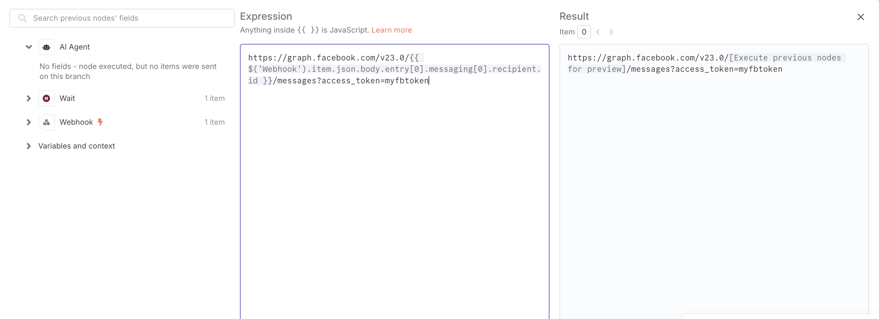

Check the IDs, both for sender and recipient, check the token. Try sending the correct request via curl and see if that works.
