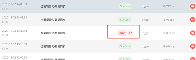

Hi, i use the node for mysql to connect AWS aurora serverless. AWS Aurora Serverless takes a while to start up, once e in a while,the connection get failed,I tried to set a longer connection timeout, but there was no place to set it . What should I do about it?

The default timeout is 10 seconds. The library we use under the hook has a Timeout property that should fix the issue. Will add this to my TODO list.
connectTimeout: The milliseconds before a timeout occurs during the initial connection to the MySQL server. (Default: 10000)
