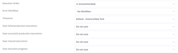

UPDATE
I am testing a the flow with the merge nodes removed and RAM does not increase, when adding Merge nodes back in, RAM increases…
Progress report
I have stopped the workflow executions from saving.
This stops errors where the workflow just freezes..
This also stops the ram from accumulating.
Will update when further tests are done.
Ram now stays around 1-2 GB
