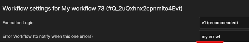

you don’t need to send all 50 Webhooks. Only one to make sure the n8n instance is alive.
inside each WF you can define an Error workflow which will trigger once there is an error with the execution.
Define an error workflow to handle errors (send them to telegram /email/etc
and then configure all your workflows with webhooks to use that error workflow
