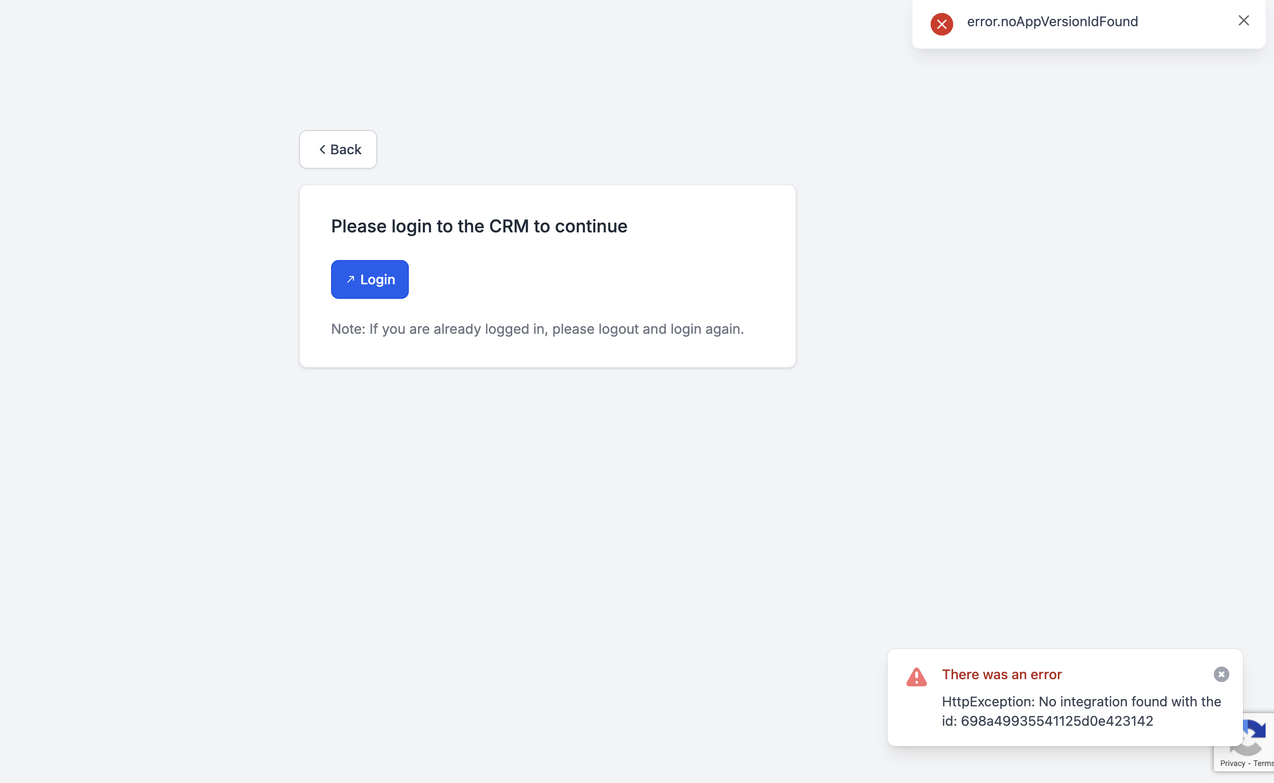

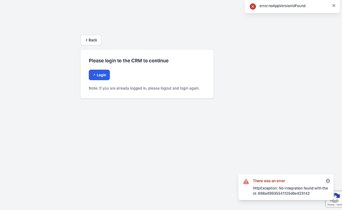

When I click “Connect my account” in n8n, it redirects me to GHL fine. I see the login screen, click “Login”, and then I get hit with:
error.noAppVersionIdFound
And then n8n shows “Something went wrong. Please try again!”
Sometimes I also get:
HttpException: No integration found with the id: [my app id]

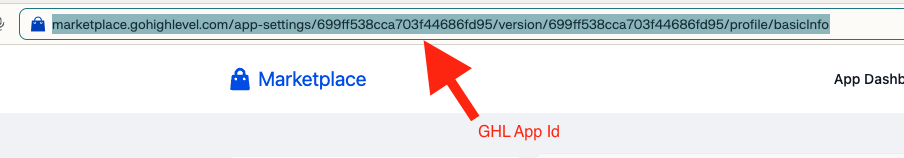

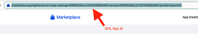

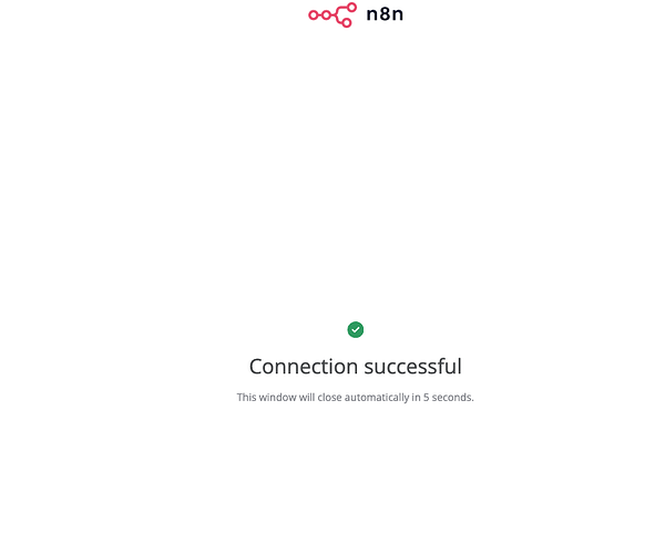

I kept facing the same error ‘No Integration found with the id: xxxxxxx’ and had to implement a workaround to solve this problem.
On the URL, I appended this
&version_id=[[your_ghl_app_id]]
You can get the GHL App Id from here
Then, it opened the right screen and I was able to proceed with the authentication.
Hope this helps.
