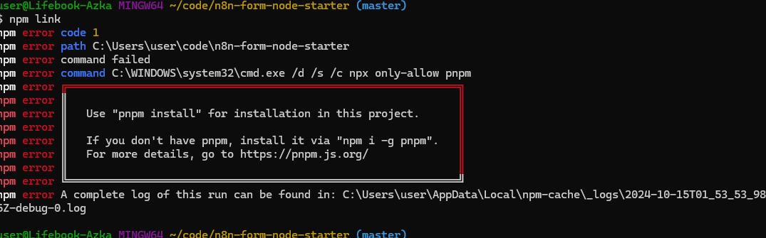

hi Jon,
the npm link part, cant seem to get it to work cause the starter uses pnpm, and I’m still a bit confused on where I should run it.
here’s some added context:
starter template lives on folder A, I ran it, and tells me to use pnpm, but whenever I do that idk what params i should give it
I gave up on getting the npm link stuff to work and did this instead: Developing Custom Nodes for n8n with Docker - DEV Community There is a section in the article with some info about the npm vs pnpm vs link that may also help.
Ah yeah we really should update the guide to cover the pnpm commands, For the most part they are the same.
When the time comes to update the guide, this issue on pnpm (still open as of Oct 2024) provides a bit of context on where things go wrong trying to use pnpm link instead of npm link - `pnpm link` in package dir:  ERR_PNPM_LINK_BAD_PARAMS  You must provide a parameter · Issue #4296 · pnpm/pnpm · GitHub
