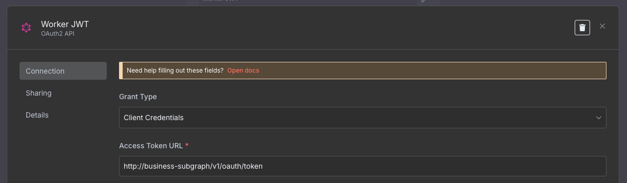

I’m new to the n8n ecosystem and excited about the possibilities it offers. I’m currently integrating n8n with a system I’m building from scratch, and I plan to use n8n as my worker platform so I can evolve and maintain everything in a controlled environment.
Our system is fully protected using OAuth2, which means every resource requires a valid access token. Because n8n’s built-in OAuth2 credential does not support specifying audience and issuer fields for Auth0, I created a backend wrapper in our API to handle the Auth0 Client Credentials flow. This solution works well—our backend issues the tokens correctly—but the access tokens eventually expire, and n8n does not automatically fetch a new one when that happens.
I’m trying to determine whether this behavior is intentional or a bug. Every OAuth2 client_credentials token must expire, so it seems like the n8n credential plugin might be ignoring the expiration timestamp, or perhaps it’s using seconds instead of milliseconds (or vice versa). In any case, I need a way for n8n to automatically refresh the token when it expires. Since I’m still learning how n8n’s credential plugins work, I’m not sure where to look in the code or how to contribute a fix.

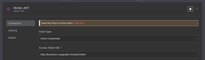

After the OAuth2 access token expires, any workflows that rely on that credential stop working. Updating the URL, client ID, client secret, or scope does not trigger a token refresh. The only way to restore functionality is to delete the credential in n8n and recreate it, which is extremely inconvenient—especially since that breaks all workflows that reference the old credential.
Below is a minimal example illustrating where the token-expiry issue occurs:
  • n8n version: 1.95.3
  • Database (default: SQLite): Postgres/pgvector v17
  • Operating system: Ubuntu 24.04
