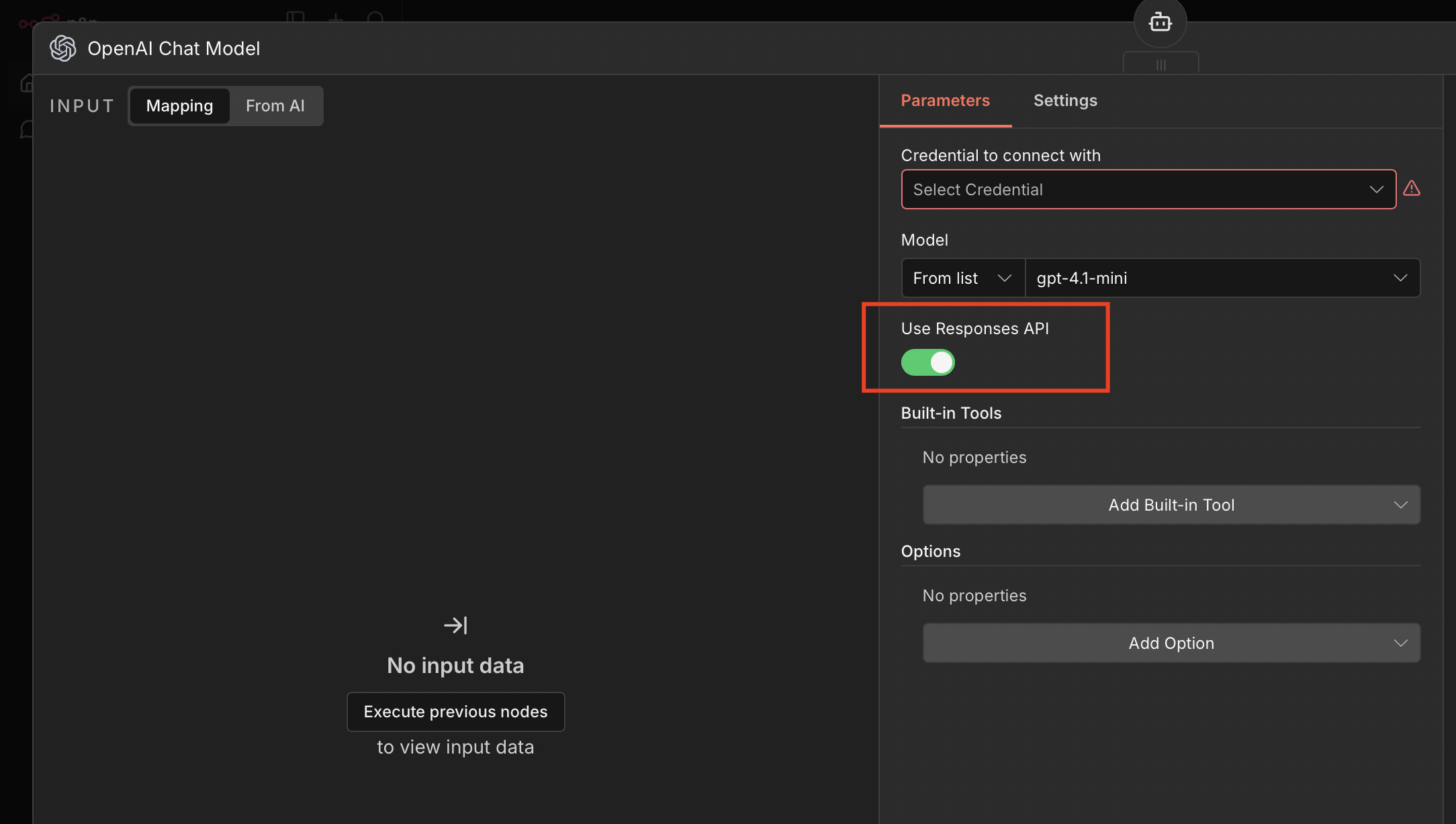

Hi @Universus, if you use the AI Agent node with the OpenAI chat model attached, you can set the responses api toggle (I believe it is default).

Thank you @Wouter_Nigrini for your reply.
I was using the OpenAI node :
Since it is the Agent node that get’s the updates, I’ll start using it instead :ok_hand:
Will it act differently, being set as an “agent” ?
I believe it should work exactly the same as long as your stick to the basic usage of a system and user prompt.
Copy your system prompt over and test it out to compare the results, unless of course you need to make use of any of the specific special additional options available on the OpenAI node?
