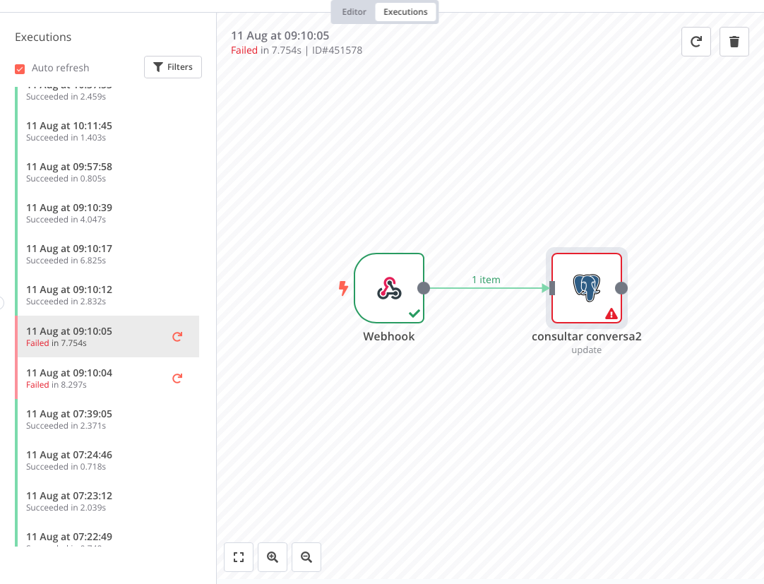

I can confirm the same happens with my n8n instance. I noticed it happens only in case of parallel queries (inserts) to the PostgresDB.
A connection pool is not the issue I think, based on an n8n behavior. Look at the screen the first request in a batch is succeeded, all others are failed with a connection pool error

It happens for Single item,
