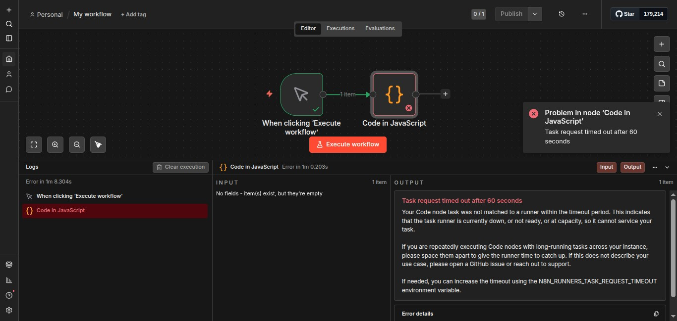

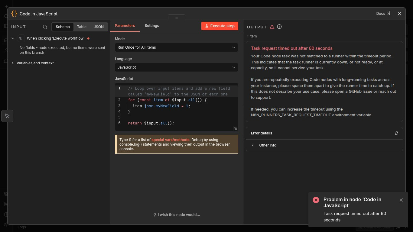

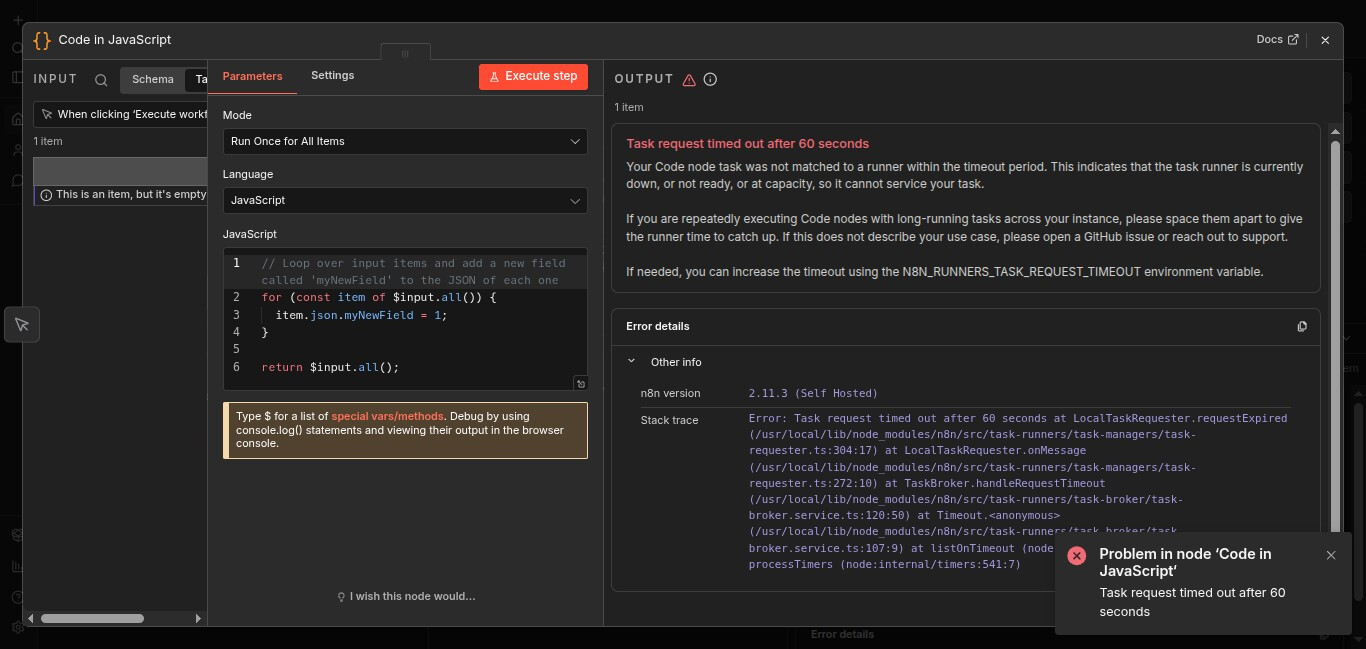

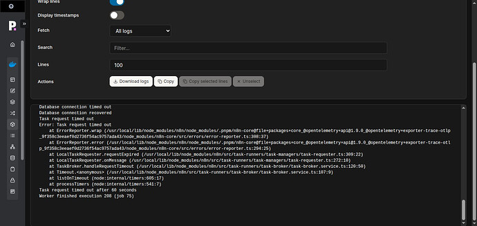

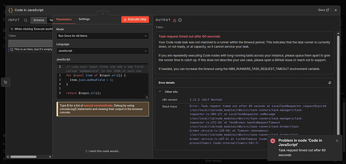

Problem executing JavaScript code
It’s been a while since the new version 2.0 or later of n8n. I can no longer run any JavaScript code in my Workflows. I don’t know if it’s a bug or an error in my infrastructure!
VPS hosting.
n8n auto-warming.
n8n installed on Portainer.
n8n version 2.11.3
Below is my stack that I’m using!
my stack:

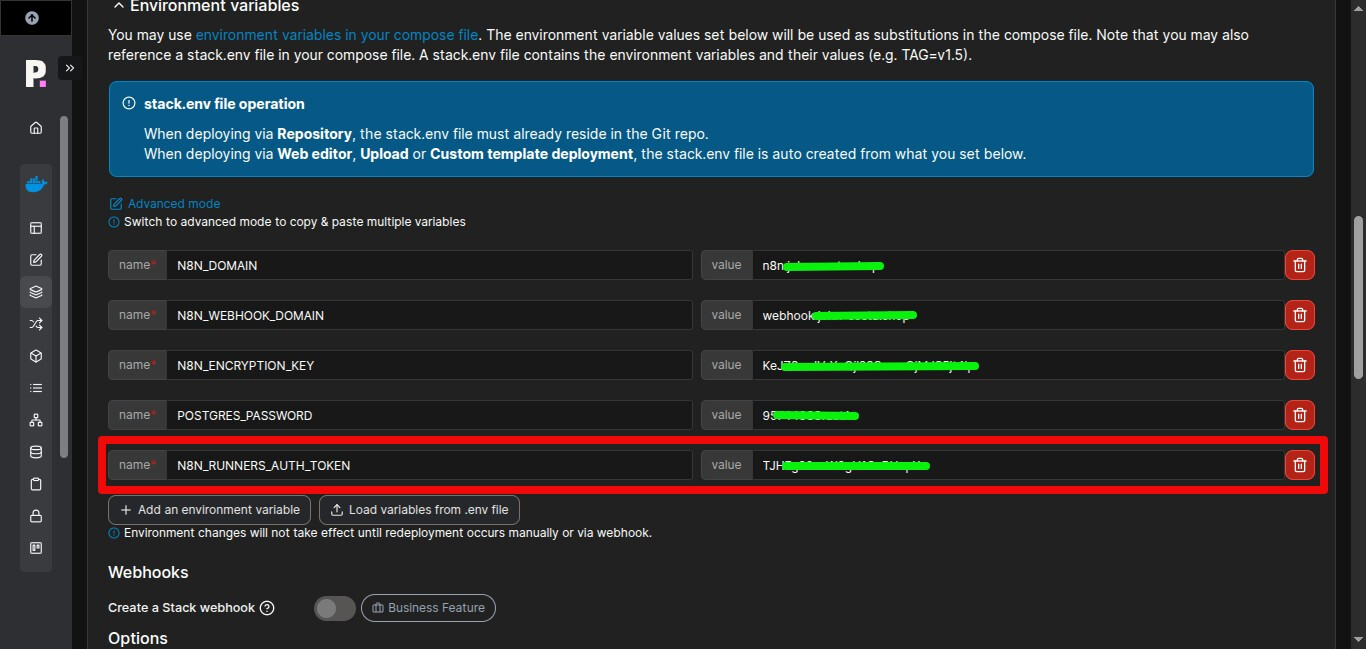

      N8N_RUNNERS_TASK_BROKER_URI: http://n8n_n8n_worker:5679
      # Token de autenticação (MESMO em todos!)
      N8N_RUNNERS_AUTH_TOKEN: ${N8N_RUNNERS_AUTH_TOKEN}

I think the issue is in your stack: N8N_RUNNERS_ENABLED is commented out on all your services.
Since n8n v2.0, Code nodes require the task runner. Without this flag, the broker on port 5679 never starts, so your n8nio/runners container has nothing to connect to and every Code node times out after 60s.
Uncomment it on at least your worker (since you have OFFLOAD_MANUAL_EXECUTIONS_TO_WORKERS=true), redeploy, and see if it works.

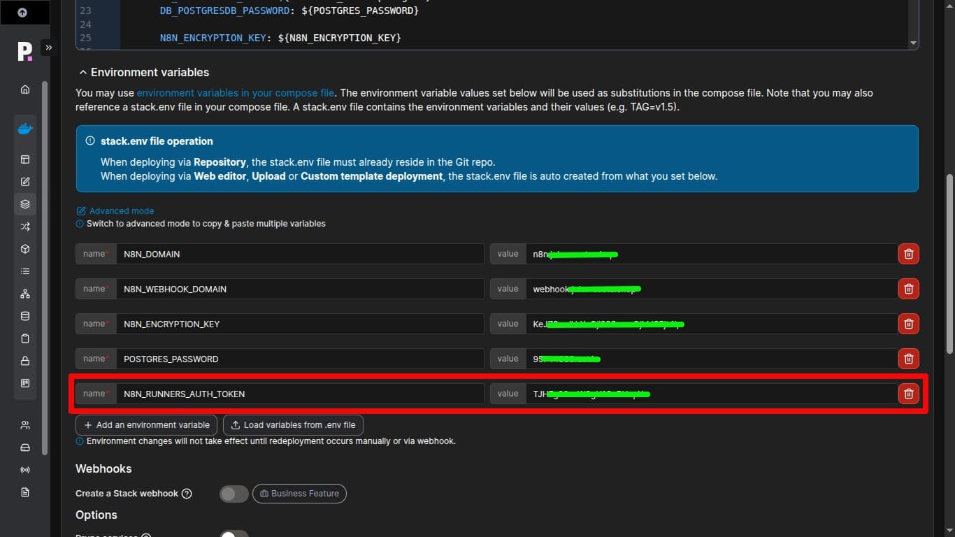

I’ve already done that! Before, I was using the N8N_RUNNERS_ENABLED variable with it enabled. The log always warned that the variable was deprecated. Regardless of whether the N8N_RUNNERS_ENABLED variable is enabled or not, the problem persists.

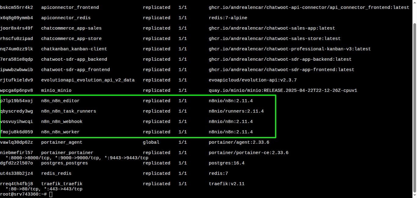

ok… potential issues:
If your stack isn’t named n8n, then n8n_n8n_worker won’t resolve. Check what docker service ls shows and match the URI accordingly.

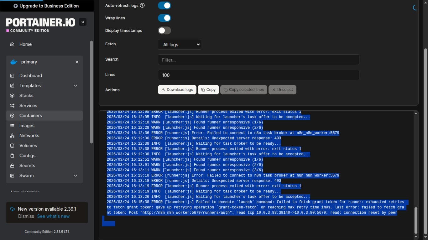

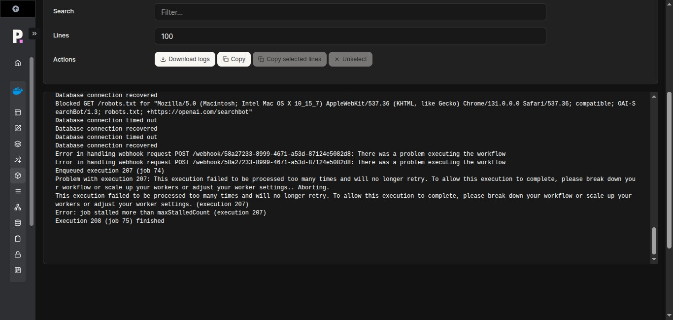

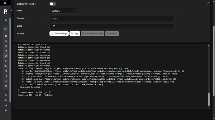

Can you share the output of docker service logs <your_runner_service>? That will show whether the runner is failing to connect, getting auth errors, or never reaching the broker at all.
output of the docker service ls command:

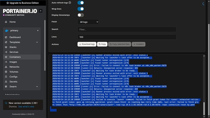

container logs n8n_n8n_task_runners:
2026/03/24 16:06:29 ERROR [runner:js] Error: Failed to connect to n8n task broker at n8n_n8n_worker:5679
2026/03/24 16:06:29 ERROR [runner:js] Details: Unexpected server response: 403
2026/03/24 16:06:29 INFO  [launcher:js] Waiting for task broker to be ready...
2026/03/24 16:06:29 ERROR [launcher:js] Runner process exited with error: exit status 1
2026/03/24 16:06:29 INFO  [launcher:js] Waiting for launcher's task offer to be accepted...
2026/03/24 16:06:43 WARN [launcher:js] Found runner unresponsive (1/6)
2026/03/24 16:06:53 WARN [launcher:js] Found runner unresponsive (2/6)
2026/03/24 16:06:55 ERROR [runner:js] Error: Failed to connect to n8n task broker at n8n_n8n_worker:5679
2026/03/24 16:06:55 ERROR [runner:js] Details: Unexpected server response: 403
2026/03/24 16:06:56 INFO  [launcher:js] Waiting for task broker to be ready...
2026/03/24 16:06:56 ERROR [launcher:js] Runner process exited with error: exit status 1
2026/03/24 16:06:56 INFO  [launcher:js] Waiting for launcher's task offer to be accepted...
2026/03/24 16:07:09 WARN [launcher:js] Found runner unresponsive (1/6)
2026/03/24 16:07:19 WARN [launcher:js] Found runner unresponsive (2/6)
2026/03/24 16:07:24 ERROR [runner:js] Error: Failed to connect to n8n task broker at n8n_n8n_worker:5679
2026/03/24 16:07:24 ERROR [runner:js] Details: Unexpected server response: 403
2026/03/24 16:07:24 INFO  [launcher:js] Waiting for task broker to be ready...
2026/03/24 16:07:24 ERROR [launcher:js] Runner process exited with error: exit status 1
2026/03/24 16:07:24 INFO  [launcher:js] Waiting for launcher's task offer to be accepted...
2026/03/24 16:07:37 WARN [launcher:js] Found runner unresponsive (1/6)
2026/03/24 16:07:48 WARN [launcher:js] Found runner unresponsive (2/6)
2026/03/24 16:07:50 ERROR [runner:js] Error: Failed to connect to n8n task broker at n8n_n8n_worker:5679
2026/03/24 16:07:50 ERROR [runner:js] Details: Unexpected server response: 403
2026/03/24 16:07:50 ERROR [launcher:js] Runner process exited with error: exit status 1
2026/03/24 16:07:50 INFO  [launcher:js] Waiting for task broker to be ready...
2026/03/24 16:07:51 INFO  [launcher:js] Waiting for launcher's task offer to be accepted...
2026/03/24 16:08:04 WARN [launcher:js] Found runner unresponsive (1/6)
2026/03/24 16:08:14 WARN [launcher:js] Found runner unresponsive (2/6)
2026/03/24 16:08:21 ERROR [runner:js] Error: Failed to connect to n8n task broker at n8n_n8n_worker:5679
2026/03/24 16:08:21 ERROR [runner:js] Details: Unexpected server response: 403
2026/03/24 16:08:22 INFO  [launcher:js] Waiting for task broker to be ready...
2026/03/24 16:08:22 ERROR [launcher:js] Runner process exited with error: exit status 1
2026/03/24 16:08:22 INFO  [launcher:js] Waiting for launcher's task offer to be accepted...
2026/03/24 16:08:35 WARN [launcher:js] Found runner unresponsive (1/6)
2026/03/24 16:08:45 WARN [launcher:js] Found runner unresponsive (2/6)
2026/03/24 16:08:55 WARN [launcher:js] Found runner unresponsive (3/6)
2026/03/24 16:09:00 ERROR [runner:js] Error: Failed to connect to n8n task broker at n8n_n8n_worker:5679
2026/03/24 16:09:00 ERROR [runner:js] Details: Unexpected server response: 403
2026/03/24 16:09:01 INFO  [launcher:js] Waiting for task broker to be ready...
2026/03/24 16:09:01 ERROR [launcher:js] Runner process exited with error: exit status 1
2026/03/24 16:09:01 INFO  [launcher:js] Waiting for launcher's task offer to be accepted...
2026/03/24 16:09:14 WARN [launcher:js] Found runner unresponsive (1/6)
2026/03/24 16:09:24 WARN [launcher:js] Found runner unresponsive (2/6)
2026/03/24 16:09:30 ERROR [runner:js] Error: Failed to connect to n8n task broker at n8n_n8n_worker:5679
2026/03/24 16:09:30 ERROR [runner:js] Details: Unexpected server response: 403
2026/03/24 16:09:30 ERROR [launcher:js] Runner process exited with error: exit status 1
2026/03/24 16:09:30 INFO  [launcher:js] Waiting for task broker to be ready...
2026/03/24 16:09:30 INFO  [launcher:js] Waiting for launcher's task offer to be accepted...
2026/03/24 16:09:44 WARN [launcher:js] Found runner unresponsive (1/6)
2026/03/24 16:09:54 WARN [launcher:js] Found runner unresponsive (2/6)
2026/03/24 16:09:59 ERROR [runner:js] Error: Failed to connect to n8n task broker at n8n_n8n_worker:5679
2026/03/24 16:09:59 ERROR [runner:js] Details: Unexpected server response: 403
2026/03/24 16:09:59 ERROR [launcher:js] Runner process exited with error: exit status 1
2026/03/24 16:09:59 INFO  [launcher:js] Waiting for task broker to be ready...
2026/03/24 16:09:59 INFO  [launcher:js] Waiting for launcher's task offer to be accepted...
2026/03/24 16:10:12 WARN [launcher:js] Found runner unresponsive (1/6)
2026/03/24 16:10:22 WARN [launcher:js] Found runner unresponsive (2/6)
2026/03/24 16:10:30 ERROR [runner:js] Error: Failed to connect to n8n task broker at n8n_n8n_worker:5679
2026/03/24 16:10:30 ERROR [runner:js] Details: Unexpected server response: 403
2026/03/24 16:10:30 ERROR [launcher:js] Runner process exited with error: exit status 1
2026/03/24 16:10:30 INFO  [launcher:js] Waiting for task broker to be ready...
2026/03/24 16:10:31 INFO  [launcher:js] Waiting for launcher's task offer to be accepted...
2026/03/24 16:10:44 WARN [launcher:js] Found runner unresponsive (1/6)
2026/03/24 16:10:54 WARN [launcher:js] Found runner unresponsive (2/6)
2026/03/24 16:10:59 ERROR [runner:js] Error: Failed to connect to n8n task broker at n8n_n8n_worker:5679
2026/03/24 16:10:59 ERROR [runner:js] Details: Unexpected server response: 403
2026/03/24 16:10:59 ERROR [launcher:js] Runner process exited with error: exit status 1
2026/03/24 16:10:59 INFO  [launcher:js] Waiting for task broker to be ready...
2026/03/24 16:11:00 INFO  [launcher:js] Waiting for launcher's task offer to be accepted...
2026/03/24 16:11:13 WARN [launcher:js] Found runner unresponsive (1/6)
2026/03/24 16:11:23 WARN [launcher:js] Found runner unresponsive (2/6)
2026/03/24 16:11:33 ERROR [runner:js] Error: Failed to connect to n8n task broker at n8n_n8n_worker:5679
2026/03/24 16:11:33 ERROR [runner:js] Details: Unexpected server response: 403
2026/03/24 16:11:33 WARN [launcher:js] Found runner unresponsive (3/6)
2026/03/24 16:11:33 INFO  [launcher:js] Waiting for task broker to be ready...
2026/03/24 16:11:33 ERROR [launcher:js] Runner process exited with error: exit status 1
2026/03/24 16:11:34 INFO  [launcher:js] Waiting for launcher's task offer to be accepted...
2026/03/24 16:11:47 WARN [launcher:js] Found runner unresponsive (1/6)
2026/03/24 16:11:57 WARN [launcher:js] Found runner unresponsive (2/6)
2026/03/24 16:12:04 ERROR [runner:js] Error: Failed to connect to n8n task broker at n8n_n8n_worker:5679
2026/03/24 16:12:04 ERROR [runner:js] Details: Unexpected server response: 403
2026/03/24 16:12:05 INFO  [launcher:js] Waiting for task broker to be ready...
2026/03/24 16:12:05 ERROR [launcher:js] Runner process exited with error: exit status 1
2026/03/24 16:12:05 INFO  [launcher:js] Waiting for launcher's task offer to be accepted...
2026/03/24 16:12:18 WARN [launcher:js] Found runner unresponsive (1/6)
2026/03/24 16:12:28 WARN [launcher:js] Found runner unresponsive (2/6)
2026/03/24 16:12:36 ERROR [runner:js] Error: Failed to connect to n8n task broker at n8n_n8n_worker:5679
2026/03/24 16:12:36 ERROR [runner:js] Details: Unexpected server response: 403
2026/03/24 16:12:38 INFO  [launcher:js] Waiting for task broker to be ready...
2026/03/24 16:12:38 ERROR [launcher:js] Runner process exited with error: exit status 1
2026/03/24 16:12:38 INFO  [launcher:js] Waiting for launcher's task offer to be accepted...
2026/03/24 16:12:51 WARN [launcher:js] Found runner unresponsive (1/6)
2026/03/24 16:13:01 WARN [launcher:js] Found runner unresponsive (2/6)
2026/03/24 16:13:11 WARN [launcher:js] Found runner unresponsive (3/6)
2026/03/24 16:13:18 ERROR [runner:js] Error: Failed to connect to n8n task broker at n8n_n8n_worker:5679
2026/03/24 16:13:18 ERROR [runner:js] Details: Unexpected server response: 403
2026/03/24 16:13:19 ERROR [launcher:js] Runner process exited with error: exit status 1
2026/03/24 16:13:19 INFO  [launcher:js] Waiting for task broker to be ready...
2026/03/24 16:13:26 INFO  [launcher:js] Waiting for launcher's task offer to be accepted...
2026/03/24 16:15:38 ERROR [launcher:js] Failed to execute `launch` command: failed to fetch grant token for runner: exhausted retries to fetch grant token: gave up retrying operation `grant-token-fetch` on reaching max retry time 1m0s, last error: failed to fetch grant token: Post "http://n8n_n8n_worker:5679/runners/auth": read tcp 10.0.3.93:39140->10.0.3.80:5679: read: connection reset by peer

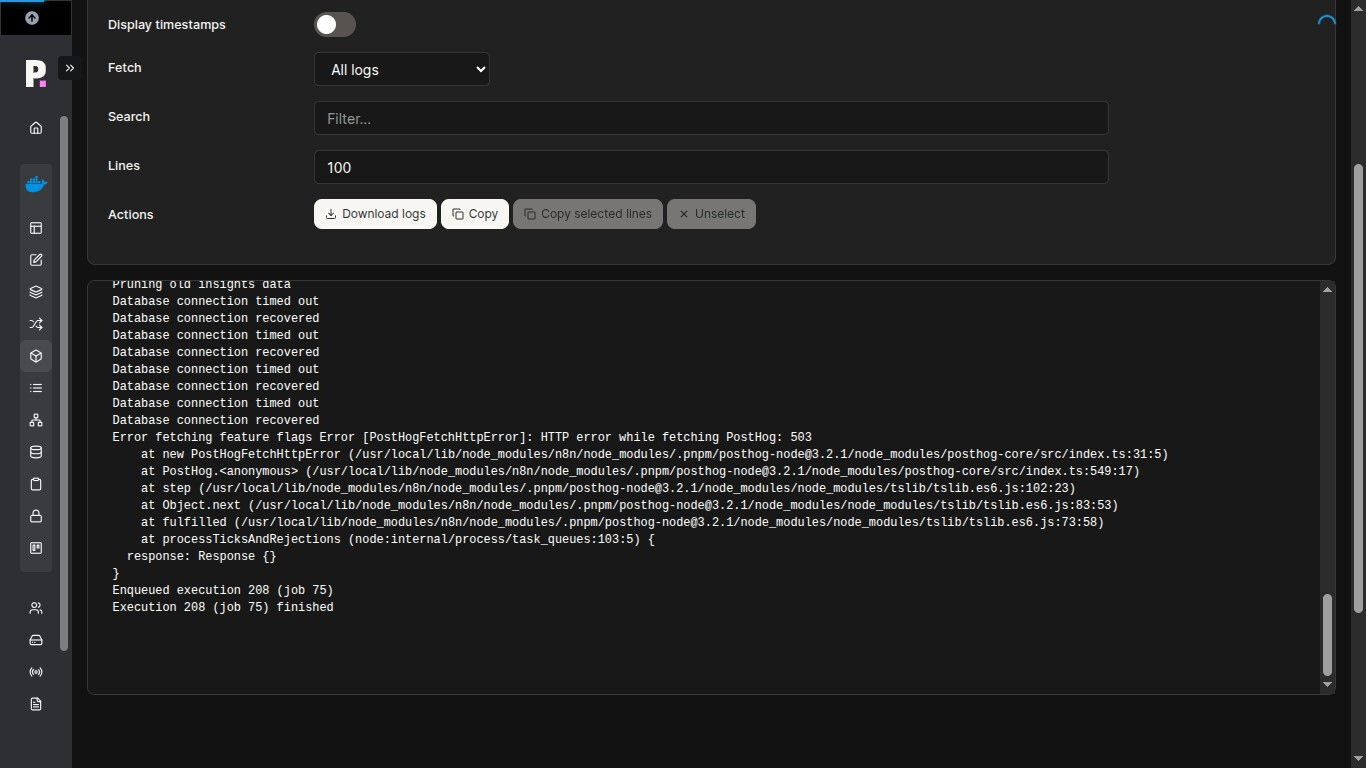

container logs n8n_n8n_editor
Slow database query
Slow database query
Slow database query
Pruning old insights data
Database connection timed out
Error fetching feature flags DOMException [TimeoutError]: The operation was aborted due to timeout
    at new DOMException (node:internal/per_context/domexception:76:18)
    at Timeout._onTimeout (node:internal/abort_controller:154:9)
    at listOnTimeout (node:internal/timers:605:17)
    at processTimers (node:internal/timers:541:7)
Database connection recovered
Slow database query
Slow database query
Slow database query
Slow database query
User attempted to access a workflow without permissions
Failed to find workflow with ID "uciCdZiAfEhvsIX7XHKLR"
Failed to find workflow with ID "ufkXe0LBgCHjnFbE"
Failed to find workflow with ID "P4Jmd1irDIqA1QrO"
Slow database query
Slow database query
Slow database query
Slow database query
Enqueued execution 205 (job 72)
Execution 205 (job 72) finished
(node:7) [DEP0169] DeprecationWarning: `url.parse()` behavior is not standardized and prone to errors that have security implications. Use the WHATWG URL API instead. CVEs are not issued for `url.parse()` vulnerabilities.
Execution 206 (job 73) finished
Failed to find workflow with ID "xpWLm0Qpi_Wh0M2qLT2yk"
Blocked GET /robots.txt for "Mozilla/5.0 (Macintosh; Intel Mac OS X 10_15_7) AppleWebKit/537.36 (KHTML, like Gecko) Chrome/131.0.0.0 Safari/537.36; compatible; OAI-SearchBot/1.3; robots.txt; +https://openai.com/searchbot"
Blocked GET / for "Mozilla/5.0 AppleWebKit/537.36 (KHTML, like Gecko; compatible; GPTBot/1.3; +https://openai.com/gptbot)"
Blocked GET /robots.txt for "Mozilla/5.0 (compatible; Googlebot/2.1; +http://www.google.com/bot.html)"
Blocked GET /rest/oauth2-credential/callback for "Mozilla/5.0 (Linux; Android 6.0.1; Nexus 5X Build/MMB29P) AppleWebKit/537.36 (KHTML, like Gecko) Chrome/145.0.7632.159 Mobile Safari/537.36 (compatible; Googlebot/2.1; +http://www.google.com/bot.html)"
Slow database query
Slow database query
Slow database query
Slow database query
Slow database query
Slow database query
Slow database query
Slow database query
Slow database query
Slow database query
Slow database query
Slow database query
Error fetching feature flags Error [PostHogFetchHttpError]: HTTP error while fetching PostHog: 503
    at new PostHogFetchHttpError (/usr/local/lib/node_modules/n8n/node_modules/.pnpm/posthog-node@3.2.1/node_modules/posthog-core/src/index.ts:31:5)
    at PostHog.<anonymous> (/usr/local/lib/node_modules/n8n/node_modules/.pnpm/posthog-node@3.2.1/node_modules/posthog-core/src/index.ts:549:17)
    at step (/usr/local/lib/node_modules/n8n/node_modules/.pnpm/posthog-node@3.2.1/node_modules/node_modules/tslib/tslib.es6.js:102:23)
    at Object.next (/usr/local/lib/node_modules/n8n/node_modules/.pnpm/posthog-node@3.2.1/node_modules/node_modules/tslib/tslib.es6.js:83:53)
    at fulfilled (/usr/local/lib/node_modules/n8n/node_modules/.pnpm/posthog-node@3.2.1/node_modules/node_modules/tslib/tslib.es6.js:73:58)
    at processTicksAndRejections (node:internal/process/task_queues:103:5) {
  response: Response {}
Enqueued execution 208 (job 75)
Execution 208 (job 75) finished

Execution 204 (job 71) finished
[license SDK] Skipping renewal on init: renewOnInit is disabled in config
[license SDK] Skipping renewal on init: autoRenewEnabled is disabled in config
[license SDK] Skipping renewal on init: license cert is not due for renewal
(node:7) [DEP0040] DeprecationWarning: The `punycode` module is deprecated. Please use a userland alternative instead.
(Use `node --trace-deprecation ...` to show where the warning was created)
Error in handling webhook request POST /webhook/089a1a36-18c9-4fdf-adec-41a3870e97e6: There was a problem executing the workflow
Enqueued execution 206 (job 73)
Error in handling webhook request POST /webhook/58a27233-8999-4671-a53d-87124e5082d8: There was a problem executing the workflow
Enqueued execution 207 (job 74)
Problem with execution 207: This execution failed to be processed too many times and will no longer retry. To allow this execution to complete, please break down your workflow or scale up your workers or adjust your worker settings.. Aborting.
This execution failed to be processed too many times and will no longer retry. To allow this execution to complete, please break down your workflow or scale up your workers or adjust your worker settings. (execution 207)
Error: job stalled more than maxStalledCount (execution 207)
container logs n8n_n8n_worker:
Task runner connection attempt failed: invalid or expired grant token
Registered runner "launcher-javascript" (b5b9b191b5ce14d0)
Registered runner "launcher-javascript" (f4d52b5f98ad9155)
Registered runner "launcher-javascript" (f5ad4fc912872129)
Registered runner "launcher-javascript" (55ac62a194c59a4b)
Registered runner "launcher-javascript" (137ecff7ca8d1b28)
Registered runner "launcher-javascript" (718364a71704555d)
Registered runner "launcher-javascript" (265bccd0ece31370)
Registered runner "launcher-javascript" (6642cf8964eb0a33)
Registered runner "launcher-javascript" (b31d6dc98d774d90)
Registered runner "launcher-javascript" (50f478ba28c7dcf5)
Registered runner "launcher-javascript" (546bec97b39c1a26)
Registered runner "launcher-javascript" (9ebea7b922024c44)
Registered runner "launcher-javascript" (a77b473790198ffc)
Registered runner "launcher-javascript" (3e089e52e0440df1)
Registered runner "launcher-javascript" (5547490735e79ee2)
Registered runner "launcher-javascript" (a5af74a5c591c8b8)
Registered runner "launcher-javascript" (e4cfe2317b2c4b6f)
Registered runner "launcher-javascript" (7b0a149ee8d4aef6)
Registered runner "launcher-javascript" (25ae09e2c4c9776c)
Registered runner "launcher-javascript" (ba63318120f12541)
Registered runner "launcher-javascript" (72df753bfa99abb4)
Registered runner "launcher-javascript" (a909b53d1aae01ea)
Registered runner "launcher-javascript" (956d41c28711501e)
Registered runner "launcher-javascript" (fd7ec64010d84ba5)
Registered runner "launcher-javascript" (090be9f397a4f1c4)
Registered runner "launcher-javascript" (33136bd5a3c0d80a)
Registered runner "launcher-javascript" (3e988e9d9f64a4b1)
Worker started execution 207 (job 74)
Registered runner "launcher-javascript" (a1aa9920814ba683)
Runner (a1aa9920814ba683) took too long to acknowledge acceptance of task (t_GvruE1)
Task request timed out
Error: Task request timed out
    at ErrorReporter.wrap (/usr/local/lib/node_modules/n8n/node_modules/.pnpm/n8n-core@file+packages+core_@opentelemetry+api@1.9.0_@opentelemetry+exporter-trace-otlp_9f358c3eeaef0d2736f54ac9757ada43/node_modules/n8n-core/src/errors/error-reporter.ts:308:37)
    at ErrorReporter.error (/usr/local/lib/node_modules/n8n/node_modules/.pnpm/n8n-core@file+packages+core_@opentelemetry+api@1.9.0_@opentelemetry+exporter-trace-otlp_9f358c3eeaef0d2736f54ac9757ada43/node_modules/n8n-core/src/errors/error-reporter.ts:294:25)
    at LocalTaskRequester.requestExpired (/usr/local/lib/node_modules/n8n/src/task-runners/task-managers/task-requester.ts:309:22)
    at LocalTaskRequester.onMessage (/usr/local/lib/node_modules/n8n/src/task-runners/task-managers/task-requester.ts:272:10)
    at TaskBroker.handleRequestTimeout (/usr/local/lib/node_modules/n8n/src/task-runners/task-broker/task-broker.service.ts:120:50)
    at Timeout.<anonymous> (/usr/local/lib/node_modules/n8n/src/task-runners/task-broker/task-broker.service.ts:107:9)
Task request timed out after 60 seconds
Worker finished execution 207 (job 74)
Worker errored while running execution 207 (job 74)
Queue errored
Queue errored
Error: Missing key for job 74 failed
    at Object.finishedErrors (/usr/local/lib/node_modules/n8n/node_modules/.pnpm/bull@4.16.4_patch_hash=a4b6d56db16fe5870646929938466d6a5c668435fd1551bed6a93fffb597ba42/node_modules/bull/lib/scripts.js:287:16)
    at Job.moveToFailed (/usr/local/lib/node_modules/n8n/node_modules/.pnpm/bull@4.16.4_patch_hash=a4b6d56db16fe5870646929938466d6a5c668435fd1551bed6a93fffb597ba42/node_modules/bull/lib/job.js:345:19)
Worker started execution 208 (job 75)
Worker finished execution 208 (job 75)
the runner is getting 403s because N8N_RUNNERS_AUTH_TOKEN isn’t resolving to the same value on both the worker and runner containers. Swarm sometimes silently fails to inject env vars. fix that first. the database timeouts are a separate issue but also need attention since Postgres is clearly being starved for resources.​​​​​​​​​​​​​​​​
The only thing i personally see that needs attention is your worker is set to 0.5 CPU / 1GB RAM, that’s too low to handle both executions and the task broker. Combined with your constant database timeouts, the grant token exchange can’t complete in time.
try these:
Increase your worker resources to at least 1.0 CPU / 2048M memory
Check your Postgres container resources, every service is logging “Database connection timed out” nonstop, which slows everything down. Consider reducing EXECUTIONS_DATA_MAX_AGE from 336 to 72 to lighten the DB load
Redeploy
This community user who had this exact issue confirmed that allocating more resources resolved it immediately. check the thread below
Here’s the image!
I’ll try it and then come back and let you know if it worked!
Unfortunately, the problem still persists.
Setting up environment variables.
Here is the corrected stack.

      N8N_LOG_LEVEL: ${N8N_LOG_LEVEL:-info}
      CODE_ENABLE_STDOUT: 'true'
      N8N_BLOCK_ENV_ACCESS_IN_NODE: ${N8N_BLOCK_ENV_ACCESS_IN_NODE:-'true'}
      N8N_RESTRICT_FILE_ACCESS_TO: ${N8N_RESTRICT_FILE_ACCESS_TO:-/home/node/.n8n-files}
      N8N_DEFAULT_BINARY_DATA_MODE: ${N8N_DEFAULT_BINARY_DATA_MODE:-database}
      GENERIC_TIMEZONE: ${TIMEZONE:-America/Sao_Paulo}
      TZ: ${TIMEZONE:-America/Sao_Paulo}
      N8N_SKIP_AUTH_ON_OAUTH_CALLBACK: ${N8N_SKIP_AUTH_ON_OAUTH_CALLBACK:-false}
      N8N_GIT_NODE_DISABLE_BARE_REPOS: ${N8N_GIT_NODE_DISABLE_BARE_REPOS:-true}
      NODES_EXCLUDE: ${NODES_EXCLUDE:-n8n-nodes-base.executeCommand,n8n-nodes-base.localFileTrigger}
    deploy:
      mode: replicated
      replicas: 1
      placement:
        constraints:
          - node.role == manager
      resources:
        limits:
          cpus: '1.0'
          memory: 2048M
      labels:
        - traefik.enable=true
        - traefik.http.routers.n8n_webhook.rule=Host(`${N8N_WEBHOOK_DOMAIN}`)
        - traefik.http.routers.n8n_webhook.service=n8n_webhook
        - traefik.http.routers.n8n_webhook.entrypoints=${TRAEFIK_ENTRYPOINT:-websecure}
        - traefik.http.routers.n8n_webhook.tls.certresolver=${TRAEFIK_CERT_RESOLVER:-le}
        - traefik.http.routers.n8n_webhook.tls=true
        - traefik.http.services.n8n_webhook.loadbalancer.server.port=5678
    networks:
      - traefik_public
      - digital_network
  n8n_worker:
    image: n8nio/n8n:2.11.4
    command: worker --concurrency=5
    environment:
      DB_TYPE: postgresdb
      DB_POSTGRESDB_PORT: ${POSTGRES_PORT:-5432}
      DB_POSTGRESDB_HOST: ${POSTGRES_HOST:-postgres}
      DB_POSTGRESDB_DATABASE: ${POSTGRES_DB:-n8n_fila}
      DB_POSTGRESDB_USER: ${POSTGRES_USER:-postgres}
      DB_POSTGRESDB_PASSWORD: ${POSTGRES_PASSWORD}
      LANGCHAIN_ENDPOINT: ${LANGCHAIN_ENDPOINT:-https://api.smith.langchain.com}
      LANGCHAIN_TRACING_V2: ${LANGCHAIN_TRACING_V2:-"false"}
      LANGCHAIN_API_KEY: ${LANGCHAIN_API_KEY:-}
      N8N_ENCRYPTION_KEY: ${N8N_ENCRYPTION_KEY}
      N8N_HOST: ${N8N_DOMAIN}
      N8N_EDITOR_BASE_URL: https://${N8N_DOMAIN}/
      N8N_PROTOCOL: ${N8N_PROTOCOL:-https}
      NODE_ENV: production
      WEBHOOK_URL: https://${N8N_WEBHOOK_DOMAIN}/
      EXECUTIONS_MODE: queue
      QUEUE_BULL_REDIS_HOST: ${REDIS_HOST:-redis}
      QUEUE_BULL_REDIS_PORT: ${REDIS_PORT:-6379}
      QUEUE_BULL_REDIS_DB: ${REDIS_DB:-2}
      # Task Runners EXTERNOS - worker expõe o broker
      #N8N_RUNNERS_ENABLED: 'true'
      N8N_RUNNERS_MODE: 'external'
      N8N_RUNNERS_BROKER_LISTEN_ADDRESS: 0.0.0.0
      N8N_PROXY_HOPS: 1
      NODE_FUNCTION_ALLOW_EXTERNAL: ${NODE_FUNCTION_ALLOW_EXTERNAL:-moment,lodash}
      N8N_COMMUNITY_PACKAGES_ALLOW_TOOL_USAGE: 'true'
      N8N_REINSTALL_MISSING_PACKAGES: 'true'
      EXECUTIONS_DATA_PRUNE: ${EXECUTIONS_DATA_PRUNE:-true}
      EXECUTIONS_DATA_MAX_AGE: ${EXECUTIONS_DATA_MAX_AGE:-72}
    deploy:
      mode: replicated
      replicas: 1
      placement:
        constraints:
      resources:
        limits:
          cpus: '1.0'
          memory: 2048M
    networks:
      - digital_network
  # Task Runners - EXATAMENTE como o exemplo oficial
  n8n_task_runners:
    image: n8nio/runners:2.11.4
    environment:
      # Conecta ao worker via HTTP (porta 5679)
      # Permite bibliotecas externas
      # Timezone
      GENERIC_TIMEZONE: America/Sao_Paulo
      TZ: America/Sao_Paulo
    depends_on:
      - n8n_worker
    deploy:
      mode: replicated
      replicas: 1
      placement:
        constraints:
      resources:
        limits:
          cpus: '1.5'
          memory: 3072M
      restart_policy:
        condition: any
        delay: 5s
    networks:
      - digital_network
networks:
  traefik_public:
    external: true
  digital_network:
    external: true
container logs n8n_n8n_editor:
Initializing n8n process
n8n ready on ::, port 5678
n8n Task Broker ready on 0.0.0.0, port 5679
Version: 2.11.4
Building workflow dependency index...
Start Active Workflows:
Activated workflow "mcp-server-AgendamentoV4" (ID: tAhtJpoXRZ1XKCAm1mzR6)
Activated workflow "ToolsCustomerNewAgendamento" (ID: jBDhVEUa1aL_RW9sirDvZ)
Finished building workflow dependency index. Processed 9 draft workflows, 0 published workflows.
Activated workflow "mcp_server_new_google_calendario" (ID: OVjHSoOZvidw_vWb4x2gu)
Activated workflow "EvolutionAPI-New-AgendamentoFollowUp-MCP-supabase-Elevenlabs-001" (ID: FcDeP9g4zvg8aUmwkV5Fw)
Activated workflow "mcp server" (ID: usnJopNEmnZRu8Q4kIRQm)
(node:7) [DEP0060] DeprecationWarning: The `util._extend` API is deprecated. Please use Object.assign() instead.
Activated workflow "ImportPdfToTable" (ID: grWGMh-JgvDei405wsn8F)
Activated workflow "ToolsGoogleCalendarAgendamentoV4" (ID: bCeD5uQ4ufOd-9sS47g6c)
Activated workflow "ToolsPurchase" (ID: zpU9mGvcB5WGpJHV7Ba6u)
Activated workflow "ToolsCustomerChatCommerce" (ID: oe0gyA5wHP-4has7RJwq6)
Activated workflow "ChatbotAtendimentonNew" (ID: 5xTCd3rOYzWupzyiQpfjI)
Editor is now accessible via:
https://n8n.john-costa.shop
Enqueued execution 209 (job 76)
Execution 209 (job 76) finished
Enqueued execution 210 (job 77)
Execution 210 (job 77) finished
2026/03/25 16:11:05 WARN  [launcher:py] Task broker is down, launcher will try to reconnect...
2026/03/25 16:11:10 INFO  [launcher:py] Waiting for task broker to be ready...
2026/03/25 16:15:25 INFO  [launcher:py] Waiting for launcher's task offer to be accepted...
container logs n8n_n8n_webhook:
Starting n8n webhook process...
Version: 2.11.4
Webhook listener waiting for requests.
n8n worker is now ready
 * Version: 2.11.4
 * Concurrency: 5
Registered runner "launcher-python" (4de57c0f6dc7c712)
Worker finished execution 209 (job 76)
Worker started execution 210 (job 77)
Worker finished execution 210 (job 77)
looks like the runner container is still from the old deployment — the errors in its logs are from yesterday. force redeploy it with docker service update --force n8n_n8n_task_runners and see if the JS runner registers after that.
also worth checking: your editor logs show the task broker starting on port 5679 there too, not just the worker. make sure N8N_RUNNERS_TASK_BROKER_URI is pointing at the right service.

hi @John_da_Costa_Goncal
From an architectural perspective, this flow should be:
Workflow > Worker > Task Broker > Runner > JavaScript execution > Result > Worker
In n8n v2+, Code nodes run through task runners, so when you see Task request timed out after 60 seconds, it usually means the worker submitted the task, but no runner picked it up in time.
Given the earlier 403, failed to fetch grant token, and invalid or expired grant token errors, this seems to be happening during the runner–broker handshake. The broker is up, but the runner isn’t being accepted as a valid execution consumer.
I’d focus on verifying the actual runtime values of N8N_RUNNERS_AUTH_TOKEN and related env vars inside both the worker and task_runners containers after a full redeploy, rather than relying only on the Portainer UI. The database timeouts may add instability, but they look secondary here.
I hope everything goes well :dizzy:
