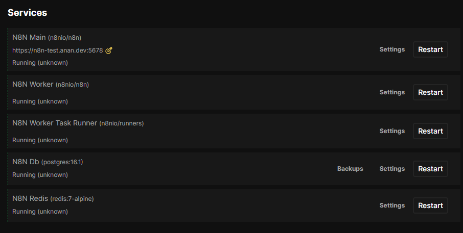

Hi @Nac, welcome!
I have a few notes on the compose you can try:
depends_on:
      - n8n-worker
Give that a try and let me know the result..
Thank you for your reply
after doing the changes the execution still the same error!

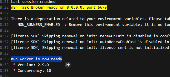

Could you please check the logs for the following services:
n8n:
n8n worker:
task runner:
These are the logs when everything is working correctly,
so what do you actually see in the logs on your side?

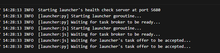

root@root:/home/rootroot/n8n# docker compose logs n8n-worker-task-runner
n8n-worker-task-runner-1 | 2026/02/17 14:15:34 INFO Starting launcher’s health check server at port 5680
n8n-worker-task-runner-1 | 2026/02/17 14:15:34 INFO [launcher:py] Starting launcher goroutine…
n8n-worker-task-runner-1 | 2026/02/17 14:15:34 INFO [launcher:js] Starting launcher goroutine…
n8n-worker-task-runner-1 | 2026/02/17 14:15:34 INFO [launcher:py] Waiting for task broker to be ready…
n8n-worker-task-runner-1 | 2026/02/17 14:15:34 INFO [launcher:js] Waiting for task broker to be ready…
n8n-worker-task-runner-1 | 2026/02/17 14:16:38 INFO [launcher:js] Waiting for launcher’s task offer to be accepted…
n8n-worker-task-runner-1 | 2026/02/17 14:16:38 INFO [launcher:py] Waiting for launcher’s task offer to be accepted…
n8n-worker-task-runner-1 | 2026/02/17 14:18:05 WARN [launcher:js] Found runner unresponsive (1/6)
n8n-worker-task-runner-1 | 2026/02/17 14:18:15 WARN [launcher:js] Found runner unresponsive (2/6)
n8n-worker-task-runner-1 | 2026/02/17 14:18:25 WARN [launcher:js] Found runner unresponsive (3/6)
n8n-worker-task-runner-1 | 2026/02/17 14:18:43 ERROR [runner:js] Shutdown timeout reached, forcing shutdown…
n8n-worker-task-runner-1 | 2026/02/17 14:18:44 ERROR [launcher:js] Runner process exited with error: exit status 1
n8n-worker-task-runner-1 | 2026/02/17 14:18:44 INFO [launcher:js] Waiting for task broker to be ready…
n8n-worker-task-runner-1 | 2026/02/17 14:18:44 INFO [launcher:js] Waiting for launcher’s task offer to be accepted…
n8n-worker-task-runner-1 | 2026/02/17 14:18:57 WARN [launcher:js] Found runner unresponsive (1/6)
n8n-worker-task-runner-1 | 2026/02/17 14:19:21 ERROR [runner:js] Shutdown timeout reached, forcing shutdown…
n8n-worker-task-runner-1 | 2026/02/17 14:41:45 WARN [launcher:js] Found runner unresponsive (1/6)
n8n-worker-task-runner-1 | 2026/02/17 14:42:08 ERROR [runner:js] Shutdown timeout reached, forcing shutdown…
n8n-worker-task-runner-1 | 2026/02/17 14:42:08 INFO [launcher:js] Waiting for task broker to be ready…
n8n-worker-task-runner-1 | 2026/02/17 14:42:08 ERROR [launcher:js] Runner process exited with error: exit status 1
n8n-worker-task-runner-1 | 2026/02/17 14:42:09 INFO [launcher:js] Waiting for launcher’s task offer to be accepted…
n8n-worker-task-runner-1 | 2026/02/17 14:42:22 WARN [launcher:js] Found runner unresponsive (1/6)
n8n-worker-task-runner-1 | 2026/02/17 14:42:45 ERROR [runner:js] Shutdown timeout reached, forcing shutdown…
n8n-worker-task-runner-1 | 2026/02/17 14:42:45 ERROR [launcher:js] Runner process exited with error: exit status 1
n8n-worker-task-runner-1 | 2026/02/17 14:42:45 INFO [launcher:js] Waiting for task broker to be ready…
n8n-worker-task-runner-1 | 2026/02/17 14:42:46 INFO [launcher:js] Waiting for launcher’s task offer to be accepted…
n8n-worker-task-runner-1 | 2026/02/17 14:42:59 WARN [launcher:js] Found runner unresponsive (1/6)
n8n-worker-task-runner-1 | 2026/02/17 14:43:25 ERROR [runner:js] Shutdown timeout reached, forcing shutdown…
n8n-worker-task-runner-1 | 2026/02/17 14:43:25 ERROR [launcher:js] Runner process exited with error: exit status 1
n8n-worker-task-runner-1 | 2026/02/17 14:43:25 INFO [launcher:js] Waiting for task broker to be ready…
n8n-worker-task-runner-1 | 2026/02/17 14:43:25 INFO [launcher:js] Waiting for launcher’s task offer to be accepted…
n8n-worker-task-runner-1 | 2026/02/17 14:43:38 WARN [launcher:js] Found runner unresponsive (1/6)
n8n-worker-task-runner-1 | 2026/02/17 14:44:03 ERROR [runner:js] Shutdown timeout reached, forcing shutdown…
n8n-worker-task-runner-1 | 2026/02/17 14:44:03 ERROR [launcher:js] Runner process exited with error: exit status 1
n8n-worker-task-runner-1 | 2026/02/17 14:44:03 INFO [launcher:js] Waiting for task broker to be ready…
n8n-worker-task-runner-1 | 2026/02/17 14:44:03 INFO [launcher:js] Waiting for launcher’s task offer to be accepted…
n8n-worker-task-runner-1 | 2026/02/17 14:44:16 WARN [launcher:js] Found runner unresponsive (1/6)
n8n-worker-task-runner-1 | 2026/02/17 14:44:40 ERROR [runner:js] Shutdown timeout reached, forcing shutdown…
n8n-worker-task-runner-1 | 2026/02/17 14:44:40 INFO [launcher:js] Waiting for task broker to be ready…
n8n-worker-task-runner-1 | 2026/02/17 14:44:40 ERROR [launcher:js] Runner process exited with error: exit status 1
n8n-worker-task-runner-1 | 2026/02/17 14:44:40 INFO [launcher:js] Waiting for launcher’s task offer to be accepted…
n8n-worker-task-runner-1 | 2026/02/17 14:44:53 WARN [launcher:js] Found runner unresponsive (1/6)
n8n-worker-task-runner-1 | 2026/02/17 14:45:18 ERROR [runner:js] Shutdown timeout reached, forcing shutdown…
n8n-worker-task-runner-1 | 2026/02/17 14:45:18 ERROR [launcher:js] Runner process exited with error: exit status 1
n8n-worker-task-runner-1 | 2026/02/17 14:45:18 INFO [launcher:js] Waiting for task broker to be ready…
n8n-worker-task-runner-1 | 2026/02/17 14:47:26 WARN [launcher:js] Found runner unresponsive (1/6)
n8n-worker-task-runner-1 | 2026/02/17 14:47:51 ERROR [runner:js] Shutdown timeout reached, forcing shutdown…
n8n-worker-task-runner-1 | 2026/02/17 14:47:51 ERROR [launcher:js] Runner process exited with error: exit status 1
n8n-worker-task-runner-1 | 2026/02/17 14:47:51 INFO [launcher:js] Waiting for task broker to be ready…
n8n-worker-task-runner-1 | 2026/02/17 14:47:51 INFO [launcher:js] Waiting for launcher’s task offer to be accepted…
n8n-worker-task-runner-1 | 2026/02/17 14:48:04 WARN [launcher:js] Found runner unresponsive (1/6)
n8n-worker-task-runner-1 | 2026/02/17 14:48:30 ERROR [runner:js] Shutdown timeout reached, forcing shutdown…
n8n-worker-task-runner-1 | 2026/02/17 14:48:30 INFO [launcher:js] Waiting for task broker to be ready…
n8n-worker-task-runner-1 | 2026/02/17 14:48:30 ERROR [launcher:js] Runner process exited with error: exit status 1
n8n-worker-task-runner-1 | 2026/02/17 14:48:30 INFO [launcher:js] Waiting for launcher’s task offer to be accepted…
n8n-worker-task-runner-1 | 2026/02/17 14:48:43 WARN [launcher:js] Found runner unresponsive (1/6)
n8n-worker-task-runner-1 | 2026/02/17 14:49:07 ERROR [runner:js] Shutdown timeout reached, forcing shutdown…
n8n-worker-task-runner-1 | 2026/02/17 14:49:07 INFO [launcher:js] Waiting for task broker to be ready…
n8n-worker-task-runner-1 | 2026/02/17 14:49:07 ERROR [launcher:js] Runner process exited with error: exit status 1
n8n-worker-task-runner-1 | 2026/02/17 14:49:07 INFO [launcher:js] Waiting for launcher’s task offer to be accepted…
n8n-worker-task-runner-1 | 2026/02/17 14:49:20 WARN [launcher:js] Found runner unresponsive (1/6)
n8n-worker-task-runner-1 | 2026/02/17 14:49:45 ERROR [runner:js] Shutdown timeout reached, forcing shutdown…
n8n-worker-task-runner-1 | 2026/02/17 14:49:45 ERROR [launcher:js] Runner process exited with error: exit status 1
n8n-worker-task-runner-1 | 2026/02/17 14:49:45 INFO [launcher:js] Waiting for task broker to be ready…
n8n-worker-task-runner-1 | 2026/02/17 14:49:45 INFO [launcher:js] Waiting for launcher’s task offer to be accepted…
n8n-worker-task-runner-1 | 2026/02/17 14:49:58 WARN [launcher:js] Found runner unresponsive (1/6)
