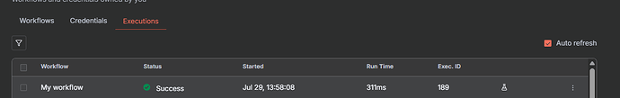

This is actually weird. I just made this on the go and it works normally. The trigger is set up to poll every minute. I sent myself an E-mail to test from another gmail of course and yes the output is right and the data flows perfectly.
You said the trigger is not working at all. If it was a credentials error it would’ve returned an error in the executions tab. This sounds like a mystery. But my guess is that there is an another trigger in your workflow because when I added an another gmail trigger the workflow did not work at all just as you described.
