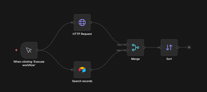

Below is the workflow image.

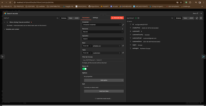

And these are the configurations that I did to get expected outcome. From what I have learned till now from the course, I have applied almost every attempt but I am not getting the output.
Before this workflow, there was another Workflow 1: Merging data where I succesfully got all the expected output, and the same table customers I need to here also.

Thus usually happens because Merge node is trying to match on fields that do not have identical names or data types.
Here is what to check for:
-Make sure both inputs are using the exact same field name (“customerID→customerID” vs “customerId→Customer ID”)
-Check to make sure both fields are the same type - don’t match strings with numbers
-Verify the Merge node is set to “Merge By Fields” (not Append or Multiplex)
-Check the Airtable node is returning all records, not a limited page
-Inspect each node’s output to confirm the customer IDs actually overlap
A quick fix is to add a “Set” node before the Merge and rename/convert the ID fields so they exactly match.
It is likely a mismatch issue rather than a workflow logic issue.
I checked both the output and its the exact same field name “customerID” no changes in it.
