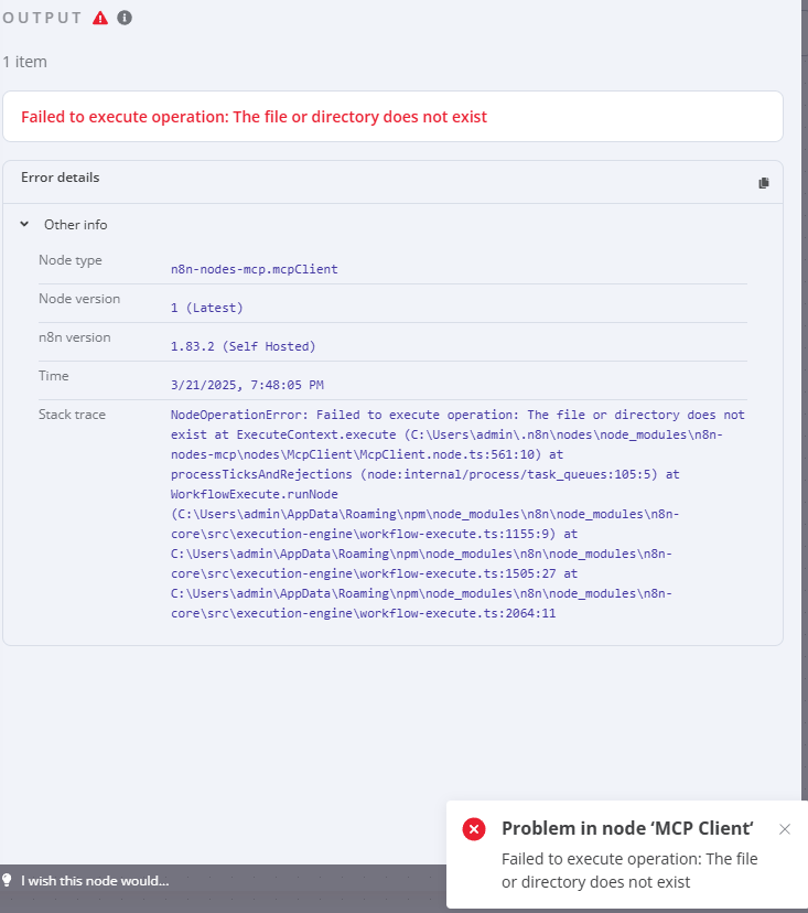

Preformatted textNodeOperationError: Failed to execute operation: The file or directory does not exist at ExecuteContext.execute (C:\Users\Risin.n8n\nodes\node_modules\n8n-nodes-mcp\nodes\McpClient\McpClient.node.ts:561:10) at processTicksAndRejections (node:internal/process/task_queues:105:5) at Workflow.runNode (C:\Users\Risin\AppData\Roaming\npm\node_modules\n8n-workflow\src\Workflow.ts:1394:8) at C:\Users\Risin\AppData\Roaming\npm\node_modules\n8n-core\src\WorkflowExecute.ts:1173:27 at C:\Users\Risin\AppData\Roaming\npm\node_modules\n8n-core\src\WorkflowExecute.ts:1894:11Preformatted text
I am getting this error in using n8n-nodes-mcp
I’m trying to run Puppeteer MCP on the N8N, it works normally up to the MCP node with operation List Tools, but on the next MCP node with operation Execute Tool it gives this error. Can anyone help me solve it? I’ve tried a lot of things and it still gives this error.
In this case, I asked it to access google, then the AI Agent node executes the first tool that has the operation list tools, but when it executes the tool that has the operation execute tool, it gives the error.
Failed to execute operation: Operation not permitted, make sure you have the right permissions

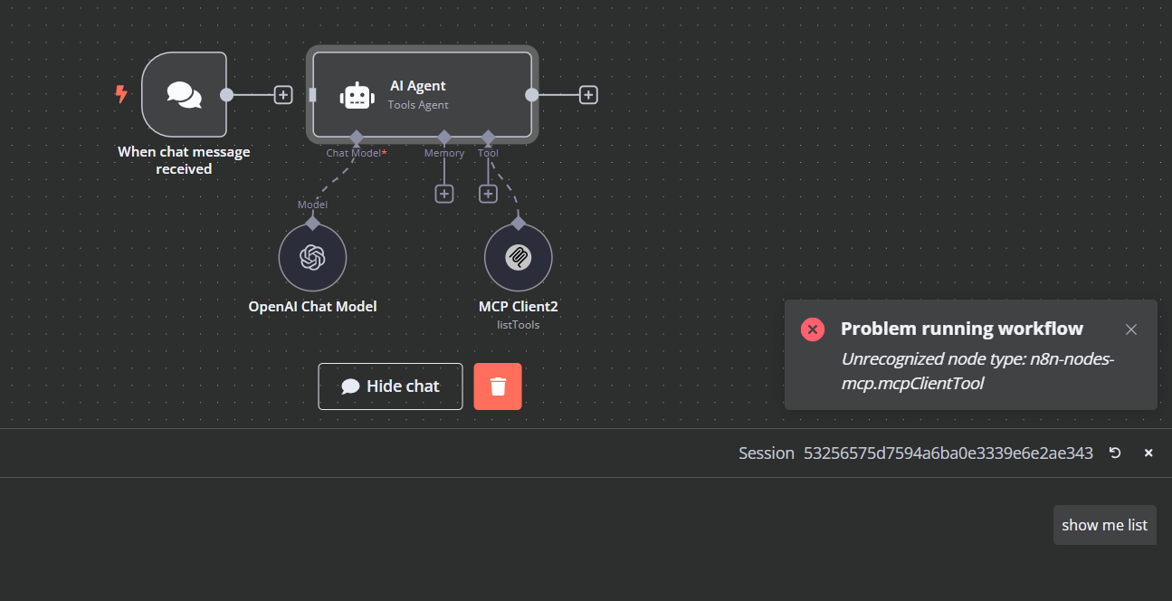

Thanks but I’ve been threw this documentation and I really don’t understand what’s happening I’m still trying to fix this issue after hours of research…
I have the exact same issue. The MCP node in itself is working as intended when used on its own, meaning that the env variable is correctly set. But as soon as I connect the node to the AI agent in the tool section, I have the same error “Unrecognized node type: n8n-nodes-mcp.mcpClientTool”.
I don’t really understand what is going on
Hi,
I installed N8N on my local machine and follow all the steps when connect MCP client tool and setup fireCrawl and run it through me error
I am getting the error Unrecognized node type:n9n-nodes-mcp.mcpClientTool
I am using updated mcp node
Above are my settings, can any one help me to resolve this please.

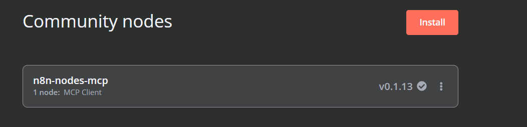

Still have the trouble? I was able to easily integrate it just by following the instructions here: n8n-nodes-mcp - npm
And that in the Hostinger’s terminal you just configure your docker-compose.yml thru: nano …/root/docker-compose.yml
And you just add this environment: - N8N_COMMUNITY_PACKAGES_ALLOW_TOOL_USAGE=true
And you may refresh your n8n and wait till MCP Client appears in the list.
I get the same error on testing the MCP Client tool in the self hosted in Windows. I have tried same in self hosted docker instance, hope it is linux version, hence it worked without any issue. I believe the issue is with the windows n8n installation. I see the installed directory structure is different.
Would appreciate if the development team or others using windows confirms it is successfully configured in windows. Thanks
