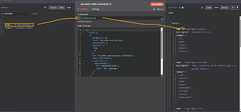

This is my testing workflow

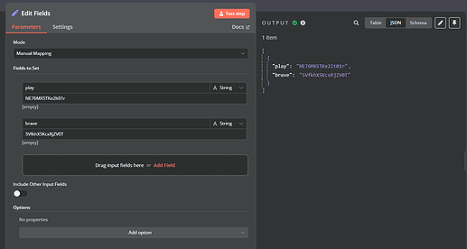

In Edit Fields node are IDs of credentials of my MCP servers

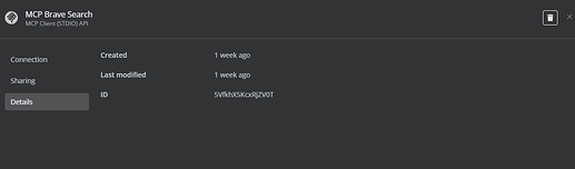

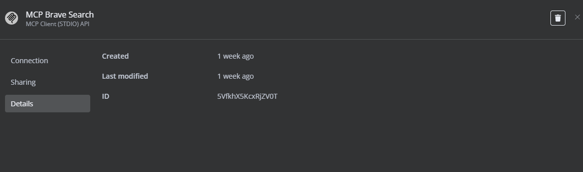

The IDs are in details

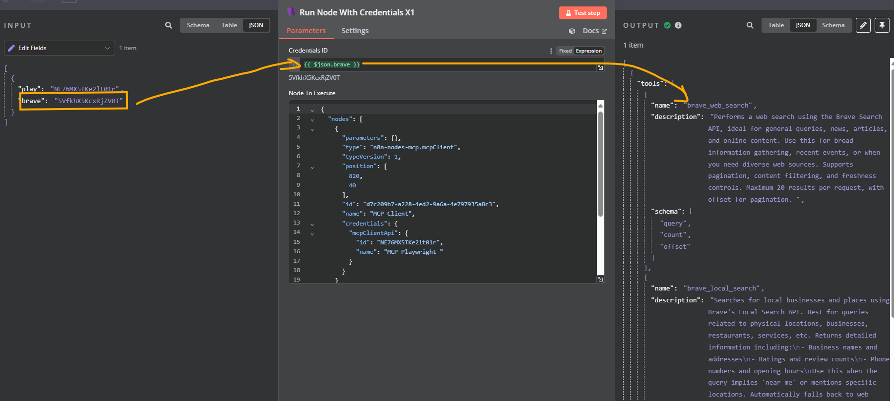

Then in node Run Node With Credentials X1
  1. Credential ID - I use one from Edit Fields {{ $json.play }} or {{ $json.brave }}
  2. I just use control-C (i use win11) on node MCP Client then control-V to Field - Node to execute in Run Node WIth Credentials X1 – this will paste the json of MCP node ther.
Then you can just run the workflow (the MCP node is ignored) and it produces list of tools of either {{ $json.play }} or {{ $json.brave }} MCP.
The credentials are defined as expression therefore you can do any number of things with it.
Naturally this works for Execute Tool also. And therefore allows usage of just one node to list tools and execute tools on MCP server chosen as expression.

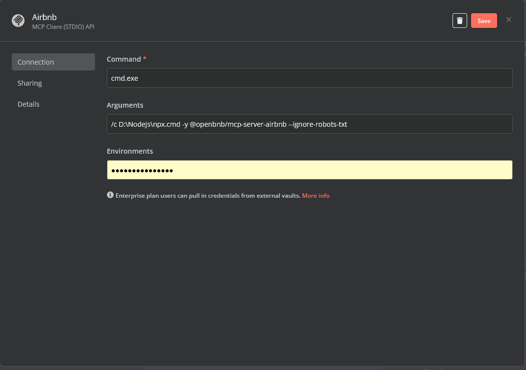

I think my solution is not the best way. However, you can solve the problem.
[Airbnb MCP Server Installation]
  1. npm install -g @openbnb/mcp-server-airbnb
  2. npm -g root
    example - “C:\Users\[User Name]\AppData\Roaming\npm\node_modules”
  3. cd “C:\Users\[User Name]\AppData\Roaming\npm\node_modules”
  4. copy @openbnb folder
  5. cd “C:\Users\[User Name]\.n8n\nodes\node_modules”
  6. paste @openbnb folder
  7. n8n start
