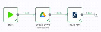

Hi @Gregory_CHAURAND, by reading PDF file I assume you want to use the Read PDF node, right?
If so, Google Drive should work just fine. I’ve tested this on n8n.cloud by uploading a PDF to Google Drive, then running the below workflow on n8n.cloud:
Example Workflow
The file downloads just fine and the Read PDF node can parse the content:
Could you perhaps share some more details of the problem you have encountered when testing this?
Hi, thanks for the help, I just spent a little time figuring out how to find the id of a pdf file on the drive but it works fine. Thanks again
