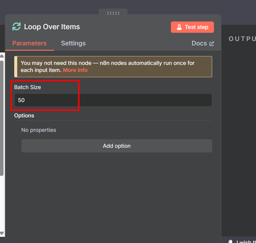

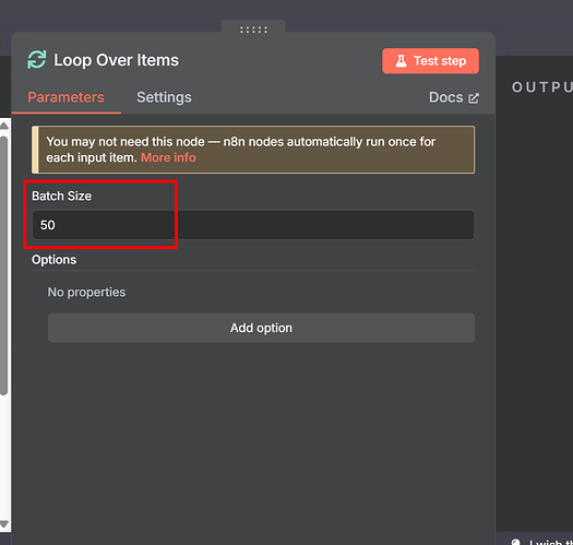

1. Use the “Split In Batches” node
Set the batch size to 50. This lets you work with your data in chunks, giving you better control over how much you’re sending to the AI and to Sheets in each loop.
