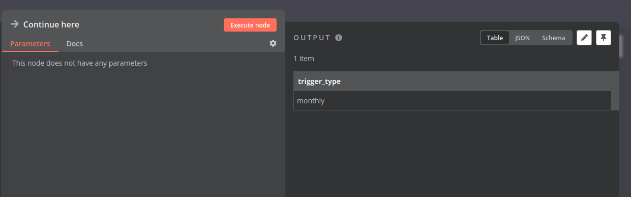

Hi @jmr123, a simple workaround would be to have more than one Schedule trigger in the same workflow. You can then run a Set node between each individual node to attach an additional field with the information you’re looking for. Like so:
After the “Continue here” node you’ll now have a trigger_type property telling you which trigger started your flow:
Thanks for this. And then add a switch after the set to determine which next set of nodes to trigger?
That depends on your exact requirements, but yes, that would be one possible option :slight_smile:
