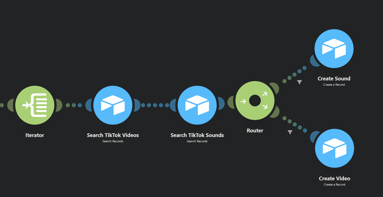

In Make.com the workflow works as shown below.
