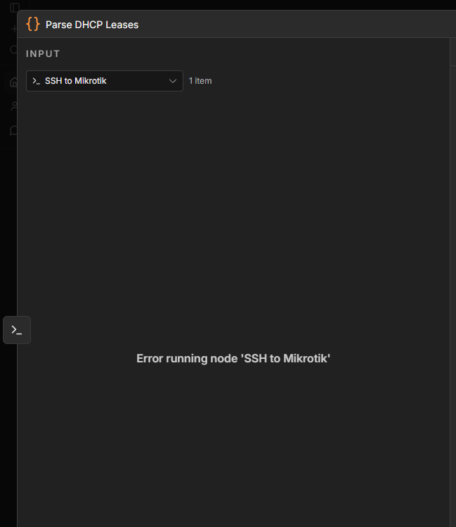

Problem is that SSH node create error: connect ECONNREFUSED, but does’t transfer that error to the next node
Next node only see this: “Error running node ‘SSH to Mikrotik’”, no JSON, TABLE or SCHEMA data.

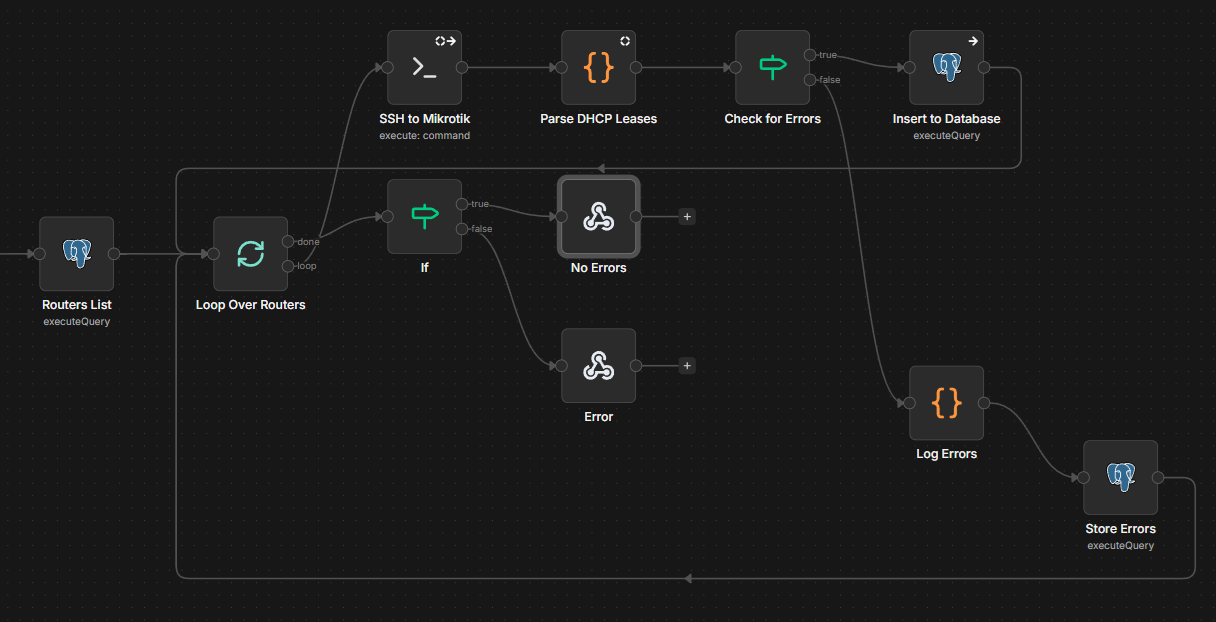

I perfectly understand why this error happened, in this case SSH service was disabled on router. My goal is to pass error information to the user through Respond Webhook, log error information into database…

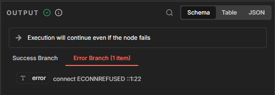

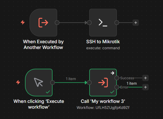

In this case, I would wrap the SSH node inside a sub-workflow, then configure the Execute Sub-workflow node’s On Error setting to Continue (using error output),
This way, you’ll get the connection error in the Error branch, as shown here:
And the sub-workflow approach looks something like this:
