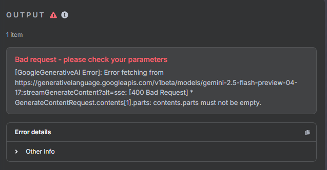

This works for the first message, but if you’re using chat memory it’ll start to break. Look after the second message:
