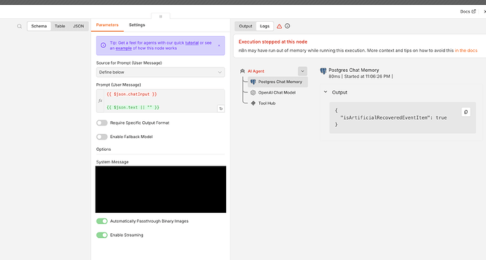

With response streaming enabled, if the client disconnects (browser refresh) while the AI Agent is still streaming, the execution is aborted and shows { “isArtificialRecoveredEventItem”: true } with “Execution stopped at this node.” I’d like the execution to finish server-side even if the client disconnects, while keeping streaming on.

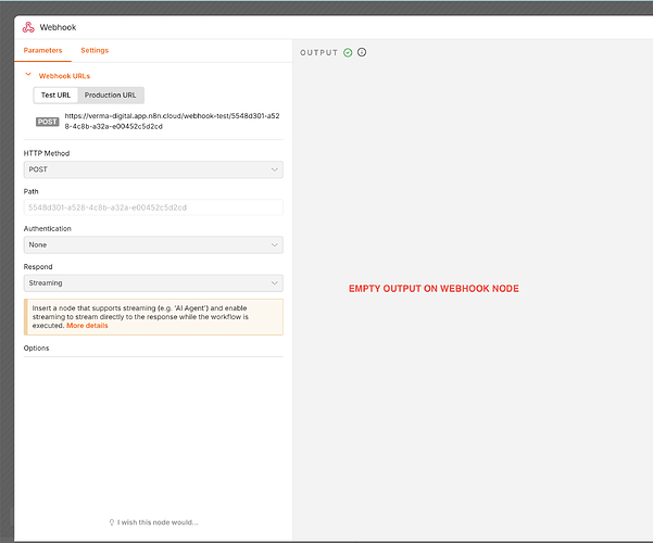

  1. Chat Trigger (or Webhook with Response Mode: Streaming).

  3. Open the execution → it’s stopped, AI Agent output = { “isArtificialRecoveredEventItem”: true }.

  • AI Agent node v3.1, Webhook v2.1 (responseMode: streaming)

  • Disabling enableStreaming on the AI Agent avoids it — but then there’s no streaming (disabling streaming on either node falls back to request-response).

That isArtificialRecoveredEventItem marker is a sign the execution crashed rather than being cleanly cancelled. When the browser disconnects, the TCP socket closes, and the next res.write() call inside n8n’s streaming chunk sender throws an EPIPE error. That propagates up through the LangChain callback chain into the workflow engine, which crashes the execution mid-flight. The recovery service then fills in that artificial placeholder for any node that started but never persisted its output.
So the SSE connection and server-side execution are architecturally coupled in n8n’s current streaming implementation. There’s no config flag to decouple them.
