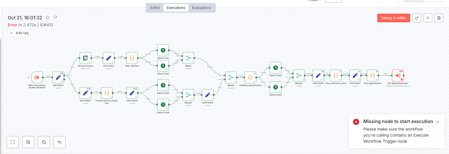

Sub workflow error: "Missing node to start execution - Please make sure the workflow you're calling contains an Execute Workflow Trigger node"
I have a self-hosted n8n v1.115.3 instance (Docker).
Everything was working perfectly — my AI agent used the Call Workflow (Execute Workflow) node to call another workflow called Event_Check.
Then, without any structural change to the workflows, the system suddenly started returning this error:
Please make sure the workflow you’re calling contains an Execute Workflow Trigger node
Since then, the sub-workflow refuses to run.
It had been working fine for weeks with exactly the same setup.

  • Actual behavior: It fails instantly with “Missing node to start execution”.

Observed result
Even though Event_Check starts with a valid “When Executed by Another Workflow” trigger, n8n refuses to execute it, reporting “Missing node to start execution”.
This happens across all versions tested and even with brand-new, minimal workflows.

Simply remove the Call ‘Appointment dev’ final node in the subworkflow.
It will return anyway the response to the main workflow ai agent, together with the intermediateSteps(if you enabled it).
