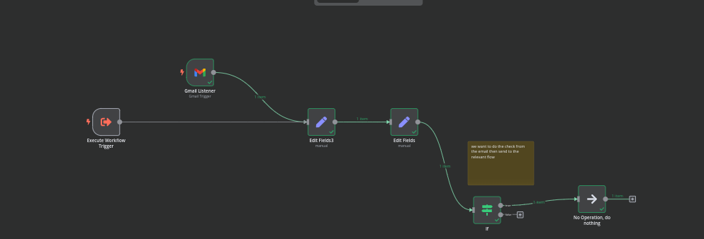

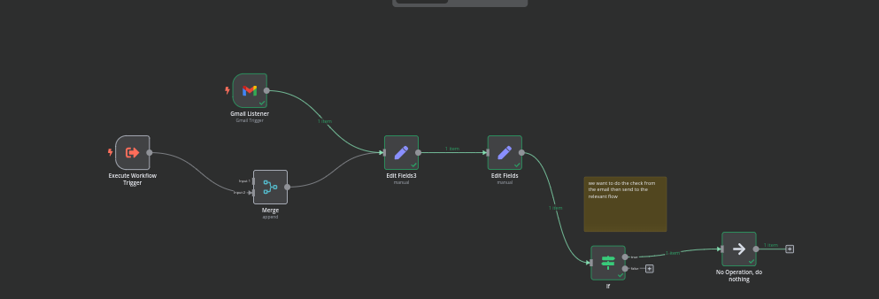

I am trying to implement a gmail listener in a subworkflow. But when I execute the subworkflow, the [when called by another workflow node] doesn’t execute. The gmail listener trigger executes, and if I check the main workflow the output of the sub-workflow are not passed.

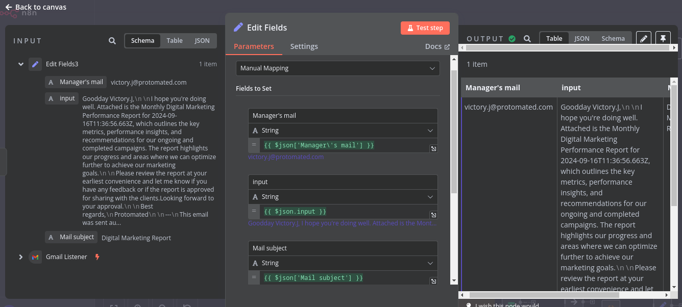

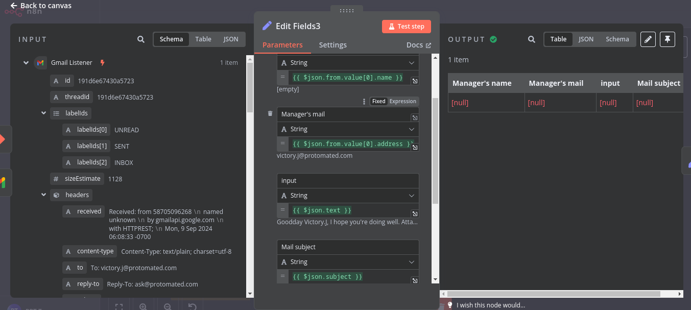

I tried executing both the [when called by another workflow node] and the gmail trigger it gave null as an output
It’s not giving any error message

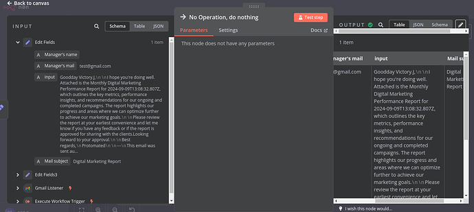

The output returned by the last node- when I execute the triggers manually
The output of the last node when I use the execute button

A workflow is always triggered by one trigger. What you are doing here is a bit weird, as you expect 2 triggers?
I think you want to execute a subworkflow within your workflow that is triggered by gmail. So you need the normal Execute workflow node and trigger a subflow with that.
I am not certain what you want to do here, so explaining that would help us help you. Also could be worth it doing the courses to get more knowledge on how n8n works.

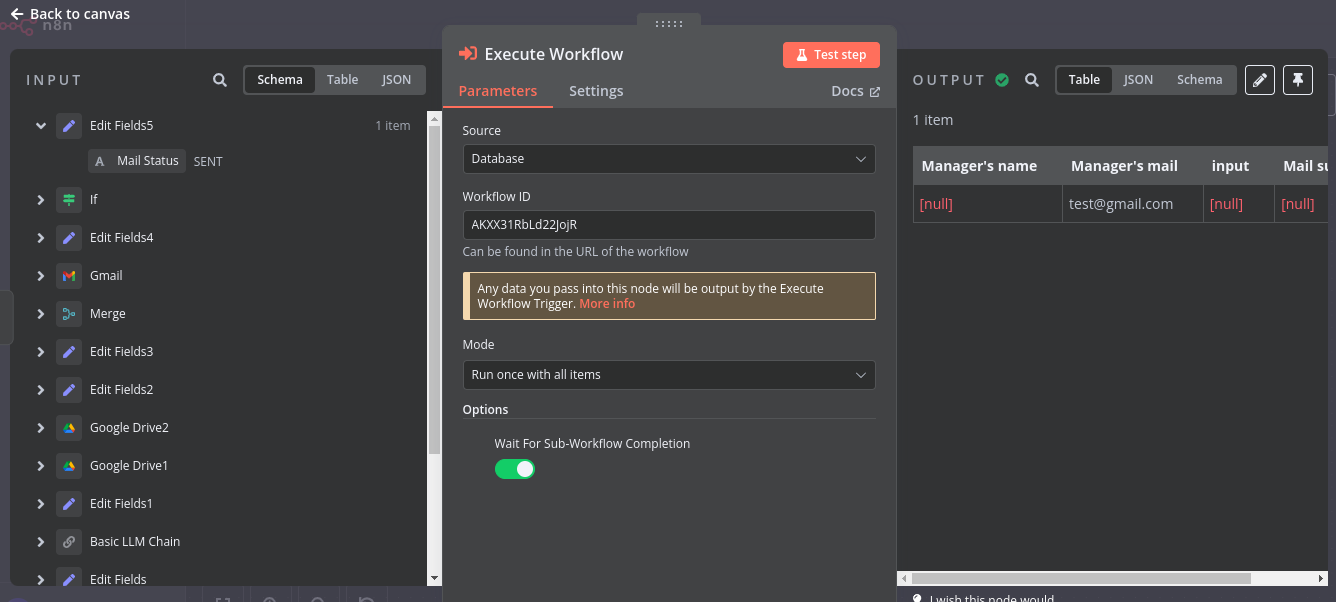

You are correct @BramKn I want to execute a subworkflow within my workflow. I tried using only one trigger for the subworkflow, but the output doesn’t get passed to the main workflow.

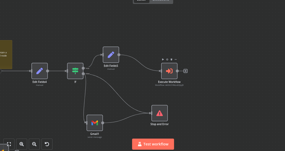

The image above is the main workflow.

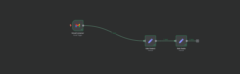

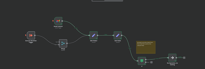

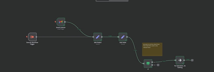

Below is an image of the subworkflow.

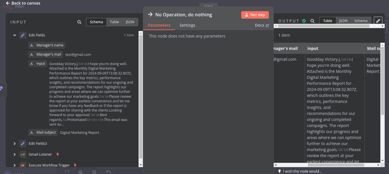

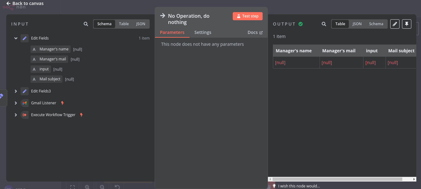

Here is the output of the last node in the subworkflow :

From the screenshot, you can see the output of the last node in the subworkflow is not passed to the main workflow’s execute subworkflow node
Hi @vctry
I think you are misunderstanding something here.
A subflow can never start with a gmail trigger.
It will always start with an execute workflow trigger.
