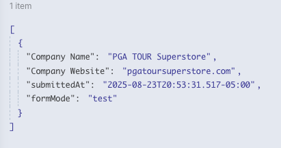

Pretty basic- user submits a form with Company Name and Company Website. Those parameters are passed to a sub-workflow where I have a handful of OpenAI queries running in parallel.
The form works fine, here is the output

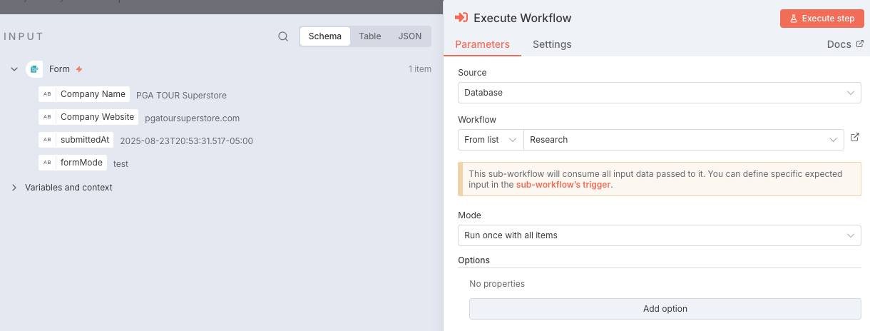

And then I have the Execute Sub-workflow node set up this way.

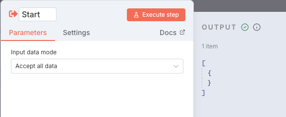

But then, inside of the sub workflow, I can see no data is passed through, which kills my OpenAI prompts which leverage those variables from the form.
Certainly, I am doing something wrong here, but the UI is telling me that all data is passed through automatically. What am I screwing up?

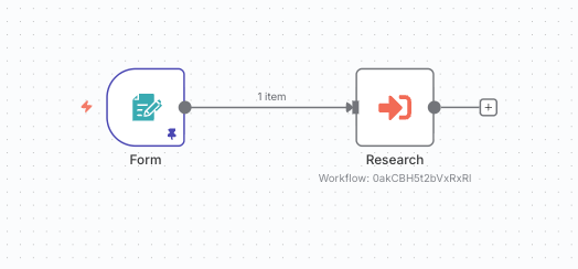

Thanks @mohamed3nan! So, this is hooked up correctly I believe. My primary workflow is called Account Research and my Sub-workflow is called Research, and I am plugged into Research.
I tried the other way around but got an error. So I believe this is correct.

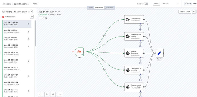

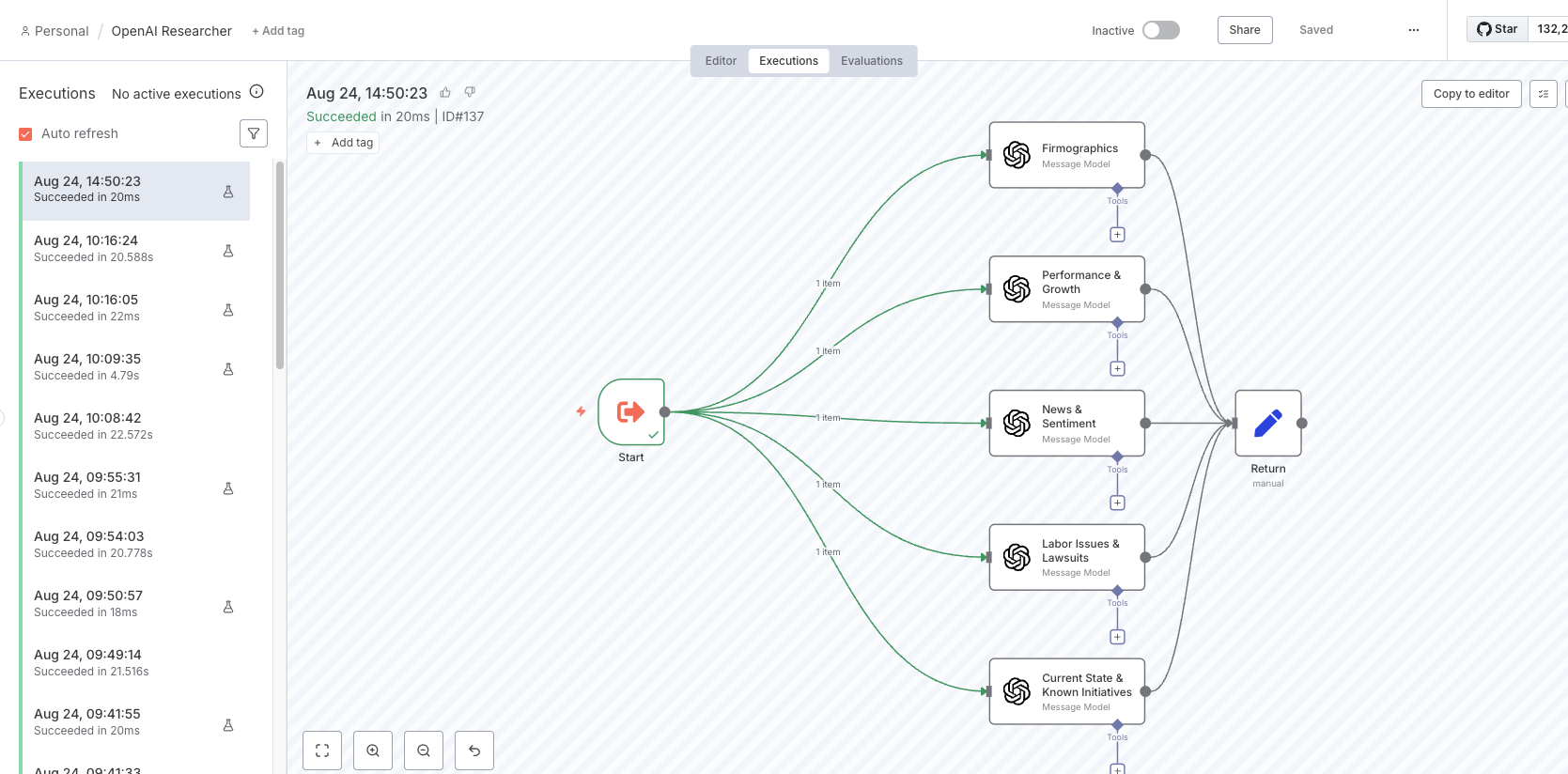

Now, in your subworkflow “Account Researcher”, when you click on the “Execution” tab, do you see the last execution? And is there no output shown there?
@mohamed3nan all green! See image below.
Workflows are successful, just not passing the data through, so OpenAI returns an incorrect result. You can see these json snippets are not working, as the data is not passed through to the sub-workflow as expected.

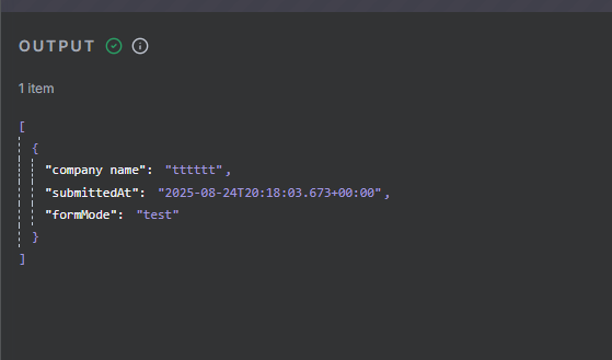

Also, make sure to remove any pinned data, clean the workflow, save, and try again.
Hey @mohamed3nan tbh, not sure what it did, but it seems to be working now. Ill wrap this up and test and will report back! Thanks for your help, hopefully this is resolved!
