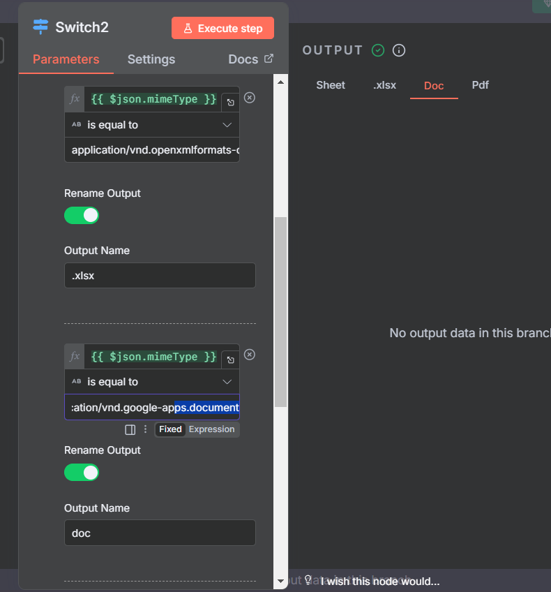

I successfully transfer google shield and pdf file, but doc does not see. Switch settings are shown in the image. How to set up the is equal to field correctly so that switch transfers the document ID further through the nodes?

what is the full Mime Type you’re using for doc, it’s not clear from the screenshot,
can you please try this one:
application/vnd.openxmlformats-officedocument.wordprocessingml.document

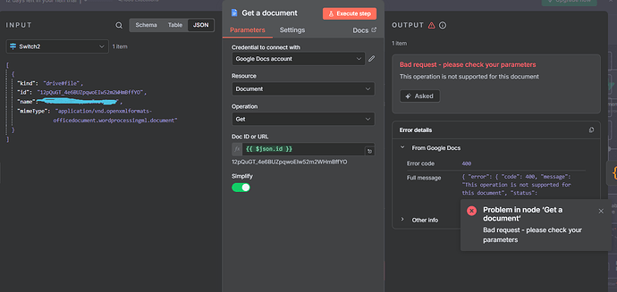

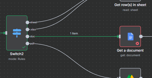

Oh yeah pal, it works and Switch sees that it’s a doc file. But after that I have another problem: doc node can’t get file by id, even though id is correct. Before your answer I had this mimeType for GoogleDoc - application/vnd.google-apps.document. What should I do to fix this problem? Check images please <3

Now from the new screenshots, the Bad Request error..
Are you sure you’re the owner of the document?
Also, is the Google Docs account credential working?
Can you test it with a normal file to confirm that it works?
Thanks for your attention @mohamed3nan ! I solved this problem, for application/vnd.google-apps.document i downloaded word document which I made in windows, not google doc. That’s why there was an error. Now everything works fine for me and node passed to supabase successful. Thanks again for help with this issue!
