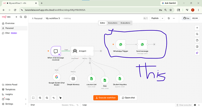

The WhatsApp Trigger is not executing when I send a WhatsApp message

i am following this video and did the same as in video whole flow is fine but nothing happened same situation.

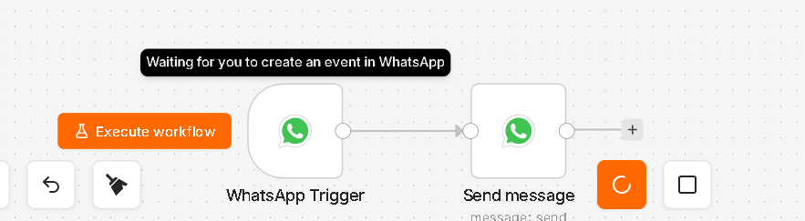

check and follow but nothing N8N WhatsApp Trigger not working

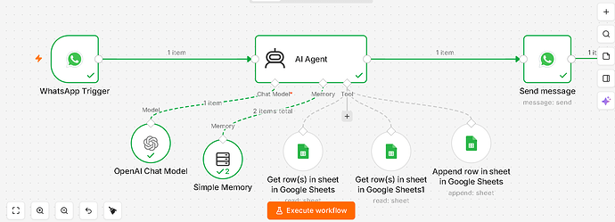

thanks everyone for the kind suggestion i have fix the issue I solved my WhatsApp Trigger issue in n8n after realizing the problem was not the credentials. Even though the credentials were showing green, the WhatsApp app was not properly linked with the WhatsApp Business Account and phone number in Meta.
First, I verified the App ID and Secret in Meta Developers and n8n. Then I used Meta Graph API Explorer to check the phone_number_id/subscribed_apps endpoint. The response was empty, which confirmed the app was not connected.
After changing the request method from GET to POST and running it, the app linked successfully. Then the WhatsApp Trigger in n8n started working correctly.
