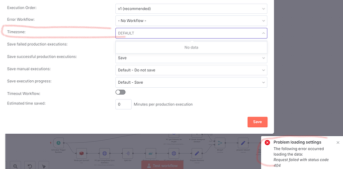

Hi, ihave the problem that no timezones are visible in settings.
After try to set timezone i get an 404 Error message.
Where i can find a solution ?

Ehy, welcome!
If you just need to set a timezone manually for now, you can do it via the GENERIC_TIMEZONE env variable:
In your Docker .env file or compose config:
GENERIC_TIMEZONE=Europe/Berlin
Then restart the container.
Lmk how it goes, cheers!
Why this is not fixed ? It comes 404 Error.
