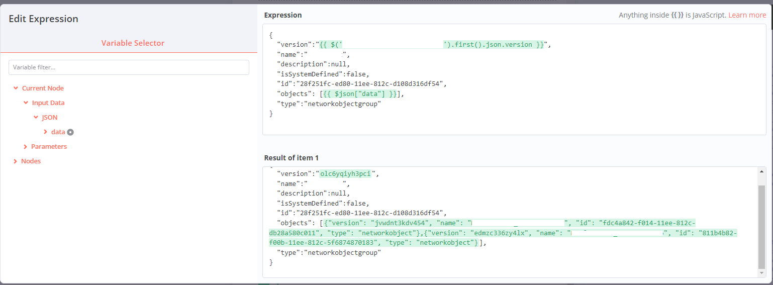

I want to add an array object into http-request node, like the below image
I tried with "objects": [{{ $json["data"] }}], and [{{ $jmespath($('Merge').all(),"[].json")}}] but the error is about JSON parameter need to be an valid JSON

and the body of HTTP-Req should be in json format like this:
  "version":  {{ $('3-nodes-back').item.json["version"] }} ,
  "name":"vicGroup",
  "description":null,
  "isSystemDefined":false,
  "id":"28f251fd-ed80-11ee-812c",
  "objects": {{[ $jmespath($('Merge').all(),"[].json") ]}},
  "type":"networkobjectgroup"
the objects attribute must be an array of object. Using jmepath return like this "object": [ {obj1},{obj2} => it missed the ] (closed bracket)
