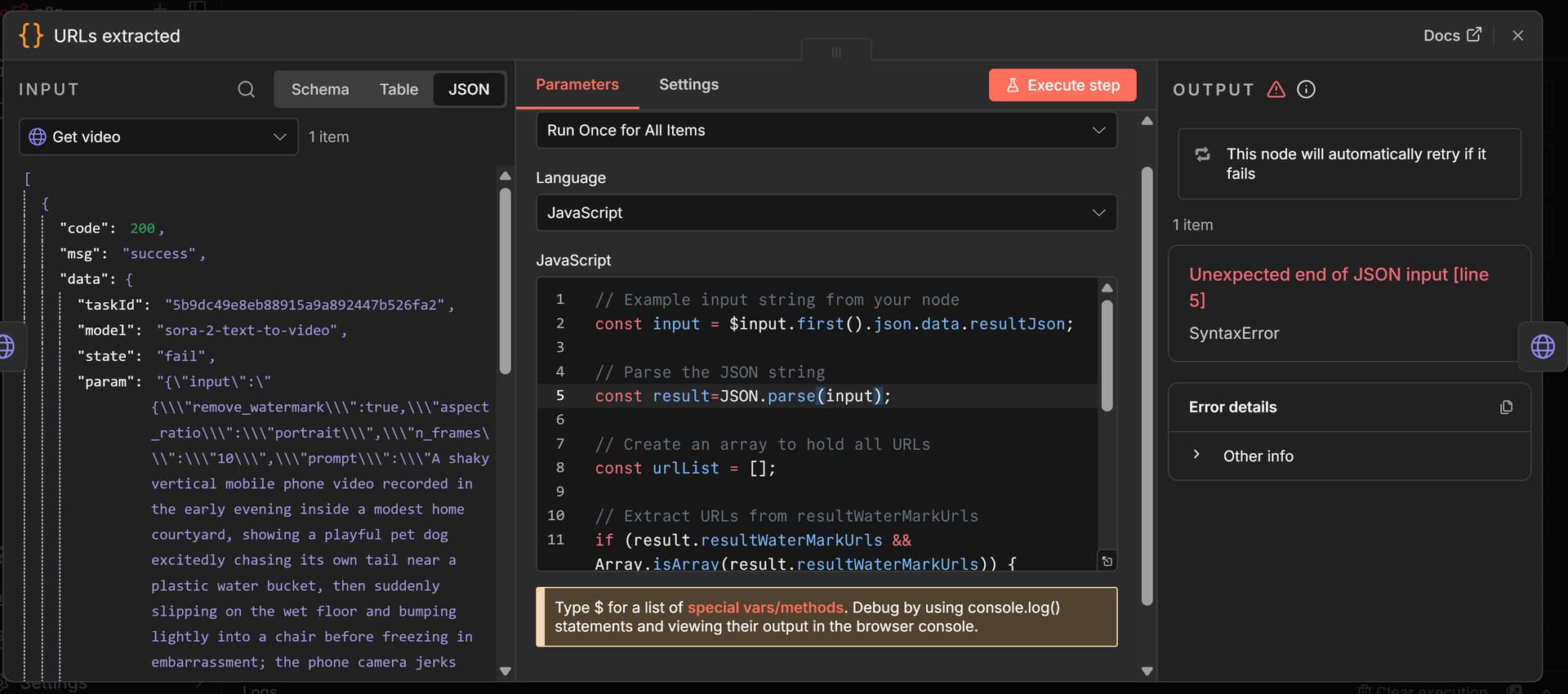

URLs extracted Error
Unexpected end of JSON input [line 5]
SyntaxError
Please provide the solution
Error detail

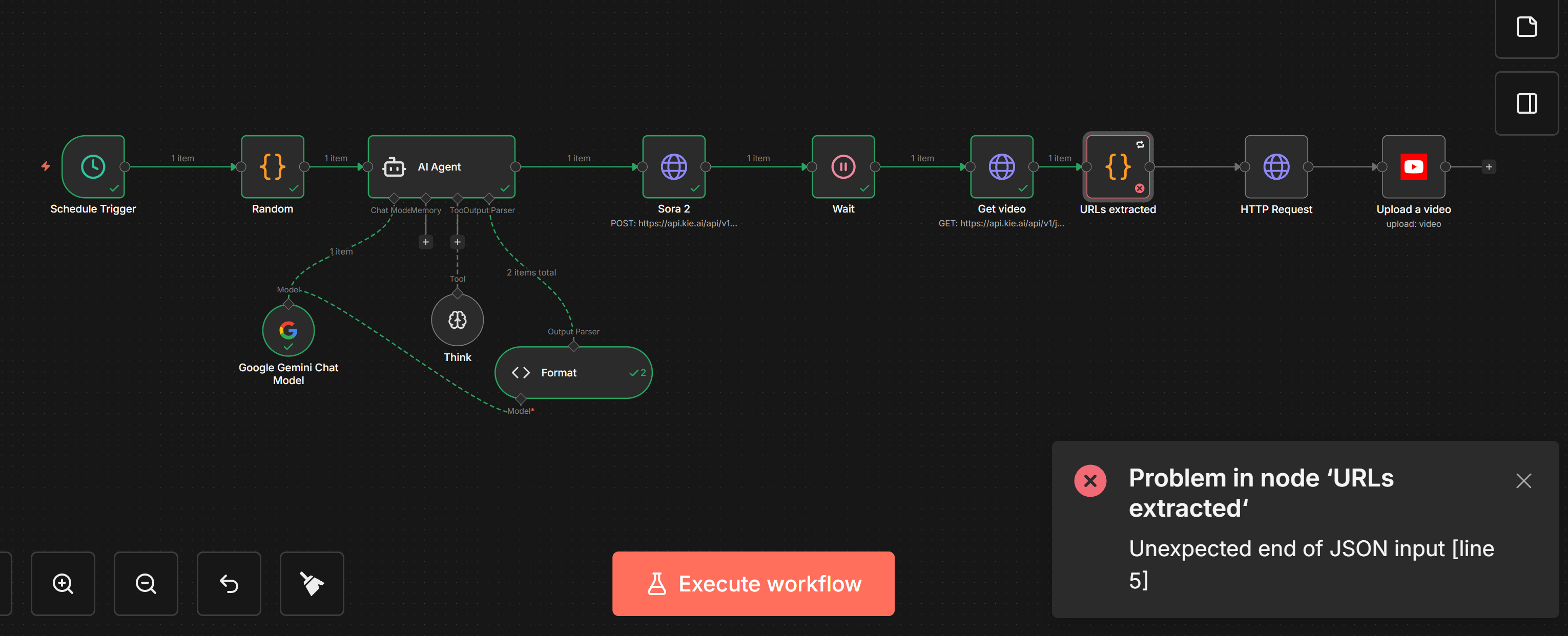

Hi @Usman_Naz ,

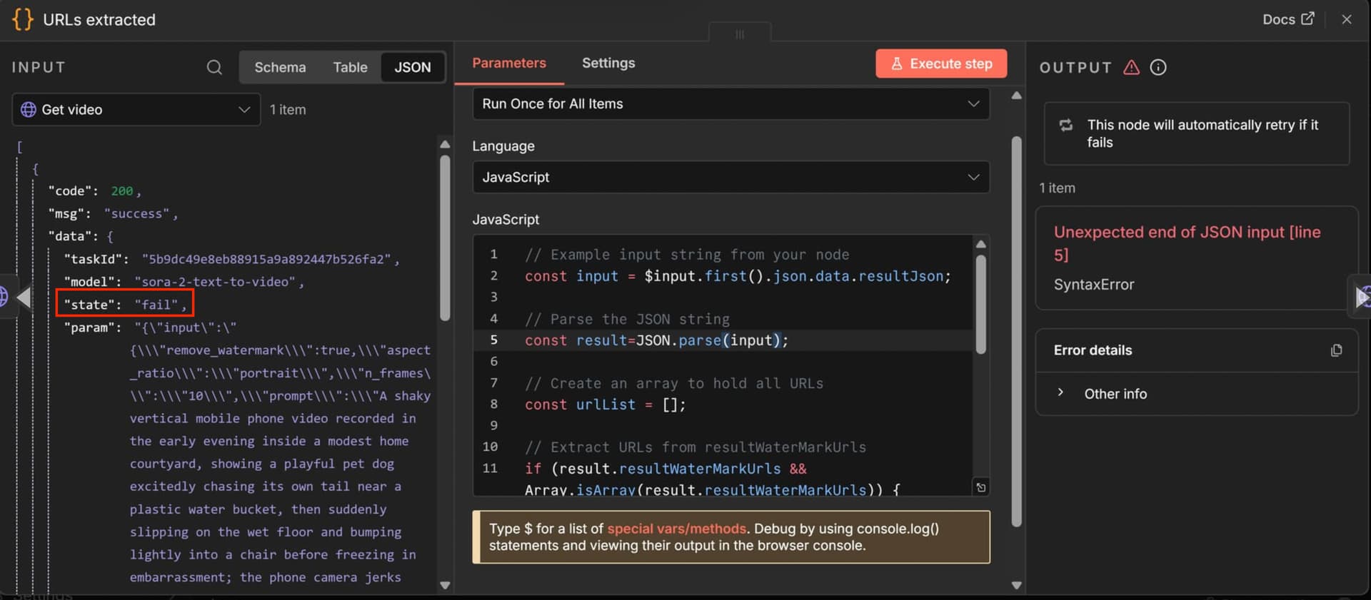

It looks like in your instance the Sora rest call states that it failed for some reason. Since your code node for getting the urls expect a certain format in the variable you’re pulling it is failing. Add an If statement to check for success values as this worked for me when testing. Now just handle the failed instances
In your instance the state is “fail”, which means the “resultJson” property you’re referencing is probably missing during failed states
