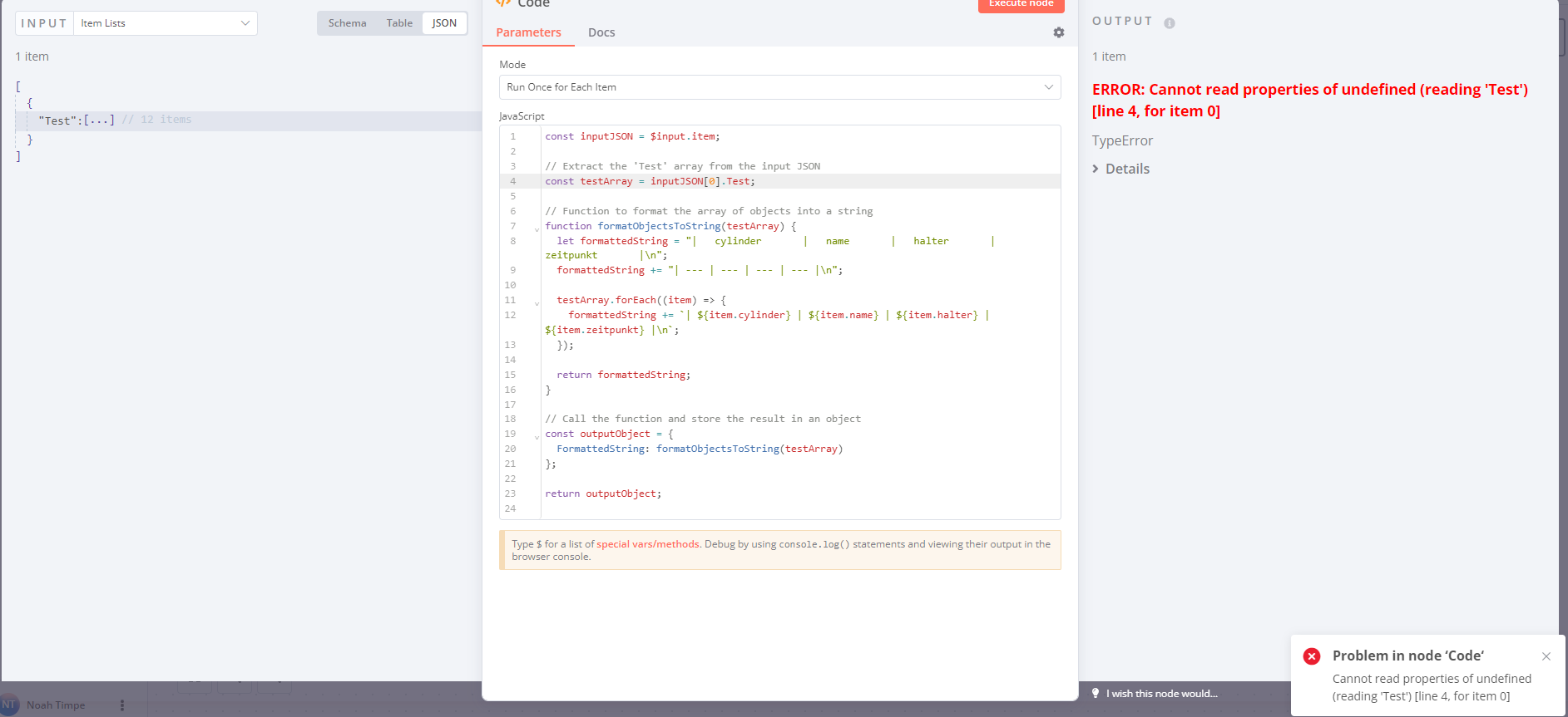

Hey all,
I have a code node that should transform the input as shown in the first picture if i hard Code the Input that works withput a Problem.
However, using a variable ($input.item) as the Input results in a ERROR: Cannot read properties of undefined (reading ‘Test’) [line 4, for item 0].
What am i doing wrong?, if the Code just is
const inputJSON = $input.item;
return inputJSON;
i get the correct Input as Output as i would othwise hard code it in as seen in the first picture…
How do i corectly refer the Input ?

Hey @N0ah ,
if your code is running in mode Run Once For Each Item the $input.item won’t be an array, it will be an object.
Can you try using const inputJSON = $input.item.json.Test?

Hey @marcus ,
thanks for the quick answer, sadly that also doesnt do the job and returns a
“ERROR: Cannot read properties of undefined (reading ‘forEach’) [line 11, for item 0]
TypeError”

after consulting it again with a fresh mind and some trial and error we came to conclude that it works with Run Once for Each Item and:
// Extract the 'Test' array from the input JSON
const testArray = inputJSON.json.Test;
Thanks a lot for the help !
