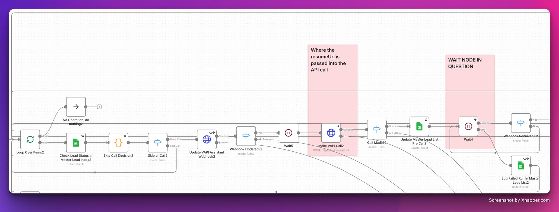

I can’t share the automation in this post because it says I go over the character limits, but here is a picture of the section of the workflow that houses the wait node

Important to note - What I built is a monolithic workflow. I know most people separate their workflows into two pieces for these types of builds … The first flow initiates the call, the second flow usually starts with a webhook and receives the end of call data. However, for those of you on a cloud hosted plan the two workflow approach doesn’t bode well for your monthly execution limits. This is because with that approach you’re, at a bare minimum, doubling the amount of monthly executions you’ll have.
The automation I built handles the call initiation and the end of call digestion all in one. To make this possible I used a wait node that resumes on a webhook call somewhere near the middle of the workflow (this node is what accepts the ‘status update’ or ‘end of cal report’ webhook from vapi). The webhook being called isn’t a static webhook like you’re used to seeing inside the webhook trigger node, but instead it’s the execution specific webhook which looks like this: {{ $execution.resumeUrl }}. When you send this over in your Vapi API call that actually makes the call (see the sample JSON body above), it changes the webhook destination to that particular executions wait node (assuming the wait node is configured to resume on webhook call).
After the wait node, you just need a simple switch node that determines what kind of webhook was received. And, depending on what webhook was received, you either loop the output of the switch node back to the wait node so that it resumes waiting for the correct type of webhook response, or you move it into another Vapi api call that retrieves the end of call report for that particular call ID.
Here’s a picture of what that flow looks like:

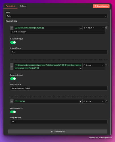

And here’s a picture of the configuration for ‘Webhook Received?’ switch node:
Since both the ‘end of call report’ and ‘status update’ webhook responses have the call ID this switch configuration makes it so that whatever passes through the ‘Yes’ and ‘Status Update - Ended’ arms will successfully be able to get the end of call reports from the downstream “Get End of Call Report” HTTP nodes.
