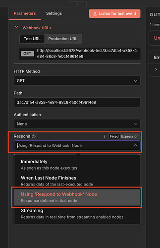

Hey @danipiace68 !
Welcome to n8n community!
Can you share the workflow like this?:
glxgzrh0
I think your Trigger uses a response mode where the “Respond to Webhook” node is not needed, or you are using it in the wrong place…
Cheers!
Hi @danipiace68,
You need to change the Webhook Respond property from Immediate to “Respond to Webhook”. Also move your respond node to be the last node called in your workflow as it is useless to respond as the very next step.
