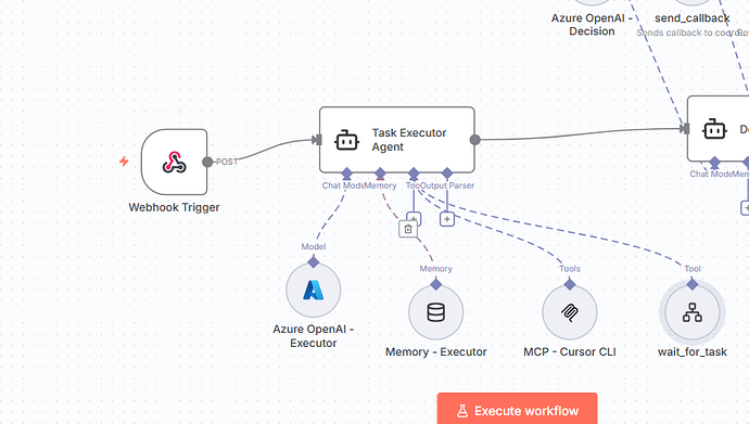

option 2: sub workflow with n8n Workflow Tool
tool:

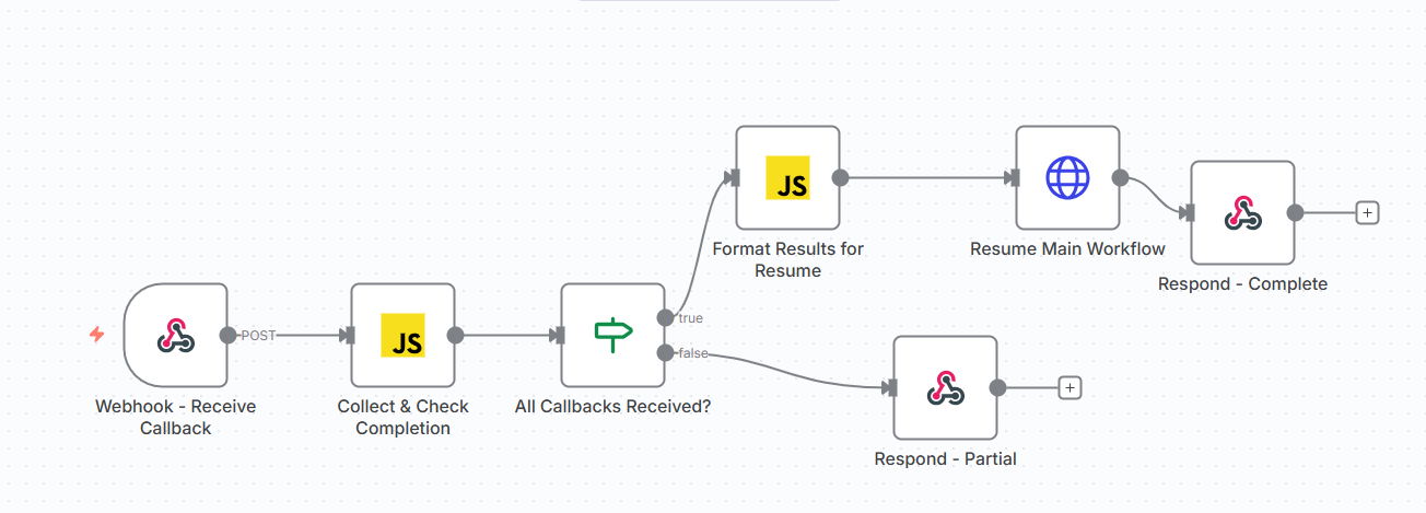

Callback Coordinator - to collect all tasks:

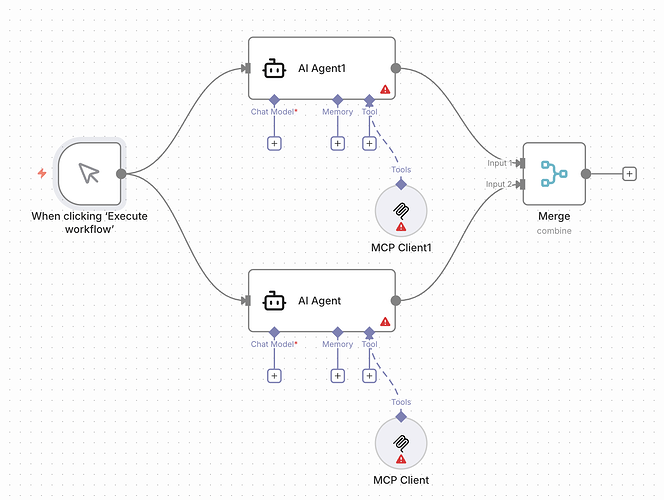

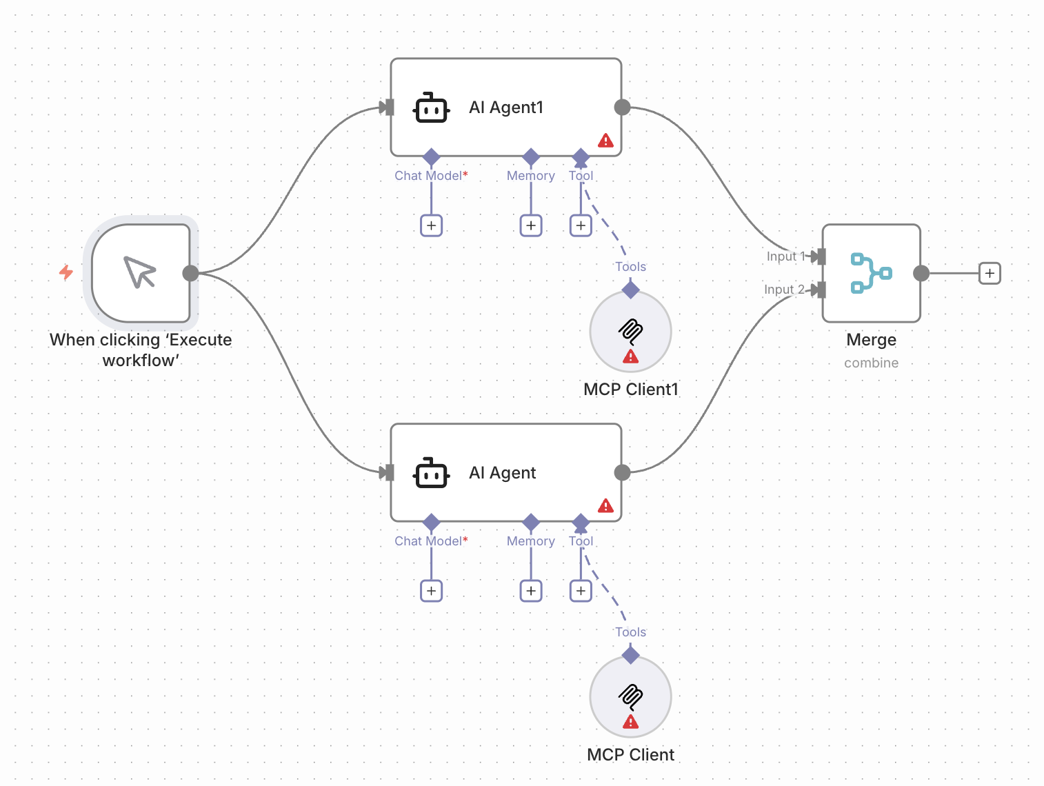

To wait for all calls to finish before continuing you can put them on separate branches and then merge the branches at the end using a ‘merge’ node. Note however that branches in n8n are executed sequentially so you won’t get any parallelisation.

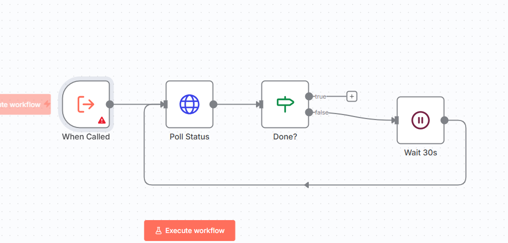

  2. best way to run a long process, maybe return immediately taskId and then poll the status with wait until complete? I’m search for something better if you know…

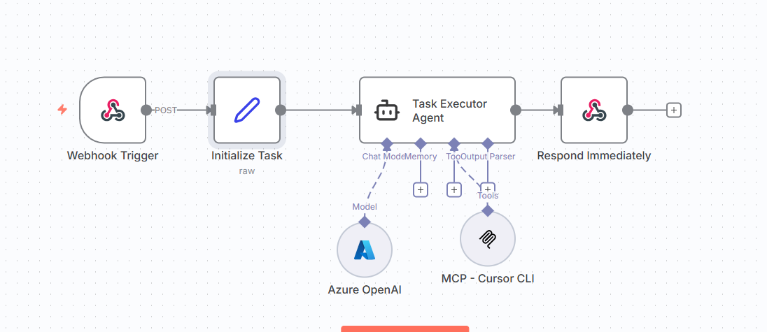

main workflow that trigger sub workflows:

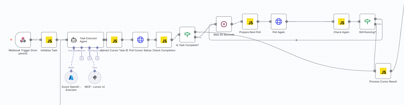

sub workflow that using mcp get the taskID and then loop until finish

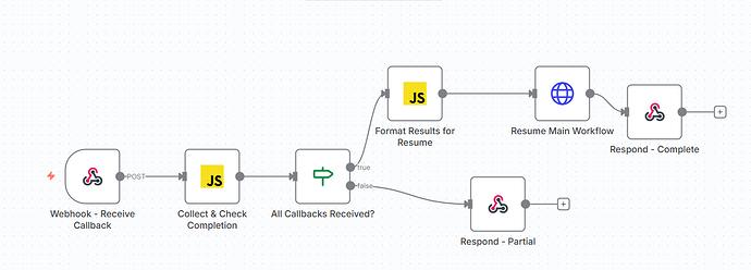

You might need aggergator workflow, which will collect all responses and call resume url once to resume main workflow.
Thanks for your answer,
  • regarding the parallel tasks I collect them with Callback Coordinator workflow that resume the main workflow when all task finished
There is a better way to know when all the tasks completed?
  • Reg the long process I tried something like this:
    sub workflow with n8n Workflow Tool that response auto when complete
Tool - Poll Task Until Complete
but it is also using wait node, maybe there is a way without “wait”?
or this is the recommendation solution for long process case?

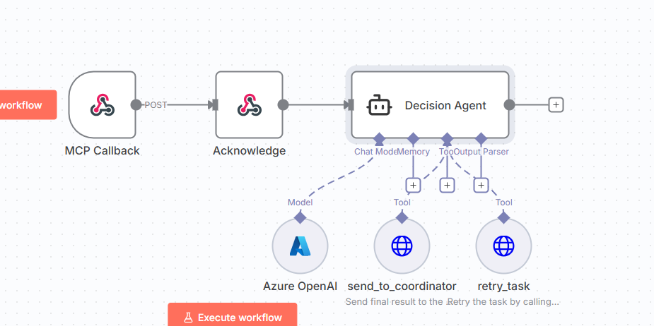

Another option to solve the long process is by callback when the long process is completed
sub agent call the mcp (long process)
callback from the mcp when done:
n8n guys, What is the recommendation solution?
