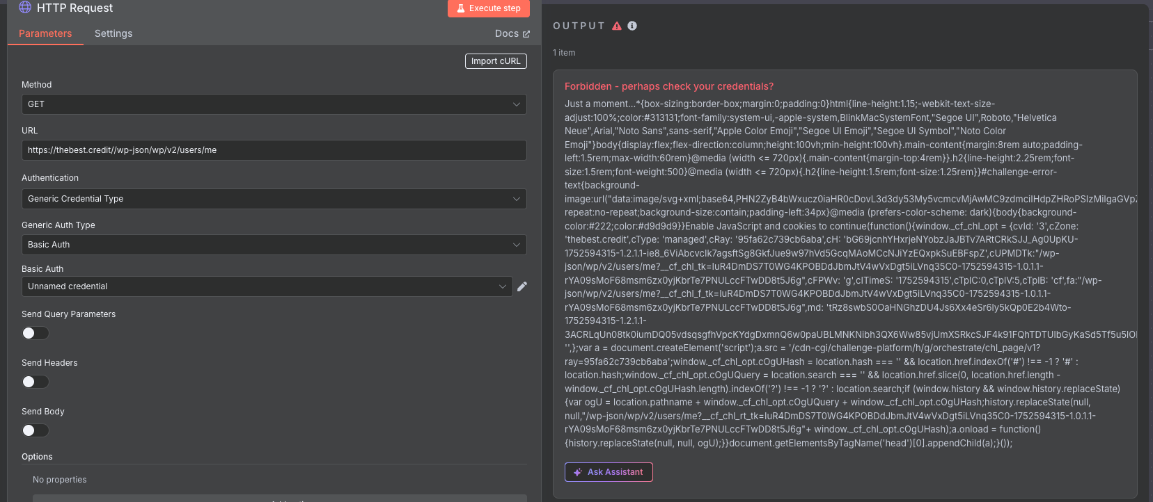

WordPress API credentials suddenly stopped working. They were fine for many months. Before anyone comments, I’m using the application password and not the regular password to connect.
  • **n8n version: 1.99.1
  • **Database (default: SQLite): SQLite
  • **n8n EXECUTIONS_PROCESS setting (default: own, main): own
  • **Running n8n via (Docker, npm, n8n cloud, desktop app): n8n cloud
  • **Operating system: n/a
It works fine through Postman, but I’m getting 403 with a HTTP Request Node
  1. Switch your HTTP Request node to true “Basic Auth” mode
  • In “Authentication” choose Basic Auth (not “Generic Credential”)
  • Enter your WordPress username and application password in the dedicated fields
  • Leave Send Query Parameters and Send Headers off
  1. Disable redirect-following (WordPress sometimes returns a 302→login page before the 403)
  • Under Options, set Follow Redirects to Off
  1. Re-run the node
  • You should now see a clean 200 with your user JSON rather than the Cloudflare/WordPress HTML challenge
By using the built-in Basic Auth mode (which pre-sends the Authorization: Basic ... header) and preventing the HTTP client from auto-following the 302→login redirect, you’ll avoid the 403 HTML page and get the proper API response.

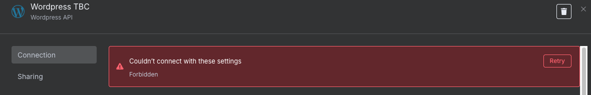

There are only 2 options for Authentication: Predefined Credential Type and Generic Credential Type
Basic Auth option is available only on the Generic Credential Type
I switched to Predefined and chose WordPress API.
neither works :frowning:
Done, but still not working
Found the issue: Cloudflare bot detection :weary_face:
Can confirm: it’s bot-detection.
Though not necessarily Cloudflare. Sometimes your own hoster will think you’re a bot and block you.
