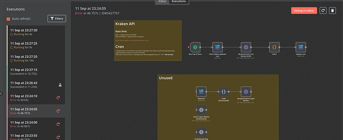

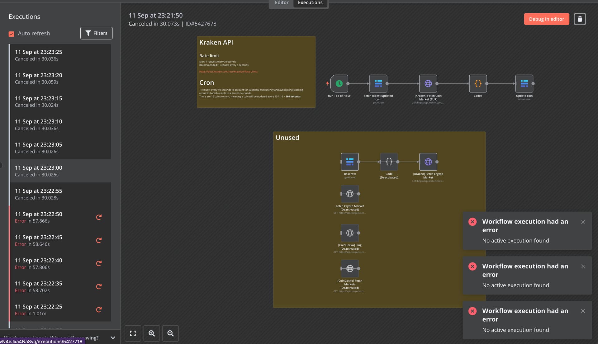

A workflow which I haven’t updated recently and was working fine for months, just stopped working today at 11PM, throwing No active execution found.
The trigger is a cron, that runs every 5s, using */5 * * * * *.
When running the workflow manually, it executes just fine.
After disabling the workfow for 2mn, and restarting it again, it worked again fine. (I tried to stop/start immediately afterwards, and that hadn’t fixed it, only by waiting a few minutes did that solve it)
I’m not sure what went wrong, why, and what to provide to help with further understanding of the root issue.
Error: No active execution found
    at ActiveExecutions.getExecution (/app/code/node_modules/n8n/src/ActiveExecutions.ts:255:10)
    at ActiveExecutions.getStatus (/app/code/node_modules/n8n/src/ActiveExecutions.ts:220:15)
    at /app/code/node_modules/n8n/src/WorkflowRunner.ts:336:49
    at processTicksAndRejections (node:internal/process/task_queues:95:5)
There is no output, the first node doesn’t even run.
