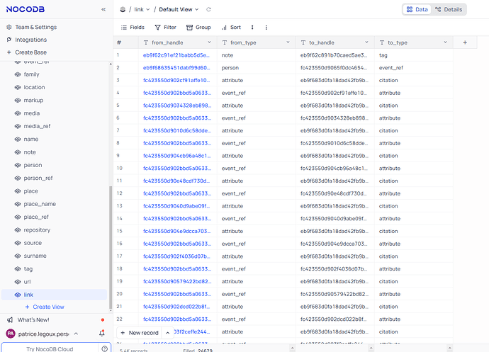

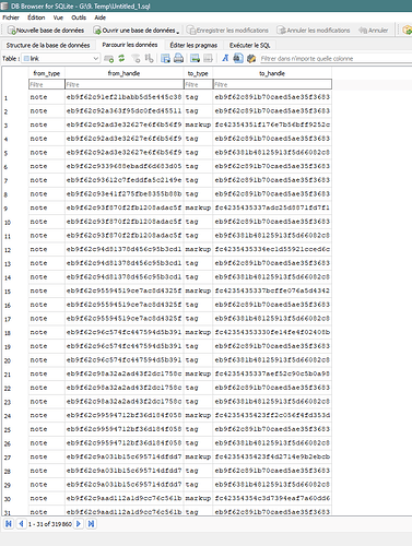

The following workflow read 5 json files from dropbox. They are backup data from a sqlite table:
As you can see that table is 320K raws.
I’ve splited data into four 13KB json files and they are loaded by the workflow using a Dropbox download node.
The workflow is designed to load all that data into a NocoDB database. But, in NocoDB, I only got 24K rows:

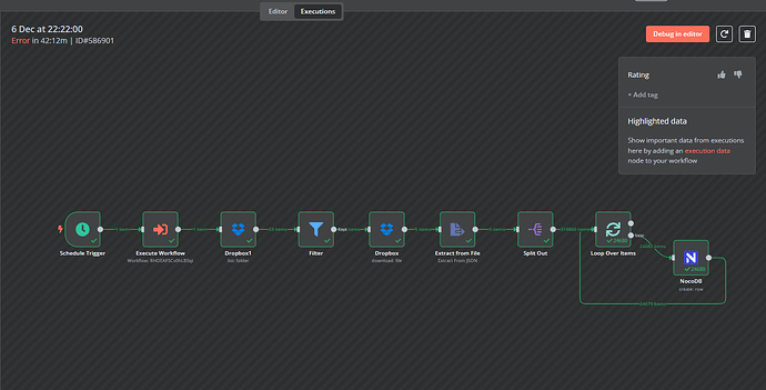

In the workflow itself, there is no error (unless its status):
But, in n8n log I’ve found this:

Hey @PLegoux
I suspect the instance ran out of memory, I would do the nocodb create in a sub workflow so that the memory is cleared on each loop so that you at not keeping all that data in memory.
