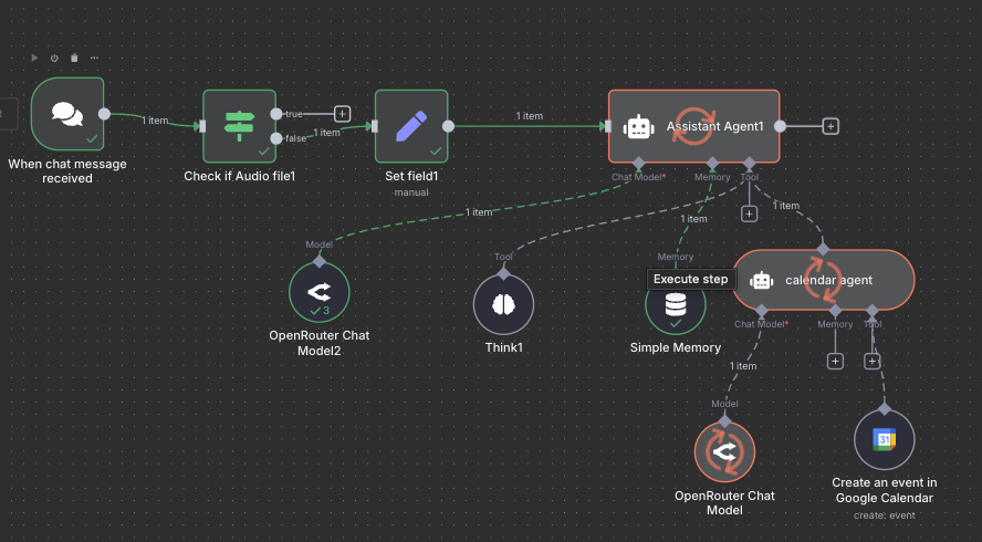

Hi everyone,
I’m experimenting with building a multi-agent setup in n8n. My base workflow works fine:
• Telegram Trigger → Main AI Agent → Reply to Telegram
This part runs perfectly – I can message the main agent through Telegram and get replies back.
The problem appears when I try to add a second AI Agent as a Tool for the main agent (for example, a “Calendar Agent” with Google Calendar nodes).
• Even if the secondary agent (AI Agent Tool) is not connected to the main agent, just having it in the workflow causes the execution to hang.
• When I run the workflow (Execute Workflow) and send a Telegram message, the execution never starts – it just spins on “Executing workflow” forever.
• If I remove the secondary AI Agent node, the workflow immediately works again.
Things I’ve already tried:
• Creating a brand-new secondary AI Agent with only minimal description/prompt
• Adding Google Calendar tools and also leaving the agent completely empty
• Using different LLM providers (OpenRouter with DeepSeek, etc.)
• Verifying Google Calendar credentials (tested directly with success)
So it doesn’t seem to be a credentials issue or a problem with the main AI Agent. It looks more like a bug in the AI Agent Tool itself.
Questions:
• Has anyone else experienced this behavior with AI Agent Tools?
• Is this a known bug or limitation in the current version of n8n?
• Are there specific configuration requirements for Agent Tools to avoid this?
• Is the best workaround currently to use “Call Another Workflow Tool” instead of embedding another AI Agent directly?
It feels very much like the AI Agent Tool node itself is causing the workflow to freeze, so I’d love to know if this is already on the team’s radar, or if anyone found a solution.
Thanks a lot :folded_hands:

Thanks now I think I finally find a problem in the editor it shows this: Error: Node cannot be used as a tool so the problem is probably in the AI agent tool. So what should I do next? Is there some solution for this problem or do I need to create different workflow as a calendar agent and let the main agent to just call that workflow?
I ran your workflow with a normal chat trigger node instead of the telegram node and had no issues. What’s the n8n version on your end?
Oh.. okey so the problem is in the telegram trigger?- and why the telegram trigger doesn’t work when the calendar agent is in the workflow? I am on on 1.111.0 so one version behind the latest.
I’m not sure if the telegram trigger is the issue, can you also test a normal chat trigger and check if it works or fails again?
I try it now with chat trigger and it still fails - nothing happens
Can you re-deploy the n8n instance on Railway?
Yes I redeploy it but the problem is still there :neutral_face:
And when I try it without the AI agent tool (calendar agent) its working with chat trigger so the problem is somewhere in the AI agent tool i guess :man_shrugging:
Can you share your version of n8n? I’m not sure if Railway is using the latest one. I would like to try and reproduce on that version.
Yes my version now is: 1.111.1
hi do you have some ideas how to solve the problem? Or I should give up and do multi agents workflows like in the past (call another wokflow instead of AI agent tool)
Hey, sorry I can’t really reproduce it on my end and I keep seeing issues in workflows running or behaving normally with Railway hosted instances, which is very weird.
Are you running n8n in Queue mode (main instance + workers)? Some people find the workers are not on the same version so they have to update them and redeploy resolve issues.
Hi thanks a lot :folded_hands: I redeploy the workers and now its running fine
