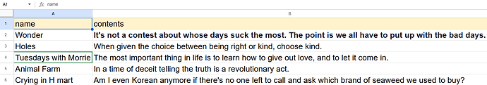

The workflow I want to create is to receive two book titles and quotes from a Google Sheet on Telegram every day. On the first day, I want to receive the first and second rows, on the second day, the third and fourth rows, and so on.
I tried asking ChatGPT, but I couldn’t find a clear solution, so I am posting here. I would really appreciate your help.

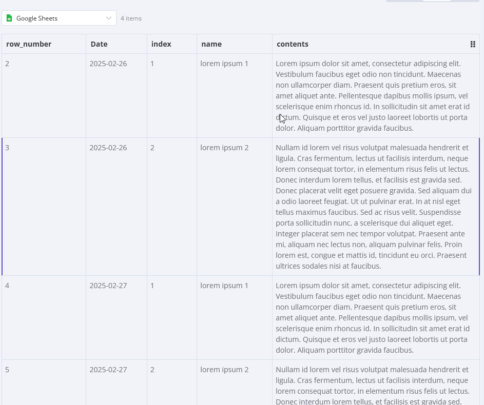

You might want to add two other columns in your google sheet with the the date of the posting in one column and an index to make sure your posting in the correct order.
Don’t forget to configure the date in the ISO 8601 format (YYYY-MM-DD)
In which the excel node will get the following :
Then in your code node, you can use the following :
const today = new Date().toISOString().split('T')[0]; // Get today's date in YYYY-MM-DD format
const results = $input.all()
  .filter(item => item.json["Date"] === today) // Filter for today's date
  .sort((a, b) => a.json["index"] - b.json["index"]) // Sort by index
  .map(item => ({ json: { name: item.json["name"], contents: item.json["contents"] } })); // Keep only name and contents
return results;
Which will output :
Tell me if that works out for you.

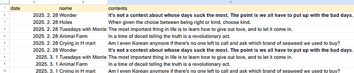

If I input six pieces of data on 02/28, I want to receive Telegram messages as follows:
  • Rows 1 and 2 on 02/28
  • Rows 3 and 4 on 03/01
  • Rows 5 and 6 on 03/02
Will the code you provided still work correctly even if the input date in the sheet is different from the date the message is sent via Telegram?
