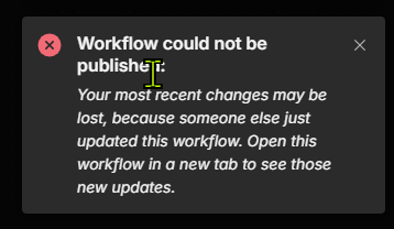

Additionally, I am receiving errors that someone else has modified the workflow (I am the only live human on the account).

i recieved this exact message multiple times. I had to refresh and the browser and then recomplete my most recent change.
