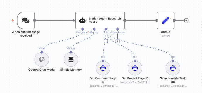

Hello together, I’m building a Notion integration in n8n and trying to filter tasks based on dynamic inputs. I have a “Search inside Task DB” HTTP node that should filter tasks by customer_id, project_id, or both – depending on the input.
Current Workflow:
In my setup, these values are dynamically retrieved from prior nodes (Get Customer Page ID and Get Project Page ID). However, I cannot guarantee that both values are always present. Sometimes only the customer or only the project is provided.
If both values are present, the filter works correctly and returns the expected results.
But if one value (e.g., project_id) is missing or empty, the filter still includes it – and the request fails with a 400 error. I want to dynamically omit missing filters and let the query run with only the available ones.
HTTP 400 – Bad request: please check your parameters
I’m using a Function node to construct the dynamic body like this (but the dynamic body doesn’t work yet):

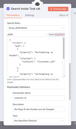

The only body that is working for me right now is this (with placeholders):
“filter”: {
“and”: [
“property”: “Verknüpfung zu Kunden”,
“relation”: {
“contains”: “{customer_id}”
“property”: “Verknüpfung zu Projekt”,
“relation”: {
“contains”: “{project_id}”
The http request for search inside the task database:
But here I only can use it when both values are provided.
If both IDs are present, the response is correct and filtered.
If either customer_id or project_id is missing (empty string or undefined), the request fails with HTTP 400 because I used placeholders.

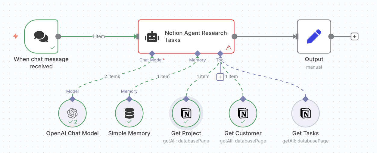

Hello. Thank you very much for your detailed workflow! I got your idea.
However, I tried to re-create this but I am getting errors.

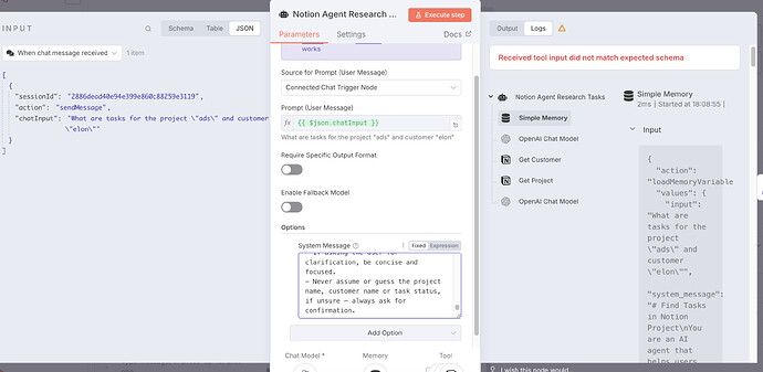

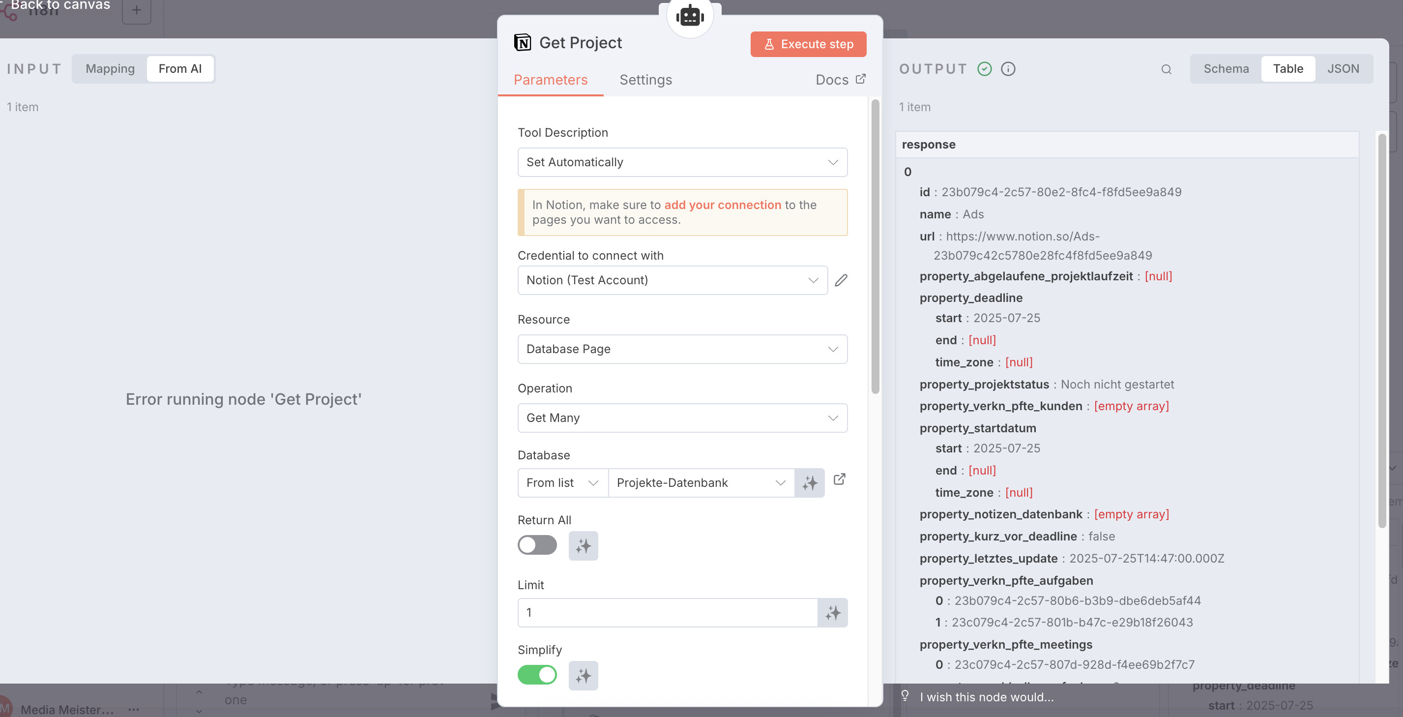

My workflow:

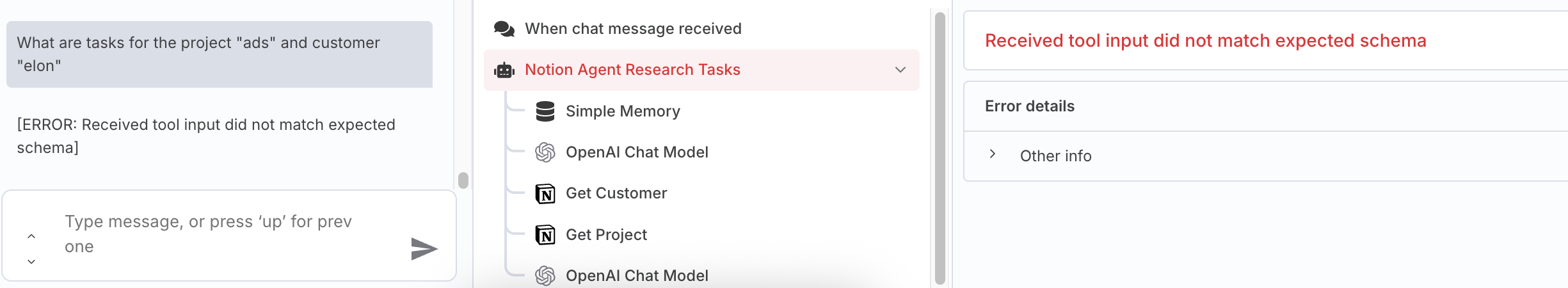

It is working that it retrieves the right customer and project id (I guess :D). At the right you see that it searches for project “Ads” and gets the right data.

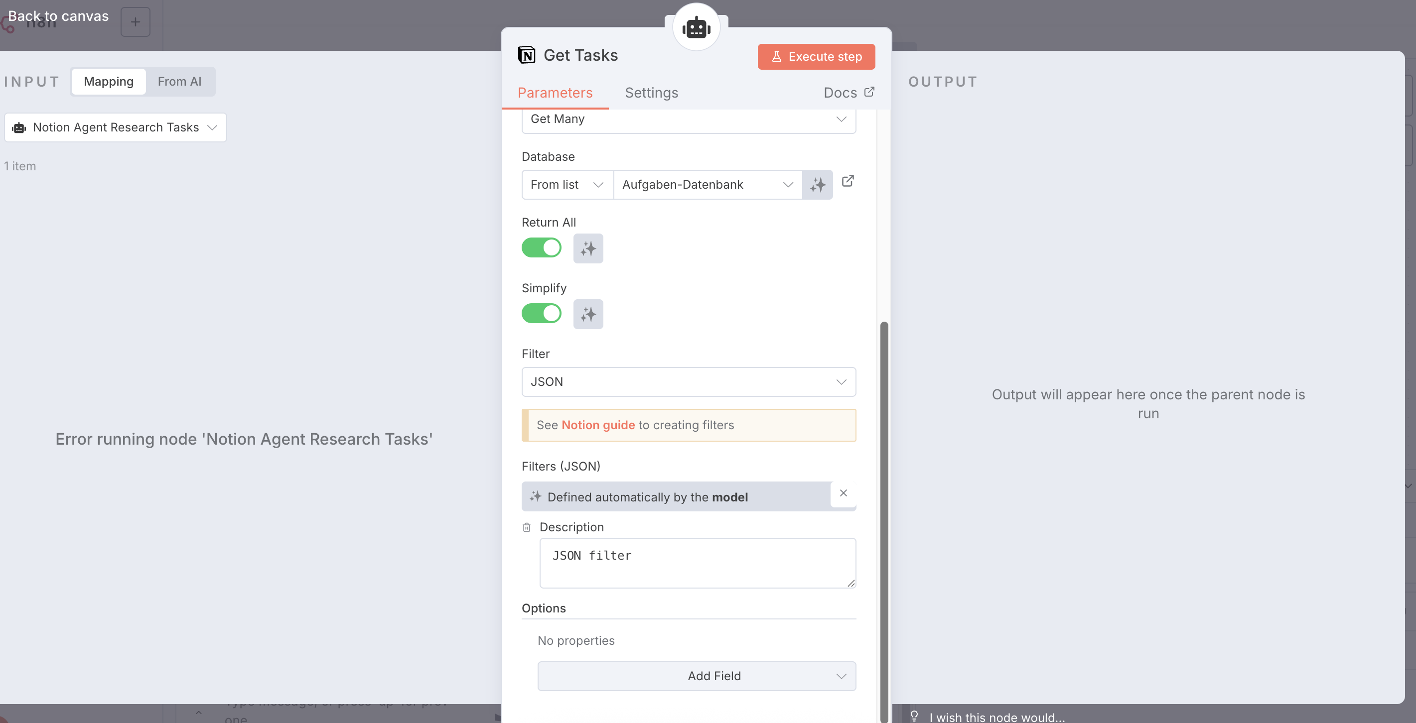

But still somehow it is not getting the tasks right.

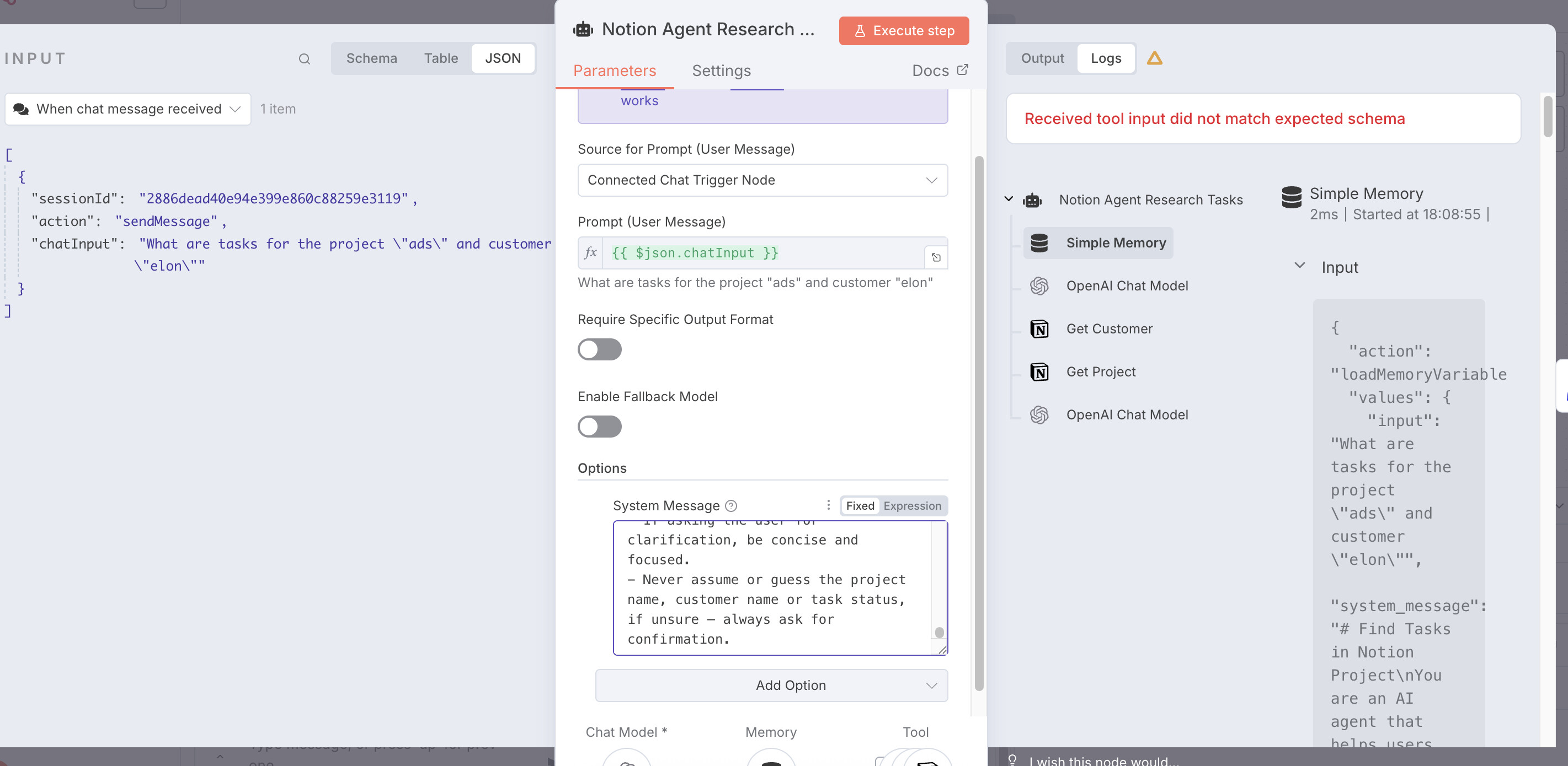

I think it is because of the prompting?
Here is my system prompt for my ai agent:

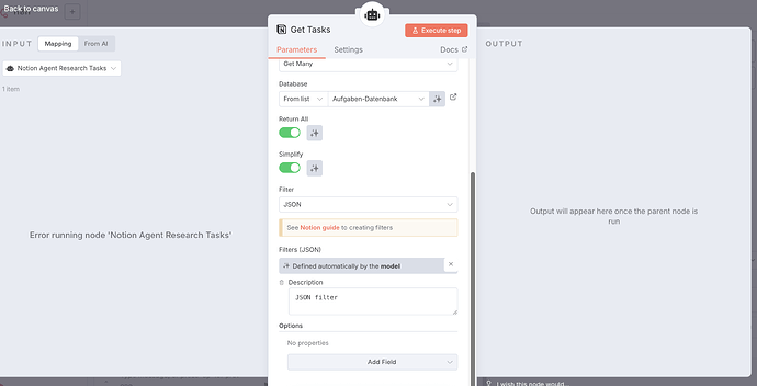

What do you think what is wrong at this case?
Here are more details of my settings:
I think I got it.
can you please check this prompt if you can find any errors or issues that can result into errors? appreciate it!

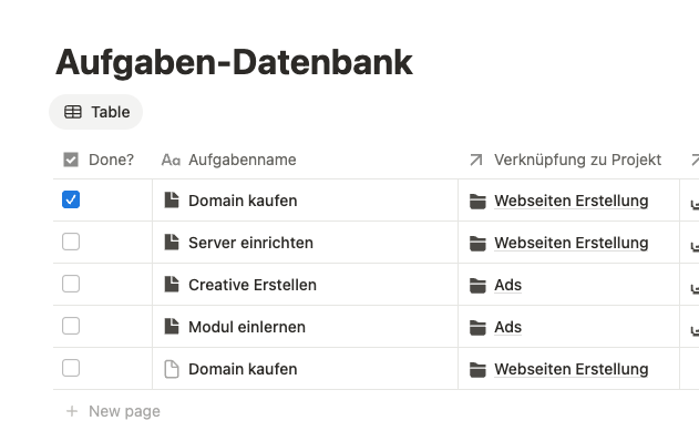

How can I add the requirement to check if a task is done or not?
I have a checkbox and I would like to filter for it too. What do I need to adjust on the code to also filter for done tasks if I ask in the initial message for it?
See on the left (that is my database property):

Essentially, you would need to add and populate an additional property checker in the filter:
// include this if ...
{"property": "Done?", "checkbox": {"equals": true}}
and in the prompt you instruct the agent to add this is requested by the user.
