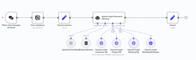

this is my workflow

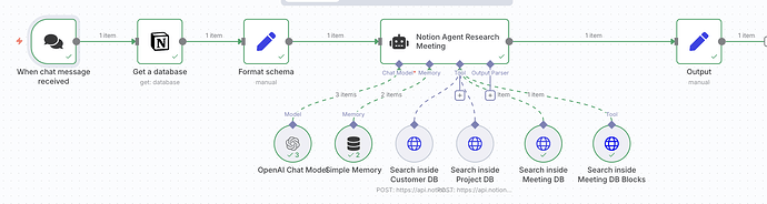

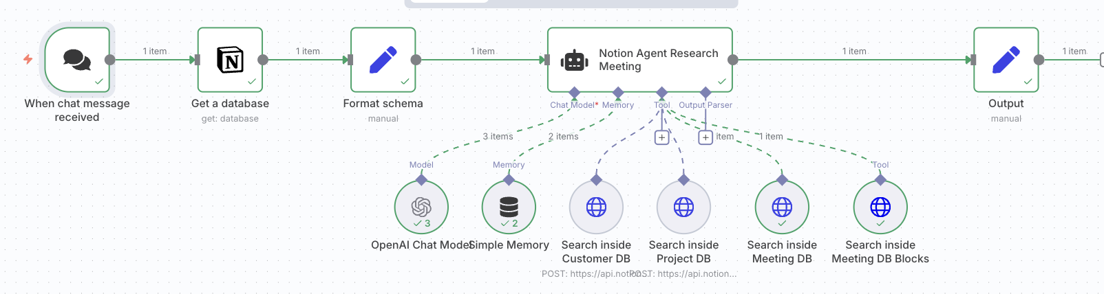

Ok, that’s too much to translate, I will do this on my own database. Below is my attempt at solving this:

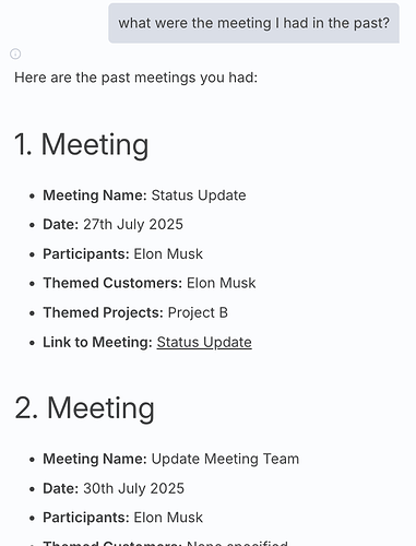

Here is my chat with the agent:
All dates are correct based on my database so are the summaries.
