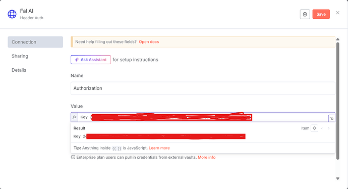

I did it like that:
and the POST URL to: https://queue.fal.run/fal-ai/ffmpeg-api/compose

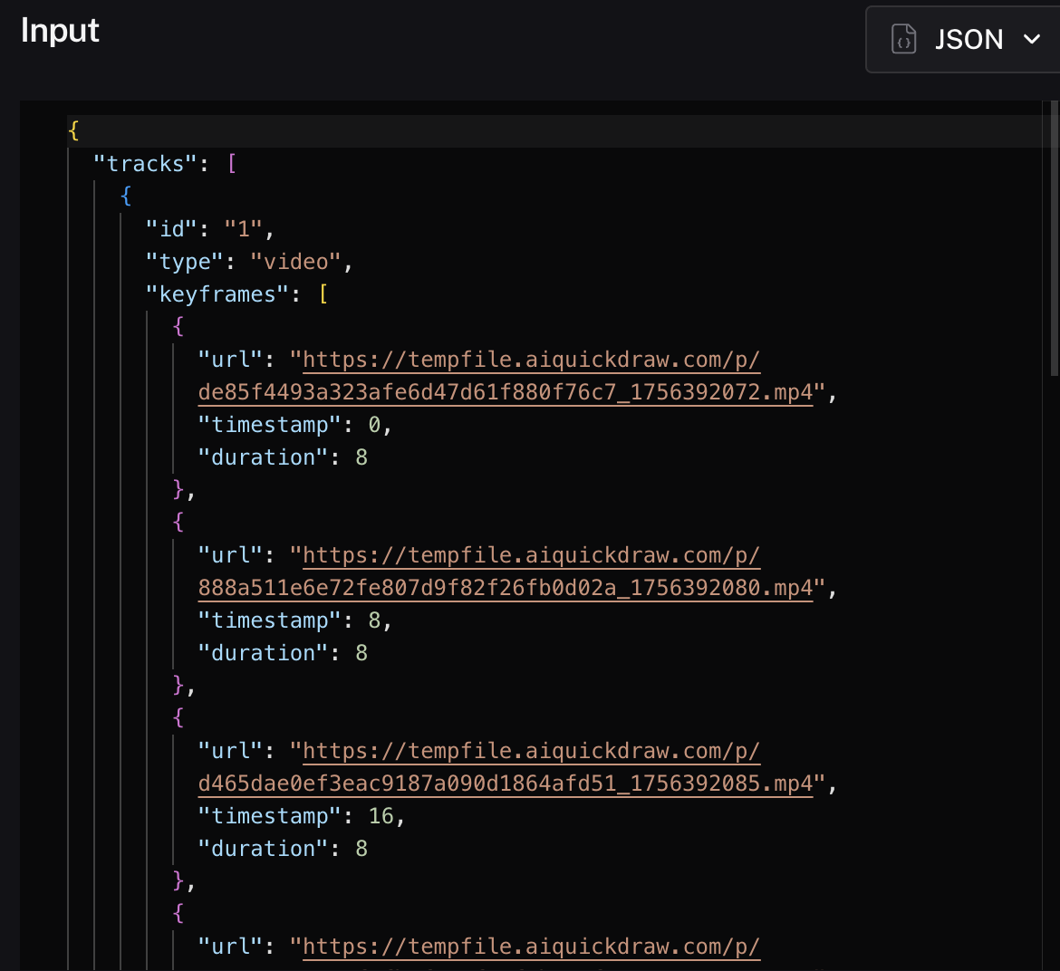

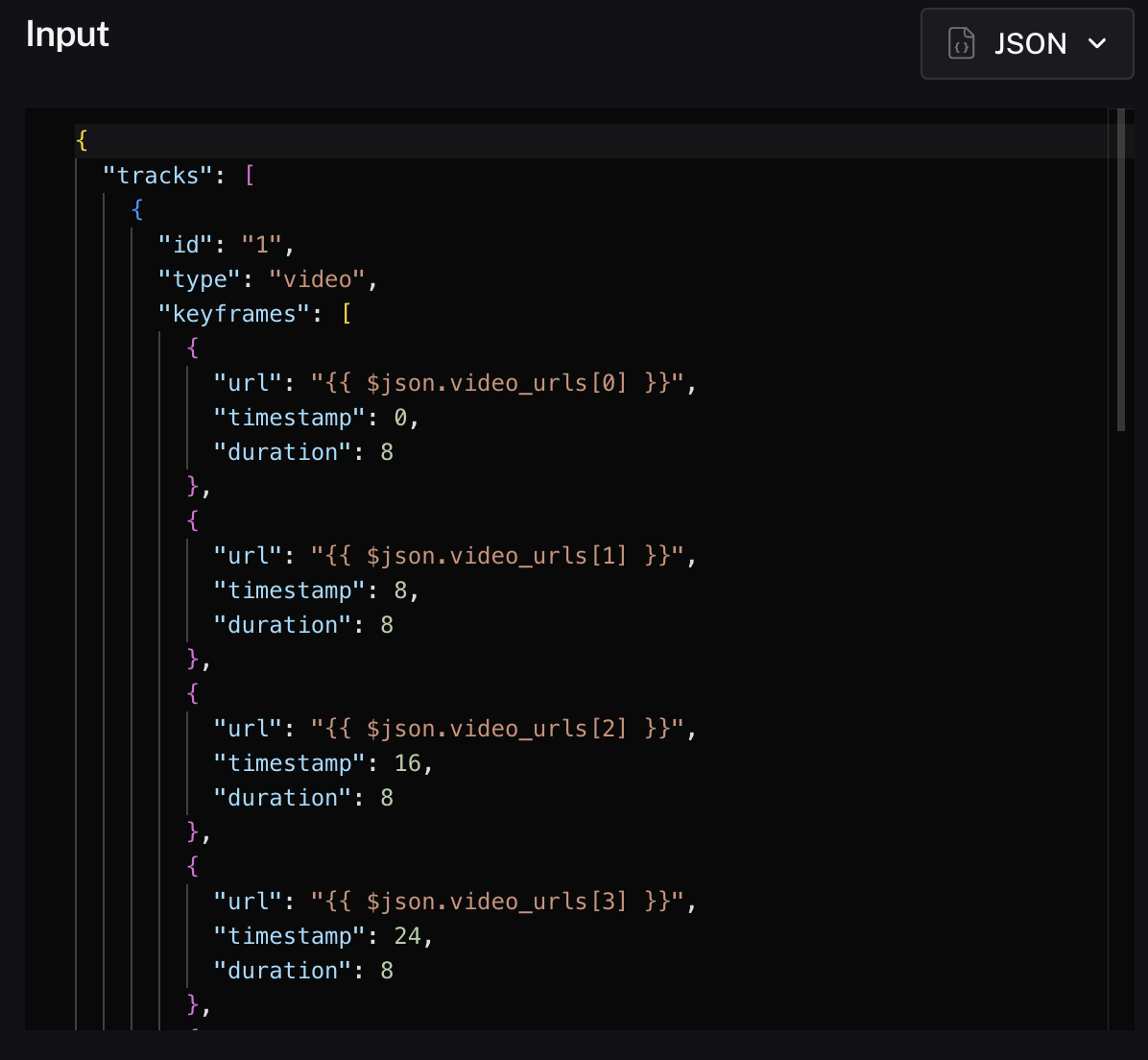

I’ve had the same problem, when I check fal.ai requests I saw that body of the request wasn’t right. You need to ensure that u use “expression” not the raw json.
It’s how it should be
this is wrong body, if u dont use expression
