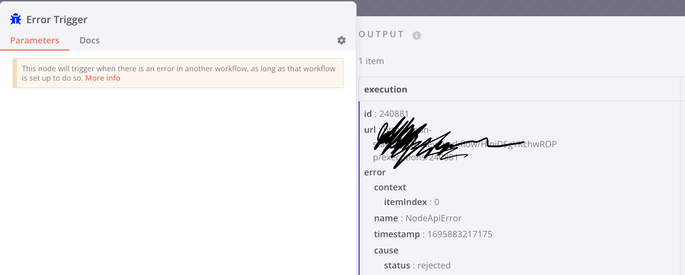

For question1,
error node, is giving this response.
Now, how I can handle this with {{ DateTime.fromMillis($input.item.json.timestamp).toISO(); }}
Hi @Gouravdev
in the next node you can switch the parameter where you want to use that date to Expression and then input:
{{ DateTime.fromMillis($json.execution.error.timestamp).toISO() }}

hi @Gouravdev
for the 1st question, you can also use more simple syntax:
{{ new Date($json.execution.error.timestamp).toISOString() }}
